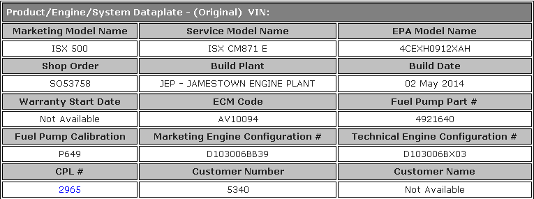

OzK108
[attachment=7335]
chasing any relevant changes that can be made and certainly any advice anyonje could give. TIA
(12-12-2020 )OzK108 Wrote: [ -> ]chasing any relevant changes that can be made and certainly any advice anyonje could give. TIA
If you want to know if an alternate program besides the AV10094 is compatible, let me know what program you want me to compare it to and I will tell you what the differences are.
