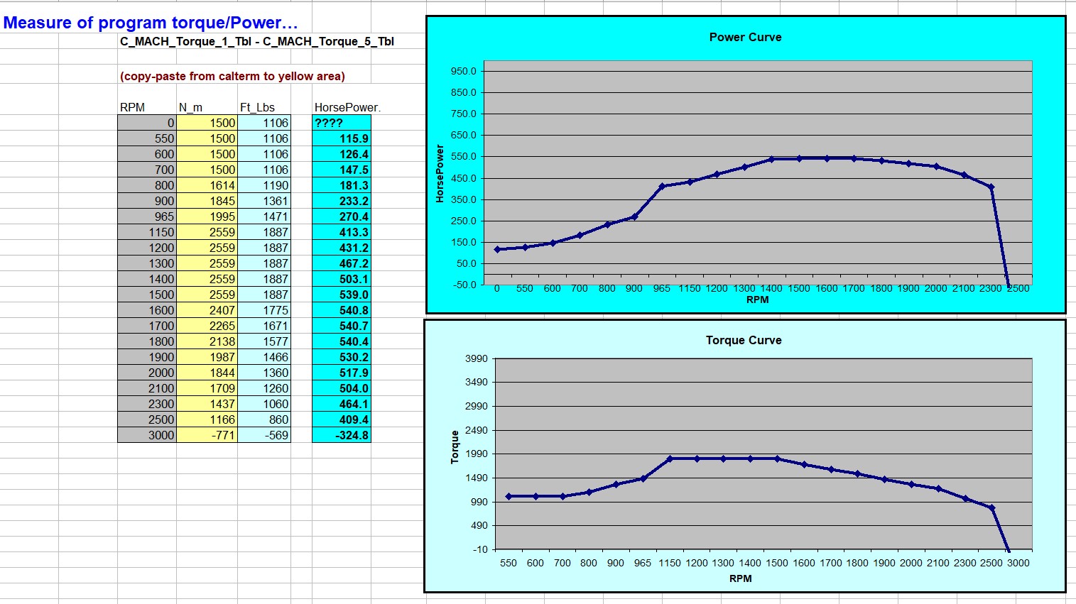

Not sure what your getting at there. Here is the power curve for program AV10094 ...
[attachment=7650]
(right click and choose "view image" if you want to see a bigger version of the pic).
* It is essentially 540HP from 1500 rpm all the way to 1900 rpm. It shows a peak of 540.8 HP at 1600 rpm.
* It also shows 1887 ft-lbs torque from 1100 - 1500 rpm. (1850 @ 1100 - 1400 rpm is quite hard on the ISX though and will shorten its life if driven there under high loads very much).
Also, why would you have to rebuild an engine every 250k miles or so?. I know you mentioned Aussie road-train weights, but even still,.. this is way too often. Should be more like 650 - 800km if the engine is well cared for, driven correctly, (and programmed correctly if the egr has been switched off).
- Is this engine egr-deleted?. if so then u might want to send (e-mail) a copy of the program to me for inspection/review. See what is in there that could be shortening its lifespan by so much.

(07-26-2021 )alamow Wrote: [ -> ]Is AV10083 compatible with AV10094?
Program AV10083 and AV10094 are 100% compatible with each other.
(actual settings)...
They both have the same torque settings (1880 torque) and power curve until 1600 RPM. After that ...
* The AV10094 has 541Hp @ 1600, then falls off slightly as RPM goes up further.
* The AV10083 has 575Hp @ 1600, and crests at 590HP @ 1800. It then falls off slightly as RPM goes up further.
