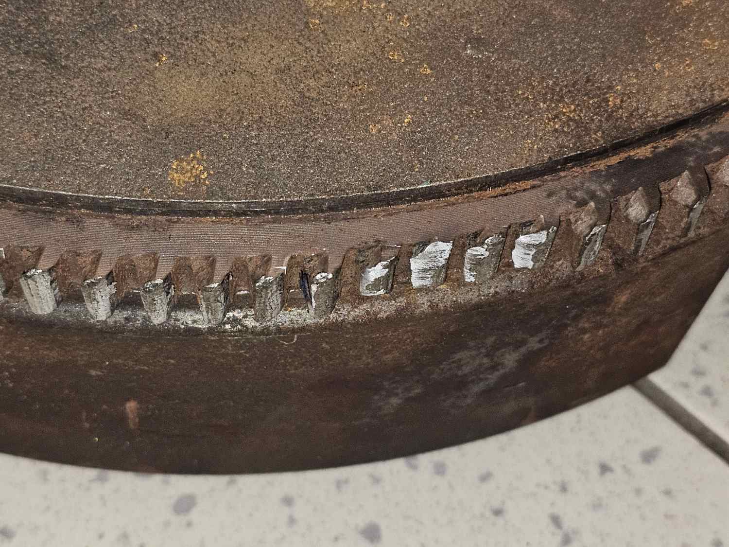

While the engine was apart I decided to replace ring gear with deere certified alternative part. The starter motor was replaced by previous owner with mahle part not too long ago. Well on my part I made mistake too - did not verify ring gear and starter gear mesh with the engine off and stater bolted on and just cranking everything by hand. I did check old vs new ring gear on top of each other to make sure that teeth count is the same, well it was and the old starter was working some time before just fine since the starter gear did not look anything suspicious.

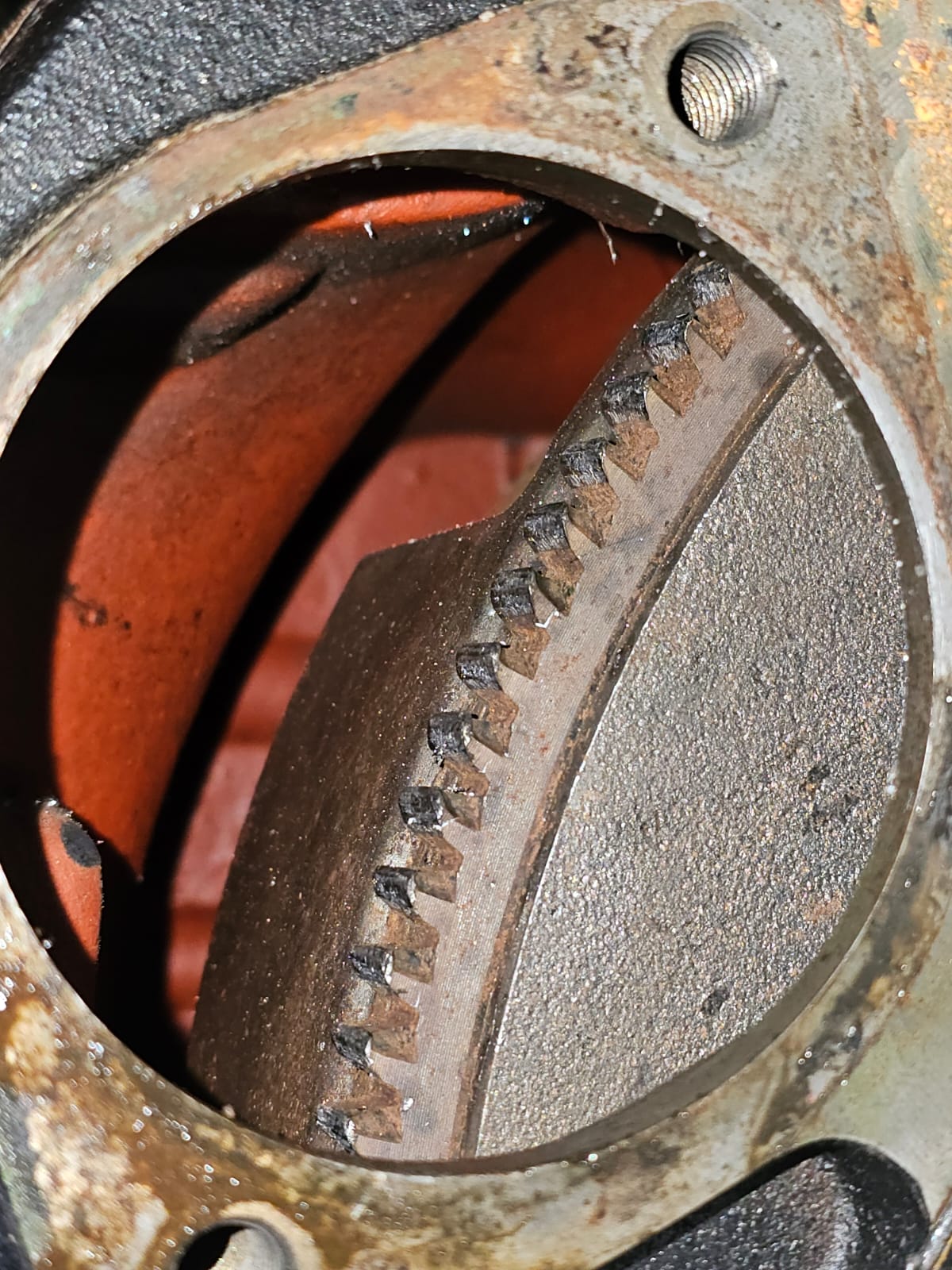

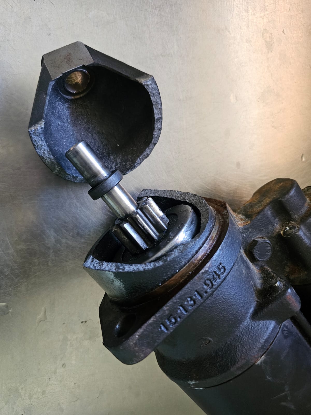

Well I got too carried out and made a big mistake by not checking rail pressure with scan tool. But still screwed in glow plugs and cranked over engine. 20-30 seconds and clunk was heard like something gave up in the engine. Turned over engine by hand, everything feels okay. Tried to crank again, seemed to crank ok for few seconds and then made some bad noise like starter gear slipping.
Had no other option than to pull the starter and inspect - an hours job, need to support engine from underneath and remove one side engine mount rail, lots of brackets, crank breather assembly. And still starter bolts are still super hard to get.
Here I have attached pictures of what was making the clunk and how good the ring gear looks like. Keep in mind the starter gear and ring gear tooth count and type is correct!

What is the proper thing here to do - NEW starter and NEW ring gear this time original deere part that costs 2.5 times more than their certified alternative (brand owned by themselves). What I am going to do - replace the starter nose cone assembly for sure and then replace the ring gear with deere part. It means engine off and least a day of work.
I have made mistake in the past on 5.9 cummins where I put a wrong starter on it (from benz truck) since original one was nowhere to be found in my area and aftermarket no name china special ones did not last more than few starts before cracking the shaft or starter gear getting stripped. Well that wrong starter gear had too many tooth, when the starter bolts were left loose the engine started and after few months the ring gear and starter gear grinded to a match that worked for couple of years when again starter needed new gear and nose cone bushing. Genuine Bosch starter gear did that, no name china ones maybe managed to start once before those gears started freewheeling or just completely stripped. That saga lasted until ten years until finally pulled engine, replaced ring gear and found out that the starter gear was wrong. Finding bosch starter or just the gear around here is almost impossible so this time aftermarket china brand starter gear has been there working for 1.5 years already.
