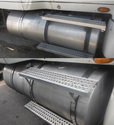

On my former truck, an '09 ProStar, I had at least 3, maybe 4 straps break. I eventually replaced them all with stainless.
[attachment=8765]
The top of that picture shows that the rear strap is already stainless, because the steel one had already broken.
Jump forward to this trip, I now have a '15 ProStar and Navistar didn't correct this problem. I just had a strap break on me. It's not just trucks with side skirts, this one never had skirts. It's any ProStar that has black painted steel straps.
