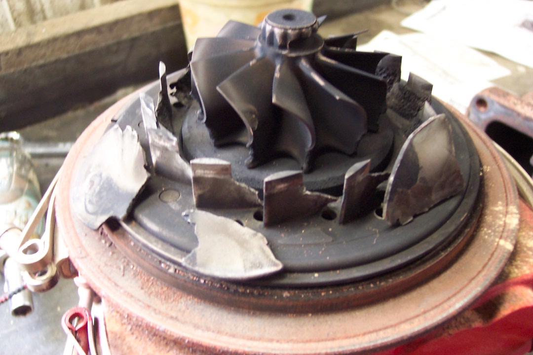

[attachment=2541][attachment=2540]Well I got the VGT unstuck once I cleaned out all the broken veins. I can't believe this made 36 psi boost at only 4% position.

3) What the hell went through it? Wow!
Some kind of debris went through that turbocharger.
(02-28-2017 )Rawze Wrote: [ -> ]Some kind of debris went through that turbocharger.
Agreed, those three loose pieces in the pic DO NOT belong...pretty sure I know what happened there. Ain't no warranty with that I'm sorry to say.
Looks like you need to buy a new turbo and get yourself a solid blanking plate. Been there & done that.
So that is what happened.
Bad parts are everywhere on the internet from people trying to make a quick buck. They only exist for making some a$$hole rich from desperate truckers.
From the hints and pics it looks just like someone installed a cheaply made block-off plate in the exhaust before the egr cooler. Seen that before. Most cheap ones will not hold up long and more expensive ones will not last too.
Ppl install stuff like that and then completely forget about it after. Maybe few months or year or two or maybe even 5 years later they fail and brake something with it. Some good quality is needed.
good thick solid 304stainless. Anything less you are getting into trouble. This is the only thing I see that holds up.

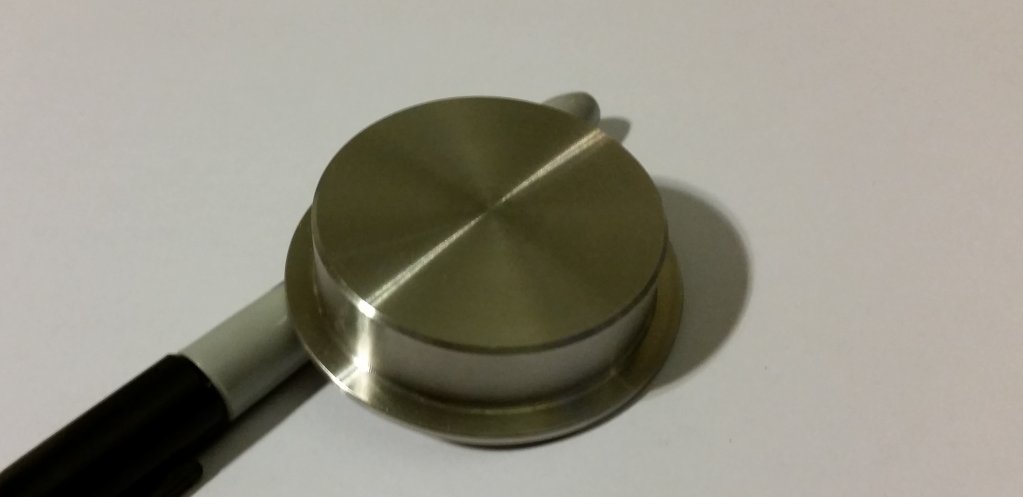

[attachment=2544]
gotta make sure press can't build in any dead pipes that may have been block at both ends too. heat expansion in dead pipes can break a lot of things. Best to remove gaskets in dead pipe channel.
