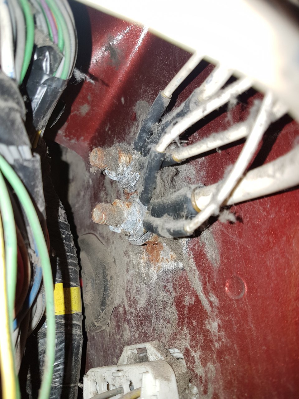

[attachment=3853]
On the inside of the cab, those 2 posts..... I cleaned them up real good and trucks been running perfect for over a hour now. I don't wanna count my blessings but it's looking promising.
