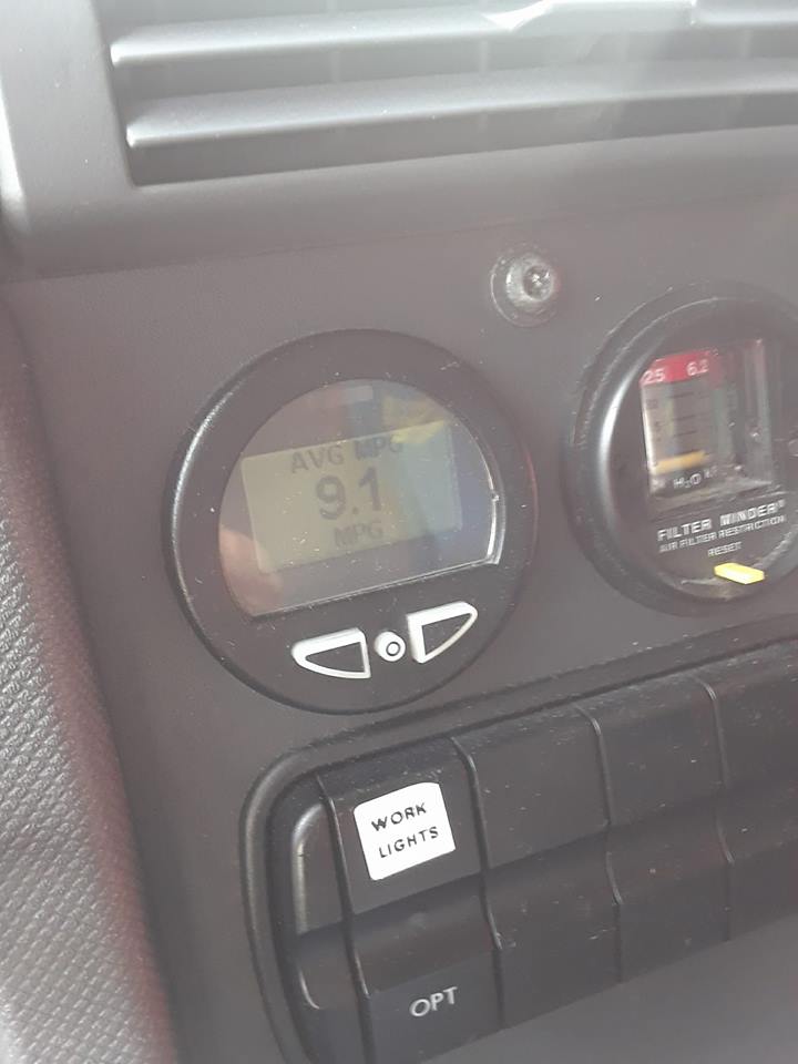

All I did was change the EGR Delta-P and the IMAP sensors. This trip is from Tuscaloosa, AL thru Talladega Mountains on I 20, thru Atlanta with delivery in Dublin, GA. Returning empty (usually the case) against a 10 mph headwind. Speed was not a factor due to all the mountains and hills but I kept it as close to 55 mph as much as I could.

Impressive.
(05-09-2018 )Rawze Wrote: [ -> ]Impressive.
Wish I had an aero truck so I could see those kind of numbers...
[attachment=3920]
Must be the Wide Hood catchin all the air...lmao
Seriously, that's impressive!
