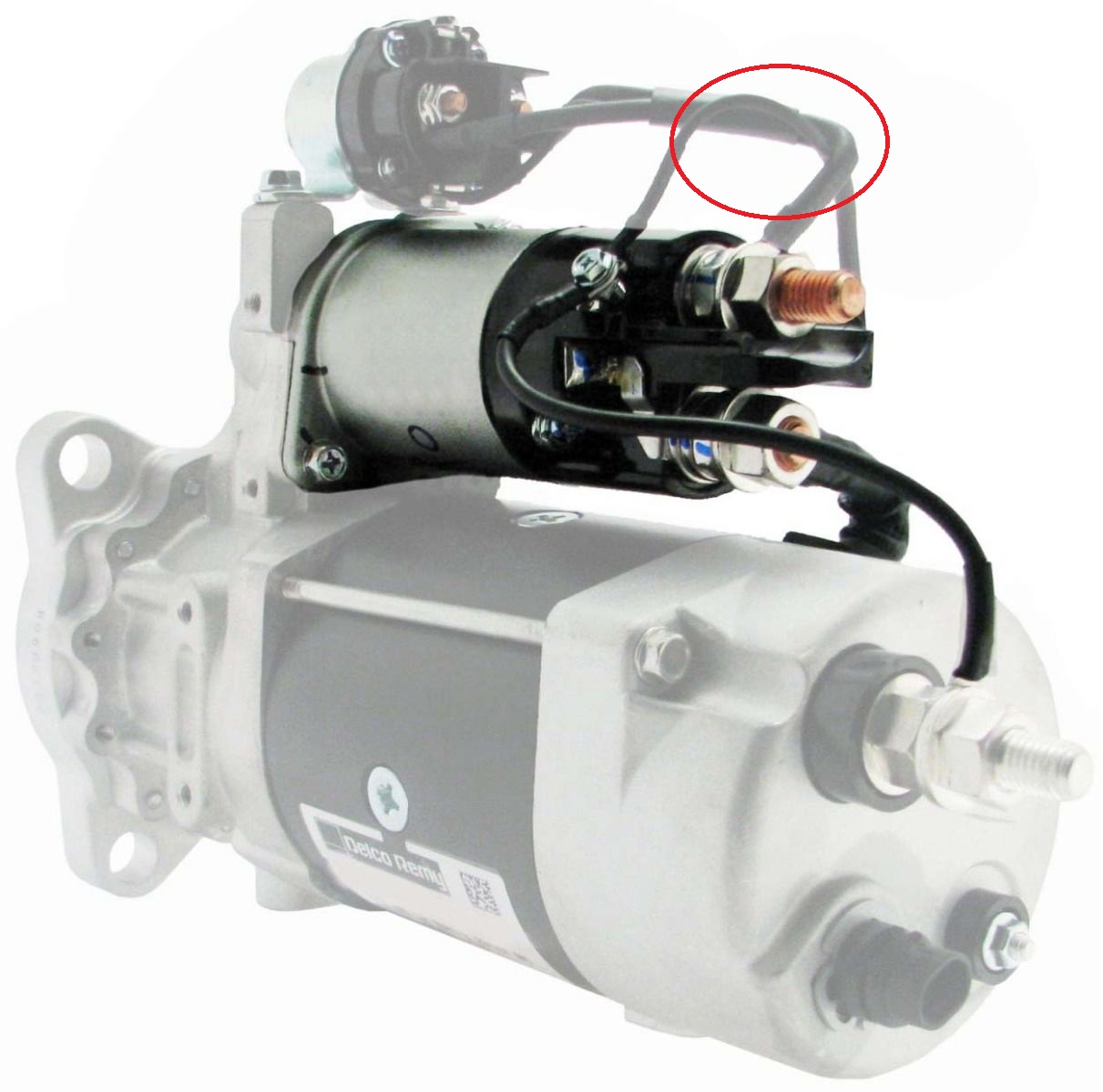

I had it and my friend had.
Both was short wires from starter relay [attachment=4133]
