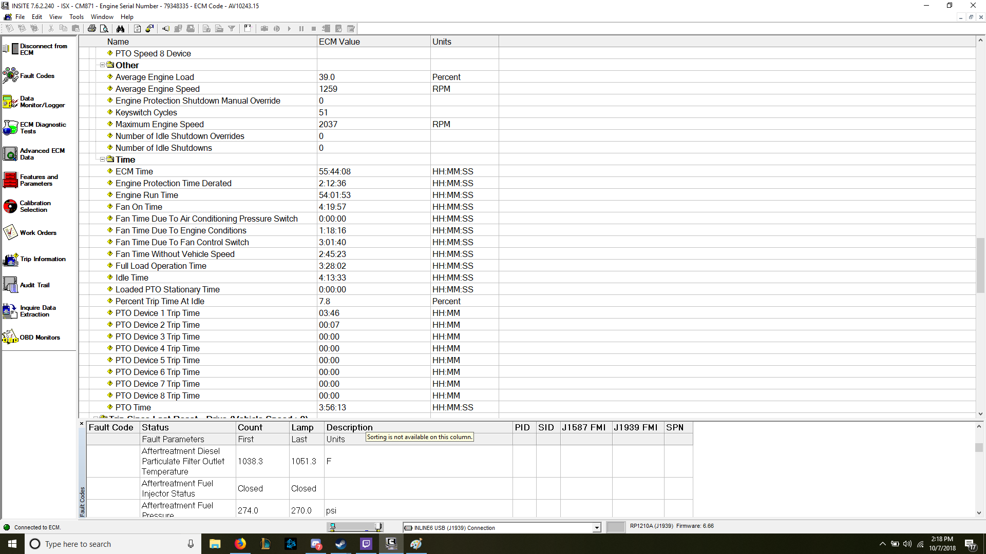

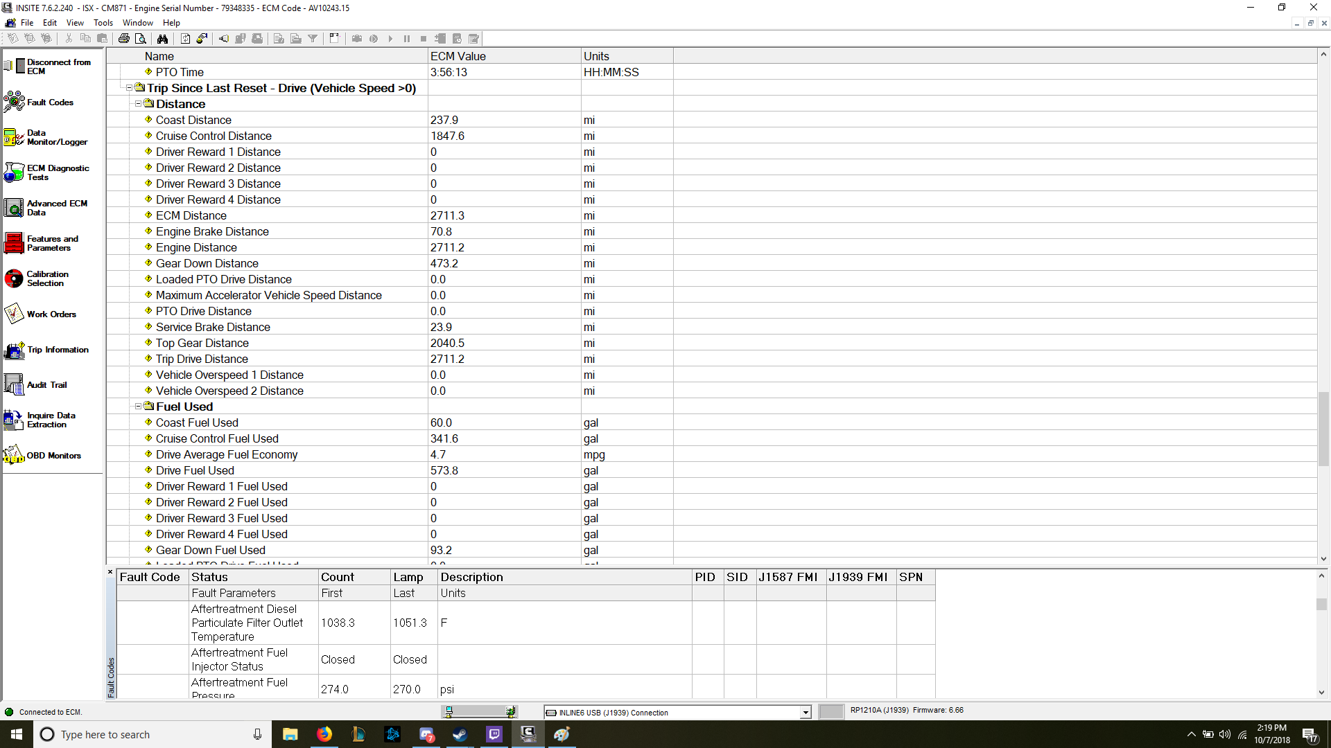

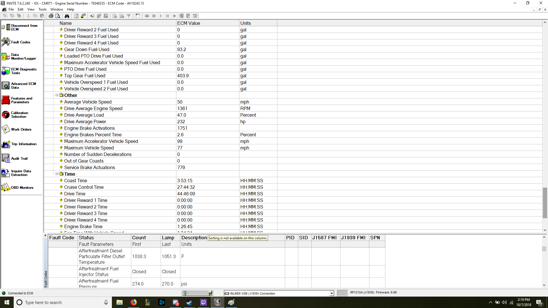

Some info i think is weird

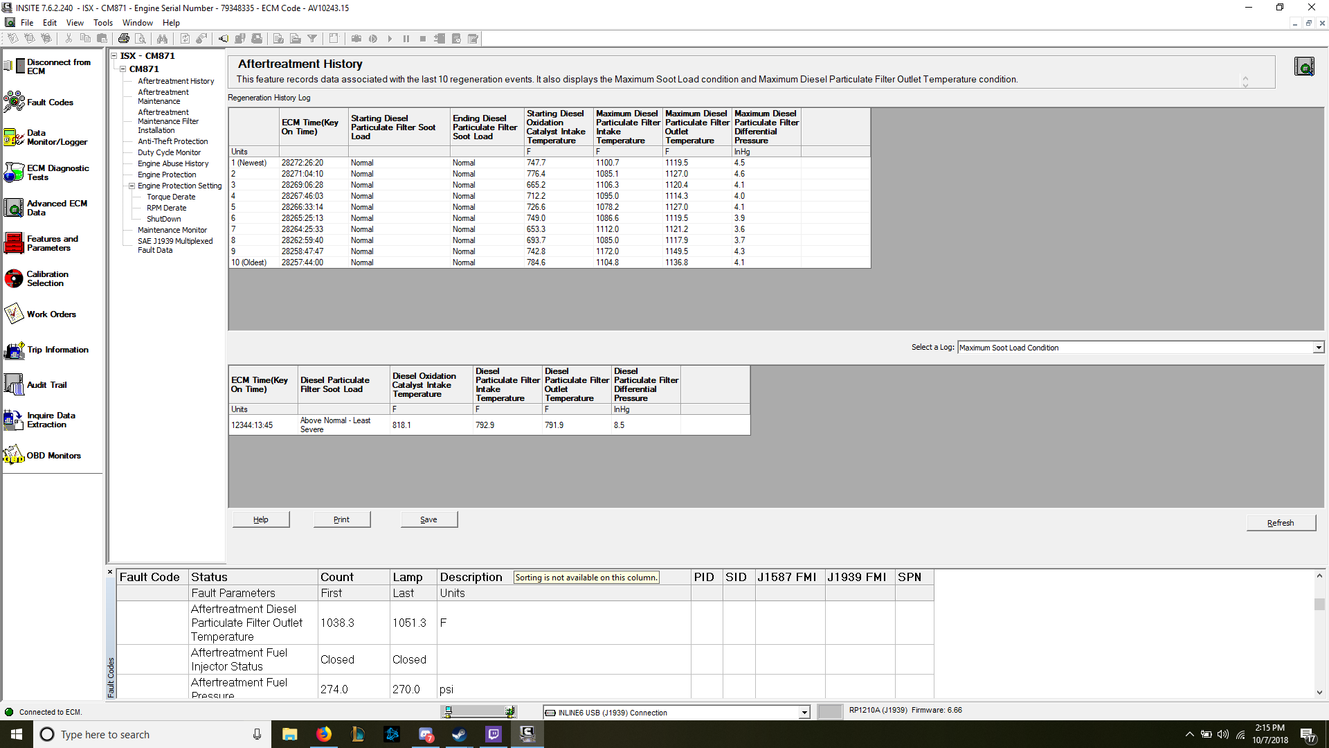

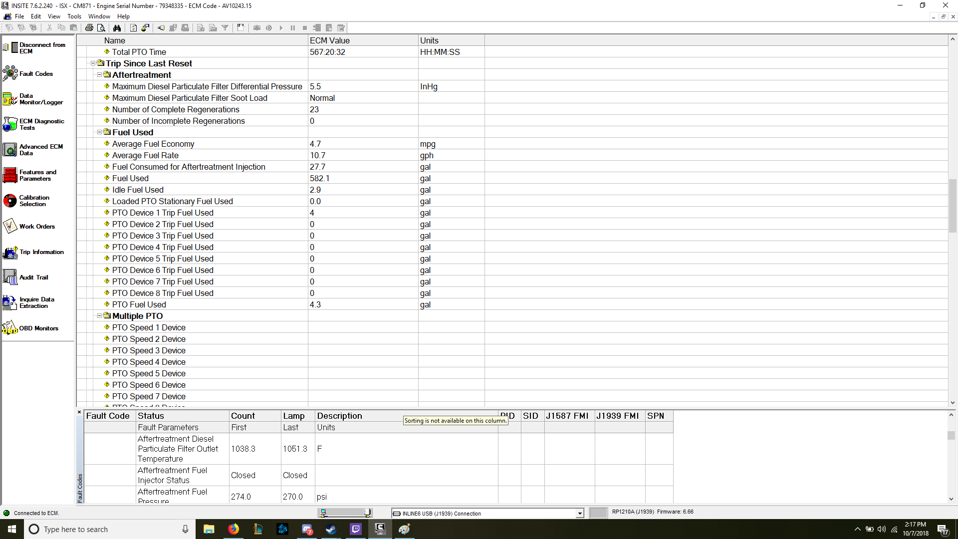

2700miles - 23 completed regenerations
last 3 regens almost 1hr apart each
have a DOC Face Plugged code found in insite
[attachment=4296][attachment=4297][attachment=4298][attachment=4299][attachment=4300]
Your filter is full. Pull it and the doc and have it cleaned abd flow tested
Yes, it is high and plugged. Pull the, DOC and DPF and take pictures of them,.. post them here for some opinions, have them baked and flow tested. You should not average more than 3.0 down the for right column in the history report.
