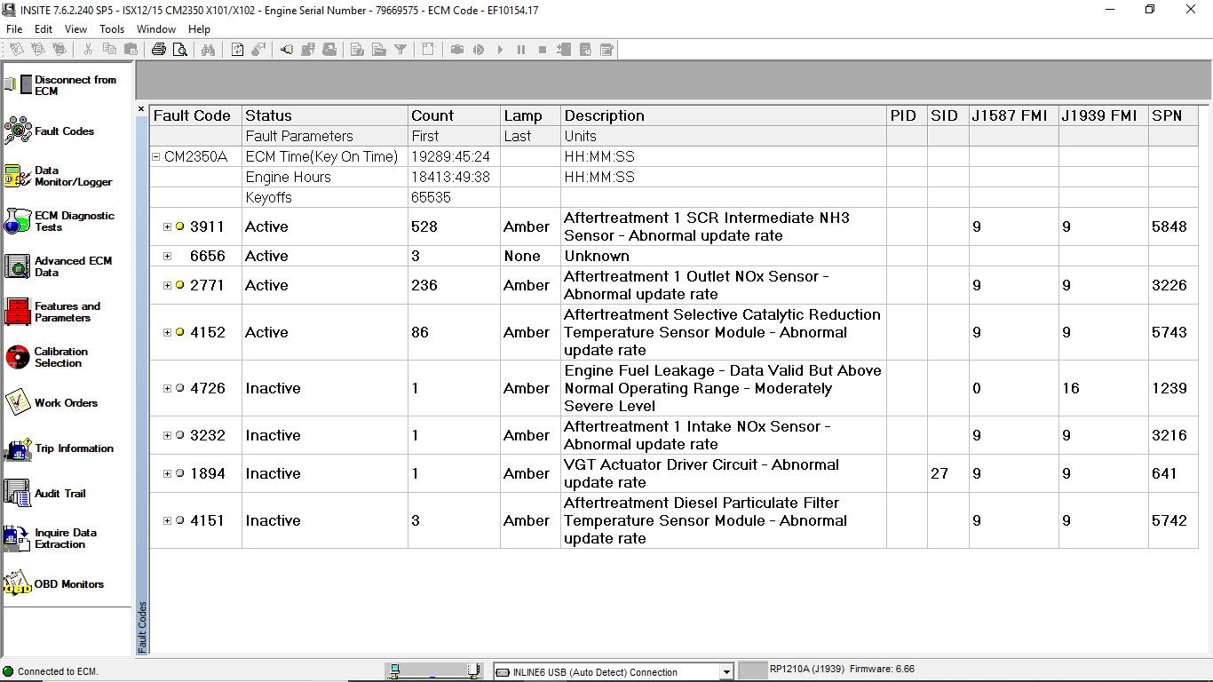

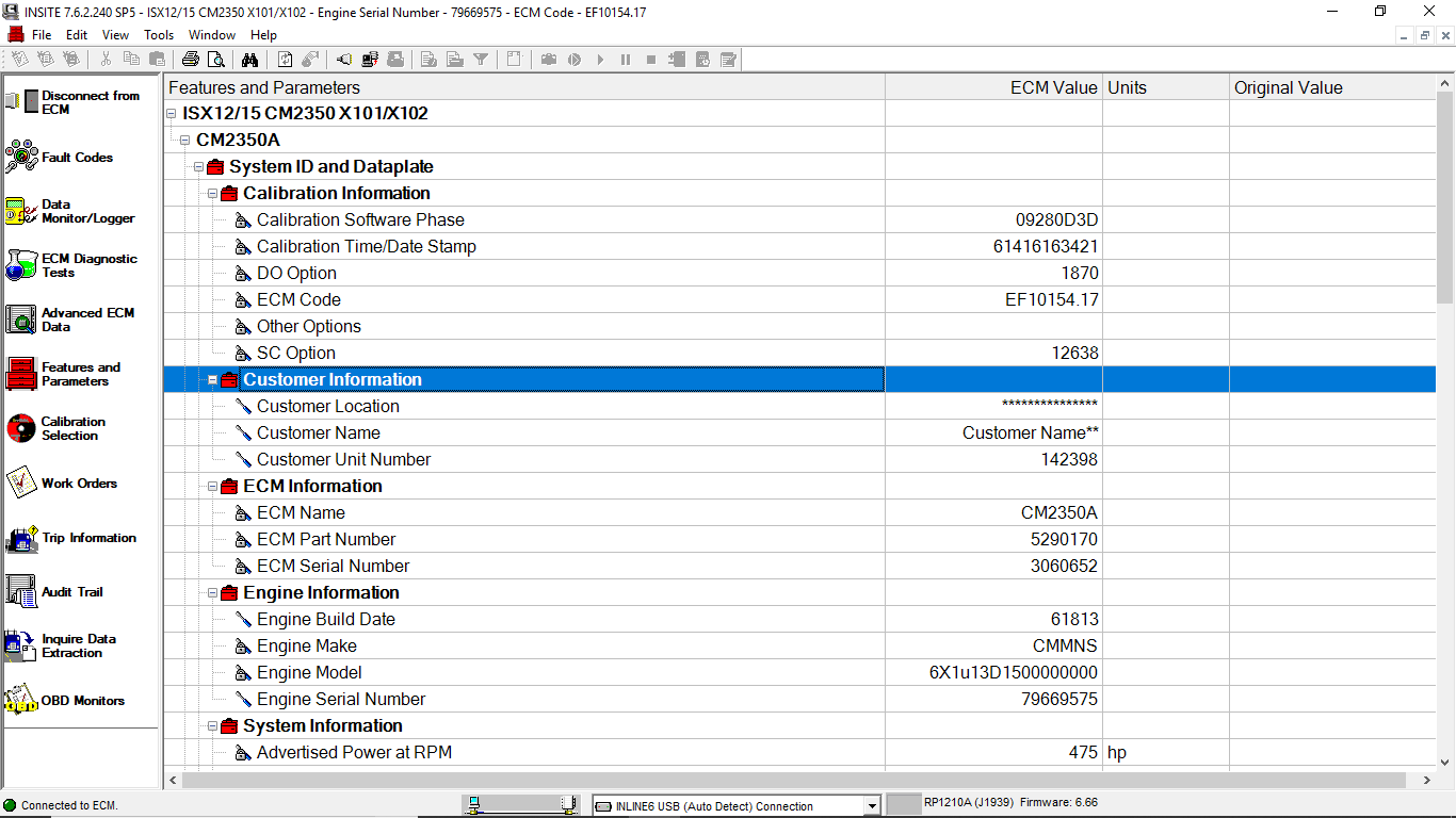

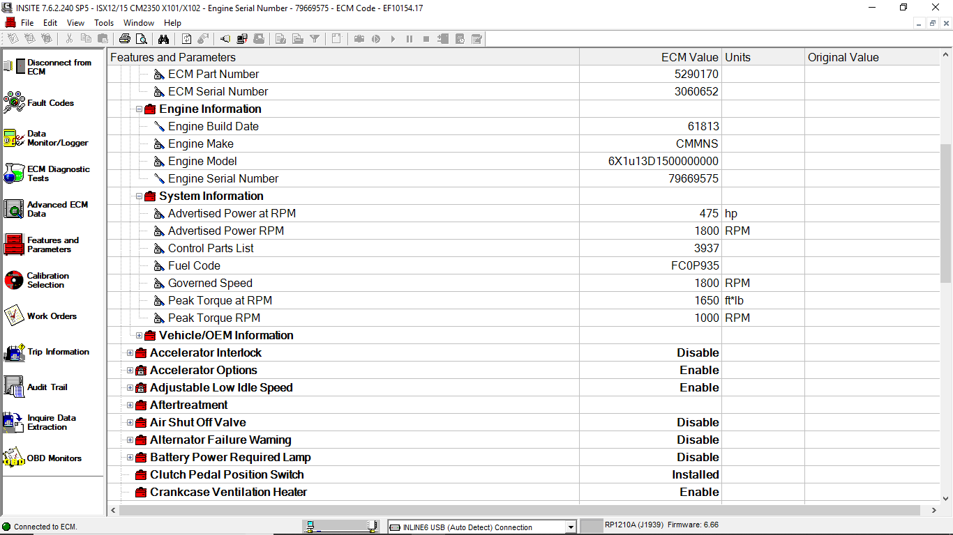

Last week I had enough, and decided to finally take my career serious. I read up and found this place. I picked up insite 7.6.2 and started poking around for myself. i notice that my dataplate on Quickserve doesn't match up with my dataplate on Insite. My engine, and quickserve show 400hp, ECM code EF10049. Insite is showing 475hp and EF10154.17.
4152,4151, and 3232 are the codes I've been getting for 9 months. The others are new arrivals. The truck has only asked for a regen twice in the 9 months and 120000 miles that I've owned it.

[attachment=4686][attachment=4687][attachment=4688]

A compare of the 2 programs 18,000+ settings against each other. The EF10049 and the EF10154 programs are 100% compatible with each other. Literally the only differences between them is the HP, torque, and the fact that the EF10154 program has smart torque disabled. - Using one for the other will not cause any emissions issues. You can safely rule out the programming as a cause.
