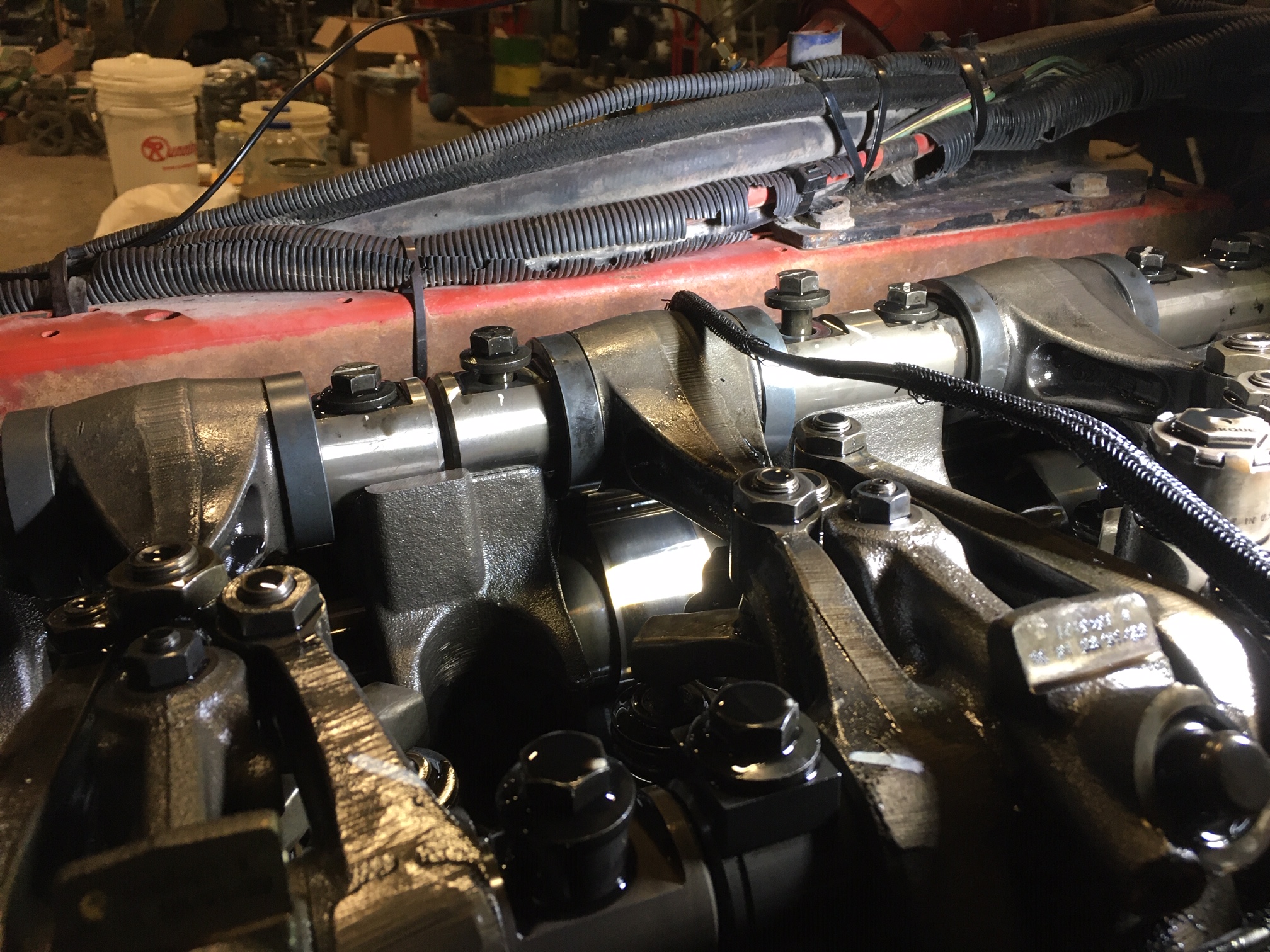

Hope I post this in right place and image works. After reading a lot of info on this great forum I decided to pull the valve cover on one of our trucks to inspect the cams and adjust the valves.
Found two bolts completely loose and backed out that hold the injector rocker shaft for cylinders 1-3. Try to make a long story short we bought this truck used (in 2014?) with about 400k miles its a 2005 pete 379 with a cm870. After running it a year i think it was (we only put about 5k a year on our trucks) we had the truck inframed at a local private owned repair shop. It cost us a fortune and i wish i had done the inframe myself but didnt have the confidence back then. Anyways after seeing these loose bolts (this is the first its been opened up since inframe) i wonder what else is fubared in this thing. I know i need to replace the jake harness as the woven loom is deteriorating along with the exterior engine harness loom.

well thats scary.
should send the pic to the shop that did this botch job.
You can also take the knowledge from quickserve and from watching all of Rawze's inframe video's and go have a conversation with the actual tech that did the overhaul. Most shops will let you talk to a tech about the work they performed. Just a casual conversation where you pepper in questions like liner protrusion, torque spec on various things (head bolts, rockers, valve cover bolts, manifold and turbo bolts) what kind of loctite did they use on the cam gears, do they use OEM or aftermarketparts? Their answers will tell you everything you need to know about how the engine was put together.
Looks like he didn't have enough time for the plus 60deg but had time for the 'anti-liability paint marks' lol

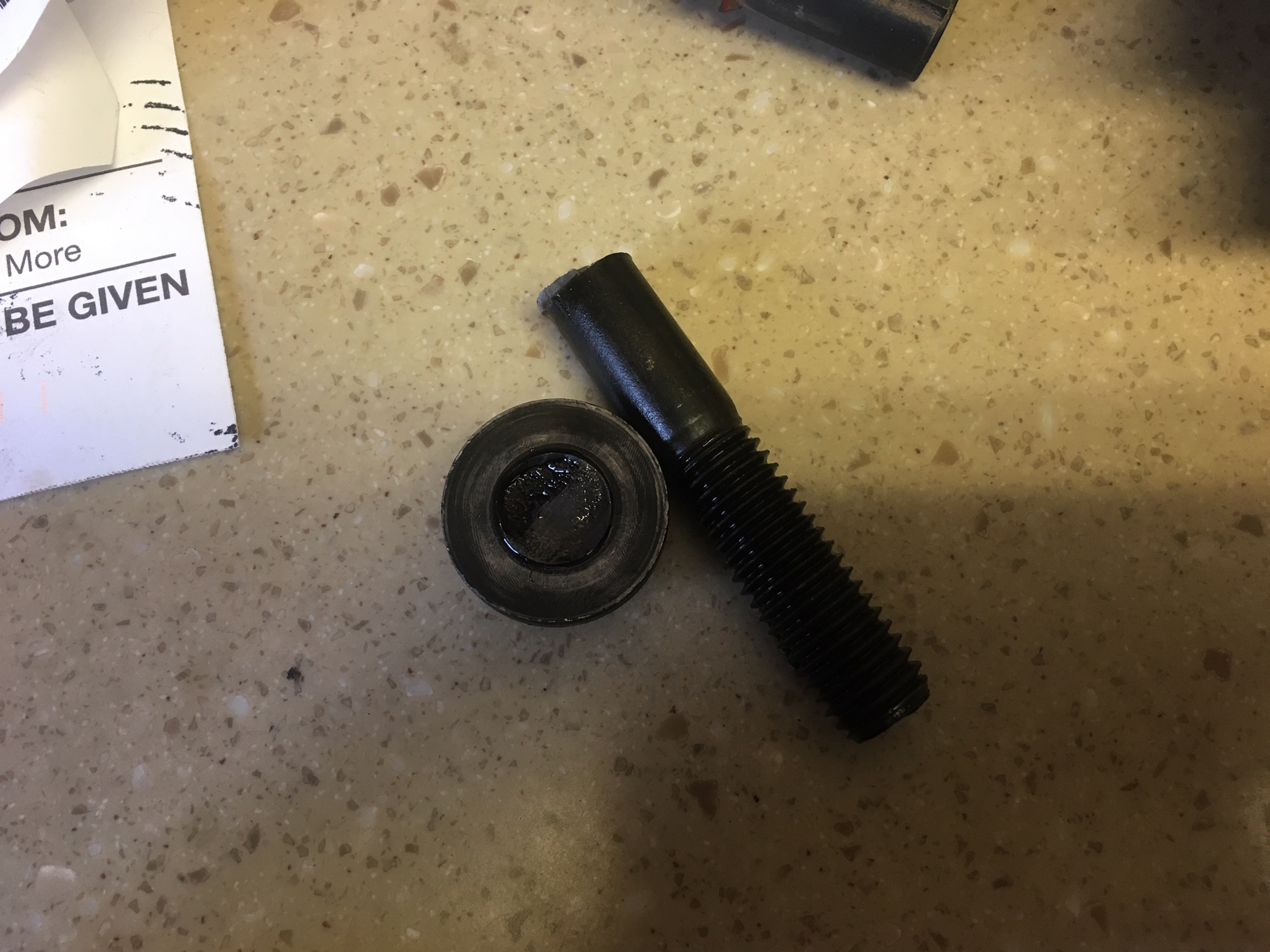

Yes i should go talk with the tech at the shop. I been reading quickserve and looked into the torque procedure. I set my wrench to 50ft lbs for the initial torque then back off a turn then torque to 22ft lbs then torque turn 60 degrees. First bolt torqued 50 no problem second one the damn bolt snapped well before hitting 50!!? If im looking at the paint marks correctly it looks like they torque turned them 120 degrees instead of 60(they went two "flats"). Would that have stressed these bolts enough to cause that one to break? Didnt want to screw with the injector adjustments because i dont have a in-lb dial torque wrench but i guess ill find one and get that done. At this point i think i need to pull all the bolts and make sure they are torqued correctly. Any pointers on what brand or where you guys got your dial gauge torque wrenches? thanks

(01-22-2020 )Signature620 Wrote: [ -> ]Looks like he didn't have enough time for the plus 60deg but had time for the 'anti-liability paint marks' lol
My motor was full of those when me and Rawze tore it down for the second in frame...
(01-22-2020 )Waterloo Wrote: [ -> ]
