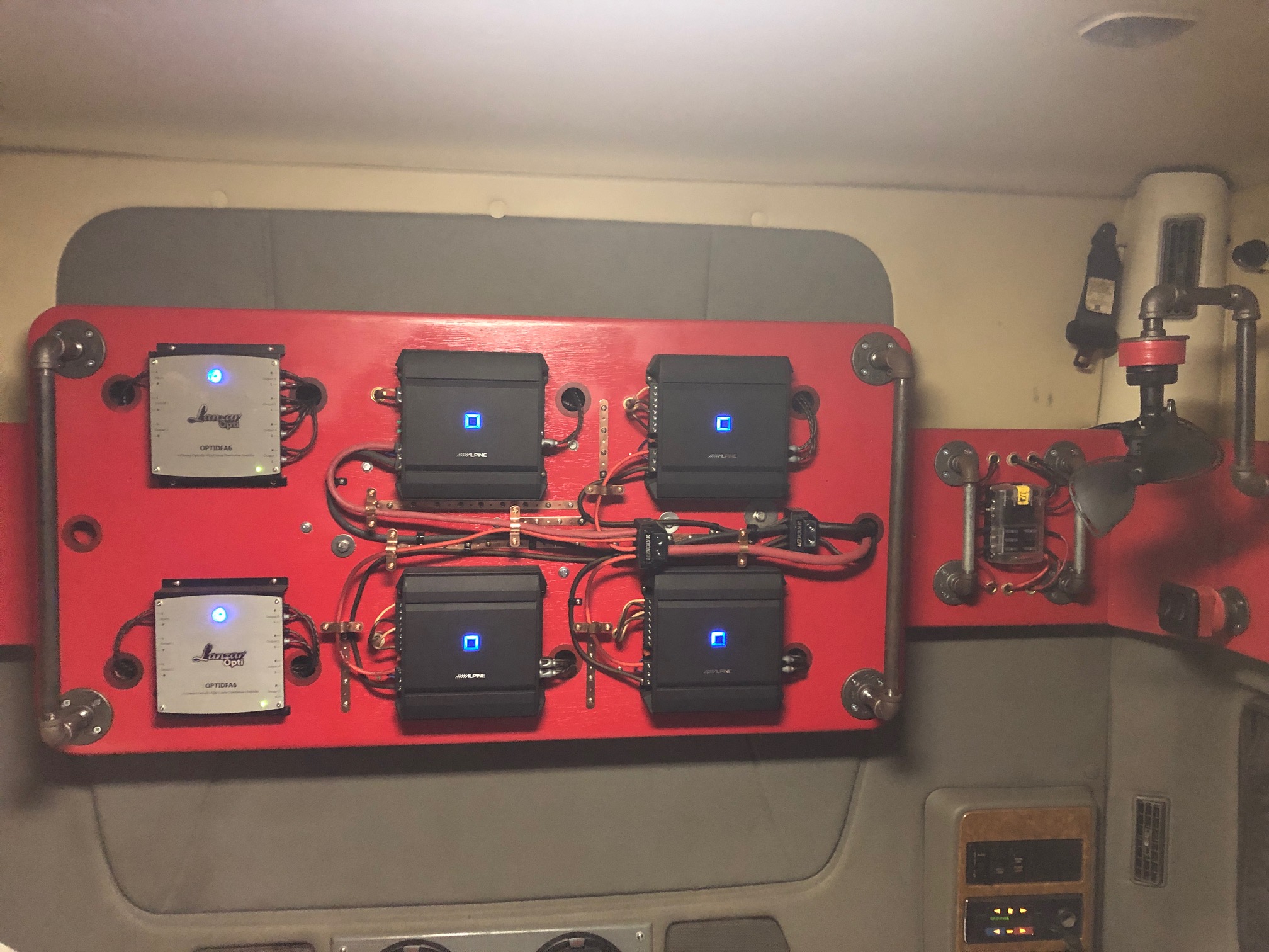

The WALL OF SOUND>>>>

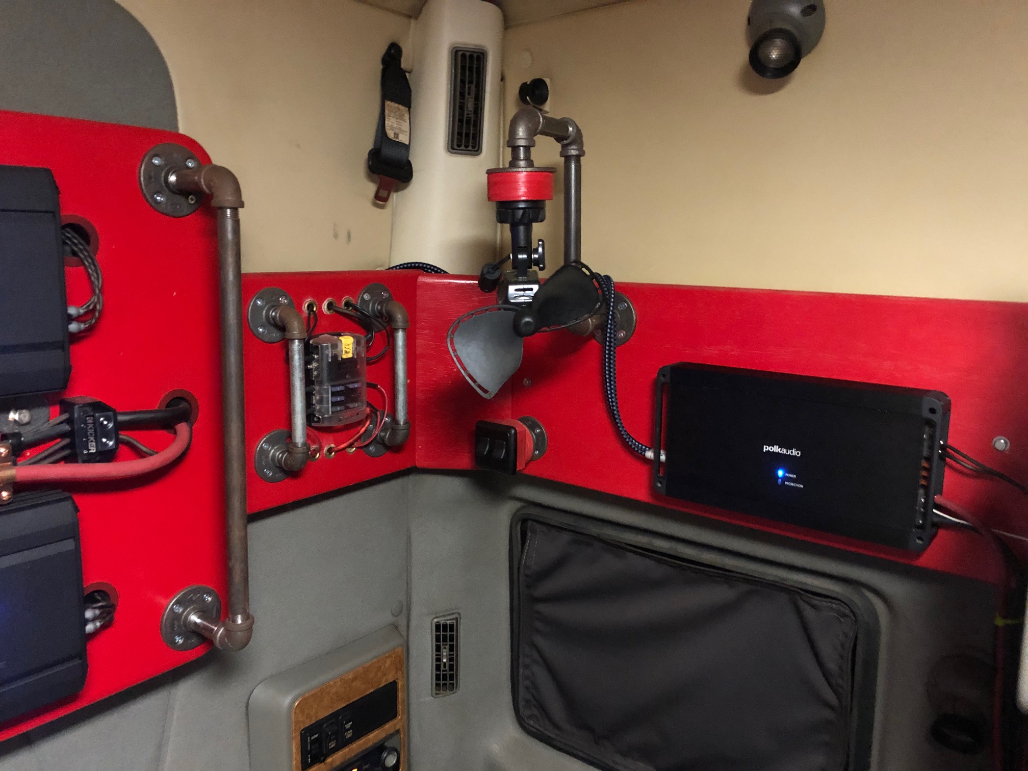

[attachment=6659]
[attachment=6660]
[attachment=6661]
Not pictured is the 10 inch RE SXX 1200 watt 1 ohm sub under the bed, that fifth Polk Audio amp is what powers that, a PA D1000.1, 1 ohm stable and putting out 1200 watts... The RE subwoofer has a custom made box, double baffled and she hits.
The Alpine amps are the S-A32F series 4 channel Class D amps, the three, out of four, I have mounted are bridged in two channel @ 160 Watts RMS, and perform without a hitch, other than the mono amp, the S-A60M, it is just a dummy up there, as she was not up to the task of driving the RE Sub so I installed the old Polk amp that drives the sub without breaking a sweat... Oh well... I had the Polk from my last build, and put her back into service the other day when I installed the batteries. Not the Alpine amps fault, just too small for the application. She would run, but an hour in, she was going into protect mode, not cool. But, not the amps fault, I thought I could get away with it... ;-)
The speakers are Alpine, one set of R Series 6.5" components up in the doors, tweeters mounted in the dash... A pair of the R Series 4 inch in the overhead and a pair of the R Series 6.5" in the sleeper. Each pair of speakers has a dedicated bridged amp @ 160 watts RMS.

Here is the kicker, it is so loud in there, AND CRYSTAL CLEAR, with the amp gains at near zero. This system will make your eyes and ears bleed. ;-)
I have everything piped through a cheap little 7 band equalizer in the dash. Best $50 I spent on the system, it works, really shapes the sound nicely and really balances the system.
I have it all ran trough the Alpine CDE-175BT head unit... It gets the job done, and plays well with the iPhone.
Those two silver boxes on the wall, those are the Lanzar 6-Channel High Current Distribution Amplifiers https://amzn.to/3fx32H7
I needed those to run the signal out of the head unit so that I could use multiple amps on the three sets of speakers to keep the fade and balance operational in a multiple amp situation, and boost the line level. For $40 ea they fit the bill.
The rest of the build was Home Depot, I hit their plumbing supply department as you can see...
I have the board that everything is mounted to secured to the actual rear of the sleeper, I ran some stainless lag bolts in from the outside to secure everything. Those pipes on the side of the mount, I use them as hand holds when needed, and I have, she is mounted solidly.
The fans, I have two in the back and one hanging from the center of the overhead up front, they are the Caframo Ultimate 757 12V 2-Speed 7 inch Fan, and boy do they move the air... https://amzn.to/2YLN7xM

Last photo is the sleeper closet... That is the new $400 AGM battery on the floor, to the right is the battery isolator https://amzn.to/2Y76kel and the box on the back wall is a remote switch, https://www.oreillyauto.com/detail/b/nvi...itch&pos=3 to turn the amplifiers on, it is what they use to control lighting for off road vehicles, I bought it at O'Reilly's, the remote is up front.
I have much of this stuff direct wired, disconnected from the trucks electrical system, very little is on the actual ignition circuit, so I make good use of remote turn ons in the cab and sleeper. And the benefit there, is that I do not have to run a bunch of wiring, I direct feed it off of the batteries and simply place a remote unit in that wiring, no switches needed to be installed, hence the extra fuse panels. Just a few key fobs which are easy to keep track of and use. And yes, in line fuses were used.
I have a Blue Seas fuse panel mounted on the back wall, between the fan and the amps, I also have one up front... These panels rock. https://amzn.to/2ABn5Wl
