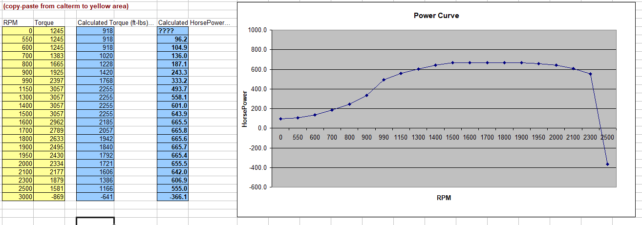

* Here is the power curve... IT WILL ABSOLUTELY DESTROY THIS ENGINE IN A HURRY!!!..
[attachment=8026]
IT IS A RIDICULOUS, LINER-KILLING 2250FT.LBS AT 665 hp.
* The injection timing is still factory and expecting EGR gas.. it is more than +10 BTDC and will fret a liner out of this engine in a hurry.
* The turbo is being forced upwards to making 38 LBS boost under fulll operating loads. An X15 engine cannot handle more than 30-32 PSI boost even at 700 HP... nonetheless what it is set to... this is going to make it run severely too lean and it fight its own exhaust back-pressures all the time... if it does not cause a cracked piston failure.
[attachment=8026]
