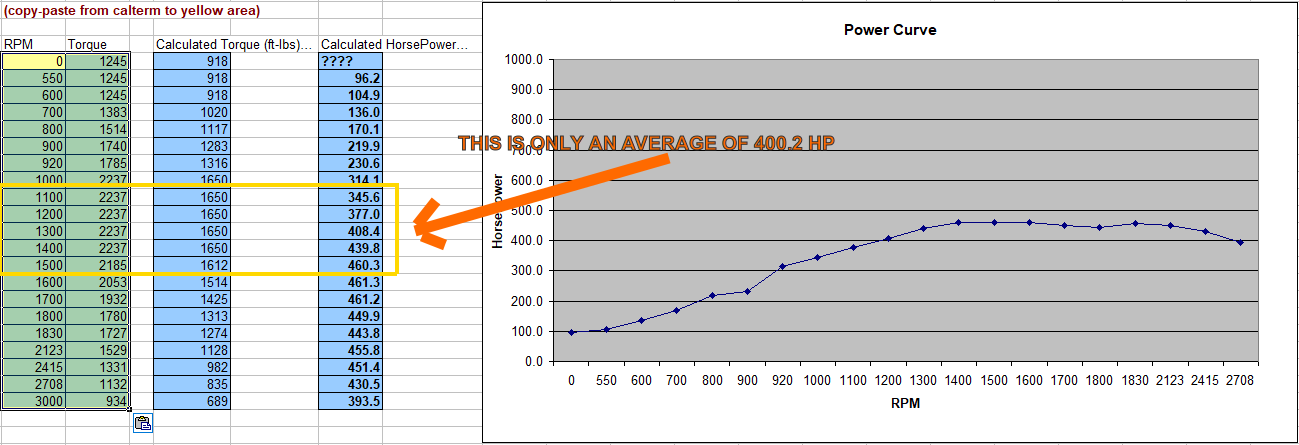

If you cannot make full rpm (1500 - 1900+) then it is not likely you will get higher boost values because the truck is completely unable to make full HP below 1500 rpm.
[attachment=8566]
