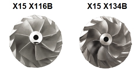

Also swapped the turbo with a low mileage (less than 25k miles) replacement off of a X15 X134B CPL 5880 rated at 565hp. Mine is a X15 X116B 4343 CPL rated up to 605hp, I'm at 580HP, They both are HE400VG's but the new one has a curved compressor blade compared to my original flat blade.
[attachment=9177]
The turbine blades are the same on both according to Quickserve. Test drove it around the neighborhood with my foot on the brake and it seemed to act similar to the original, although I would like to have expert eyes see live data to determine if the charge air flow will need to be adjusted to prevent any long-term issues. I'll keep you guys posted when I get some hard data.
I'm not "expert eyes" on this subject but is max boost the same with both turbos?
(opinion based on what I have seen). As far as performance goes, I wold think the intake impeller differences themselves would be about the same. One is likely a bit more quiet than the other is all.
Otherwise, the only way to tell what 400-series turbo you have, is to measure accurately, the intake housing inlet to see if it is 34mm or 36mm. The 34mm housing is the fuel efficient one, and the 36mm is the heavy haul one with the heavier duty exhaust turbine. This is assuming that they are original and no one has swapped parts around in them at a turbo repair shop or something.
Max boost is the same on both.
