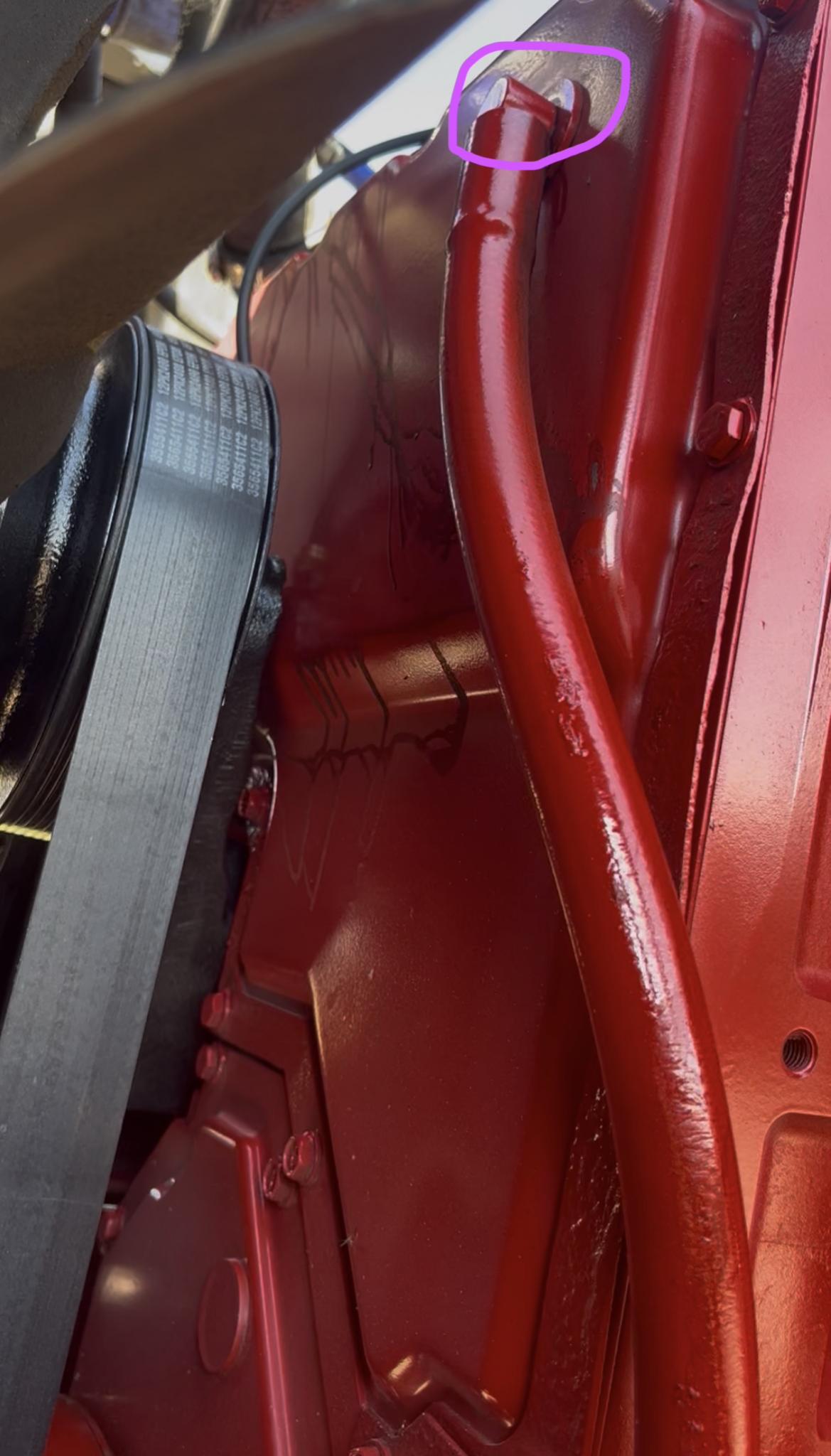

Change the breather gasket too and save you some time if you don’t mind. Mine leaked after
RE: Front structure seal - Scoot5869 - 01-25-2026
Ok thanks I’ll look into that it wasn’t leaking beforehand. Never thought about just removing the filter and running the tube down. Thanks
RE: Front structure seal - 3406E - 01-25-2026
I don’t think it was leaking before
