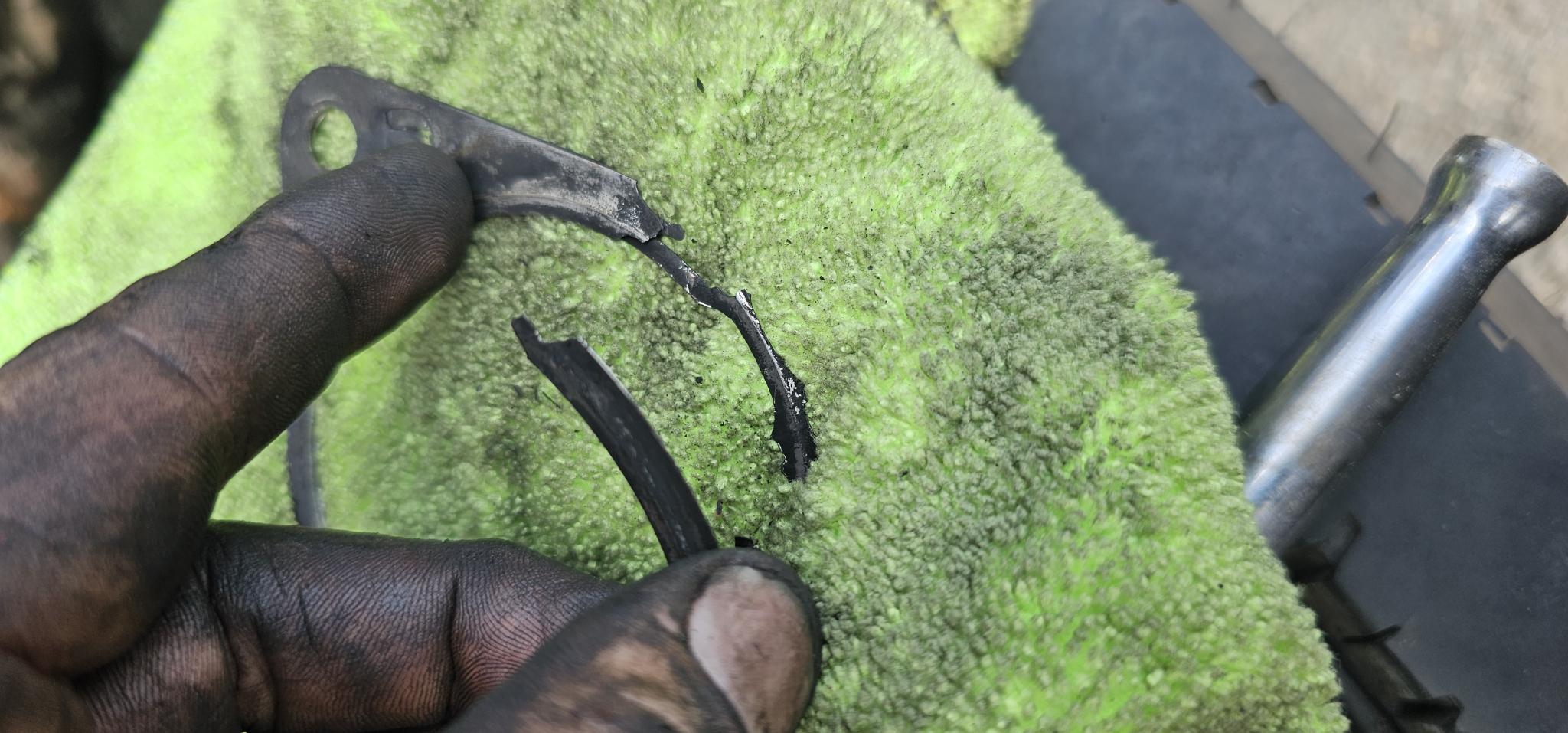

Found this bad gasket at the back of the egr cooler going towards the soft crossover in the back of the engine.
