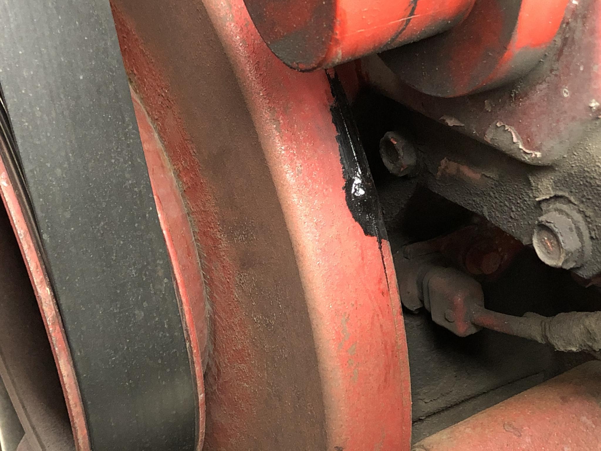

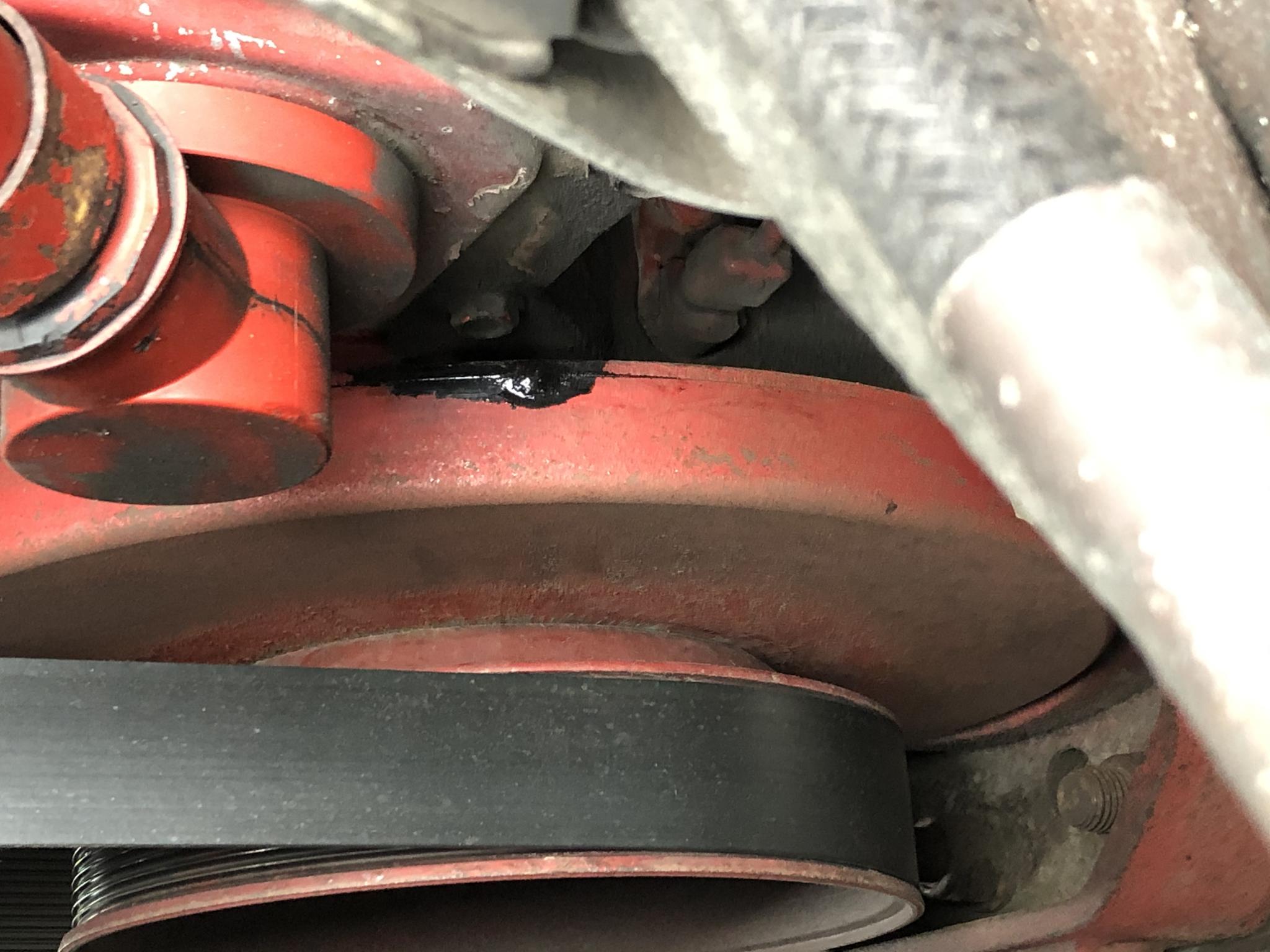

RE: Cummins running ruff - Waterloo - 03-28-2016 (02-24-2016 )Isx Lover Wrote:(02-24-2016 )Fordmandan87 Wrote: The crankshaft dampener hardens around 500k and you start feeling more engine vibration as a result. Not saying that's the cause but it could be making it more noticeable. That is supposed to be a viscous material, as in liquid... Not tar. That one is bad. RE: Cummins running ruff - Old Driver - 10-05-2019 Just seen this black rubber looking material on my damper coming out from the seam. This damper only has 180,000 miles on it and about two years old. I used three coats of cummins paint on it ( don't remember about primer) and it seems like the paint is holding up. Is this a normal failure or a sign of other damage. Its a CM871 with 701,290 miles and 17245 hours. I dont want to just replace the damper if there us something else that caused a problem like this. I.e. crankshaft RE: Cummins running ruff - Waterloo - 10-05-2019 What the hell is up with Cummins and these parts? That damper is failing, I would get that off ASAP. If Cummins installed the damper, or the dealership, the part should have a 1 year labor and 2 year part warranty. This is one of those times I hope you had this replaced at a licensed Cummins shop. Looks like a poor quality build, it should not separate like that. I can't see your crankshaft doing that. I can't see any damage on the damper, I am going with poor QC. RE: Cummins running ruff - Old Driver - 10-05-2019 I put it on myself 2 years ago. Nothing hard to do just follow the manual. I have no hesitation to do another one, just dissatisfy with a failure like this. RE: Cummins running ruff - Waterloo - 10-05-2019 (10-05-2019 )Bahdan Wrote: I put it on myself 2 years ago. Nothing hard to do just follow the manual. I have no hesitation to do another one, just dissatisfy with a failure like this. I know, just wondering about the warranty if they will honor it if you installed it, you know, the damn fine print. RE: Cummins running ruff - marek4792 - 10-05-2019 http://rawze.com/forums/showthread.php?tid=77 this link shows mine actually came apart at about 1.1 million miles and when it was pulled off the truck, engine sounded like it had a really bad knock beforehand. |
