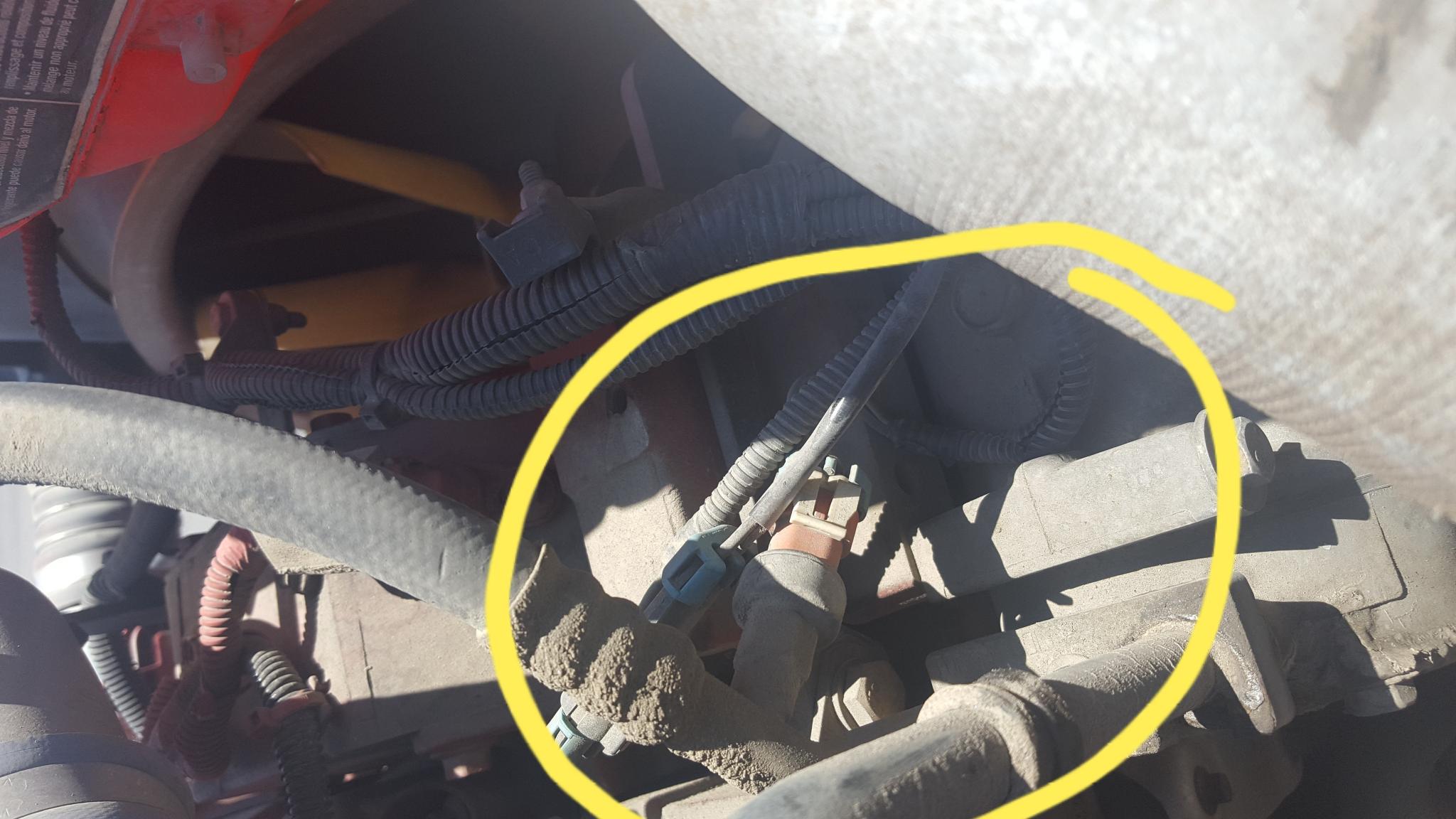

Theres a sensor on ac condenser to ac compressor that u need to replace. This happened to me on my 2011 kw t660. Fan wouldn't shut off until I replaced it. Think it's like $30 at kw dealer
RE: Help ..Fan has gone Haywire - jimeneztrans84 - 12-17-2019
This is the sensor
