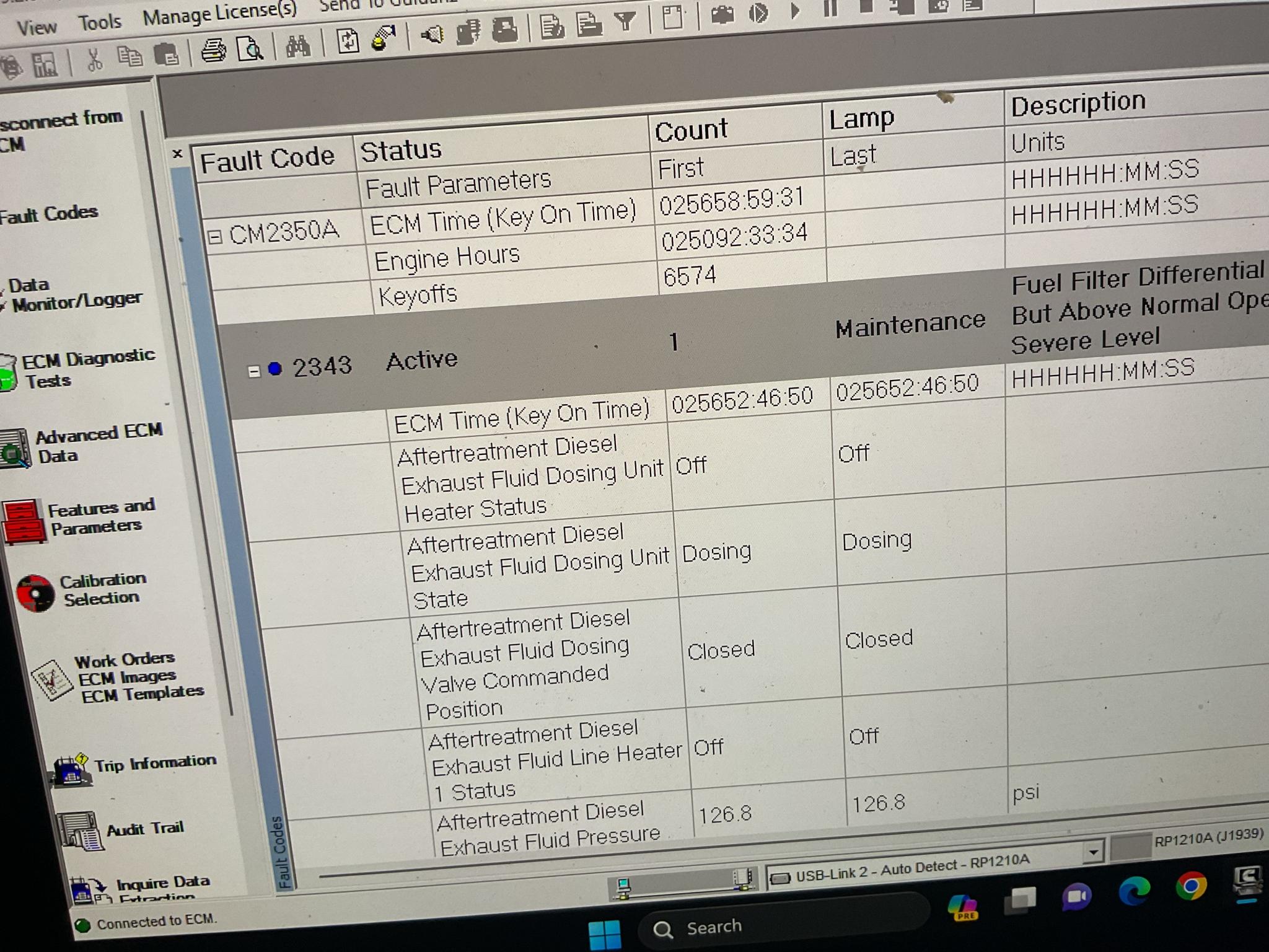

Hey I was coming up the road and it sent 2343 and 559. The codes were a few seconds apart. Does this make sense?[attachment=9218]

RE: Injector leak test - tree98 - 12-06-2023
When is the last time you changed the spin on fuel filter? That 2343 is a plugged filter!!! What brand of filter are you using?

RE: Injector leak test - Nhramember - 12-06-2023
(12-06-2023 )tree98 Wrote:  When is the last time you changed the spin on fuel filter? That 2343 is a plugged filter!!! What brand of filter are you using?
I just changed the spin on filter less than 2 weeks ago. I use only fleetguard filters on my truck. I just changed the water separator yesterday. I’m at wits end lol never ever had this happen till that biodiesel fill up.

RE: Injector leak test - tree98 - 12-07-2023
Those spin on filters are 4 micron, it only takes a little bit of bad fuel to plug it up. Change it again.
