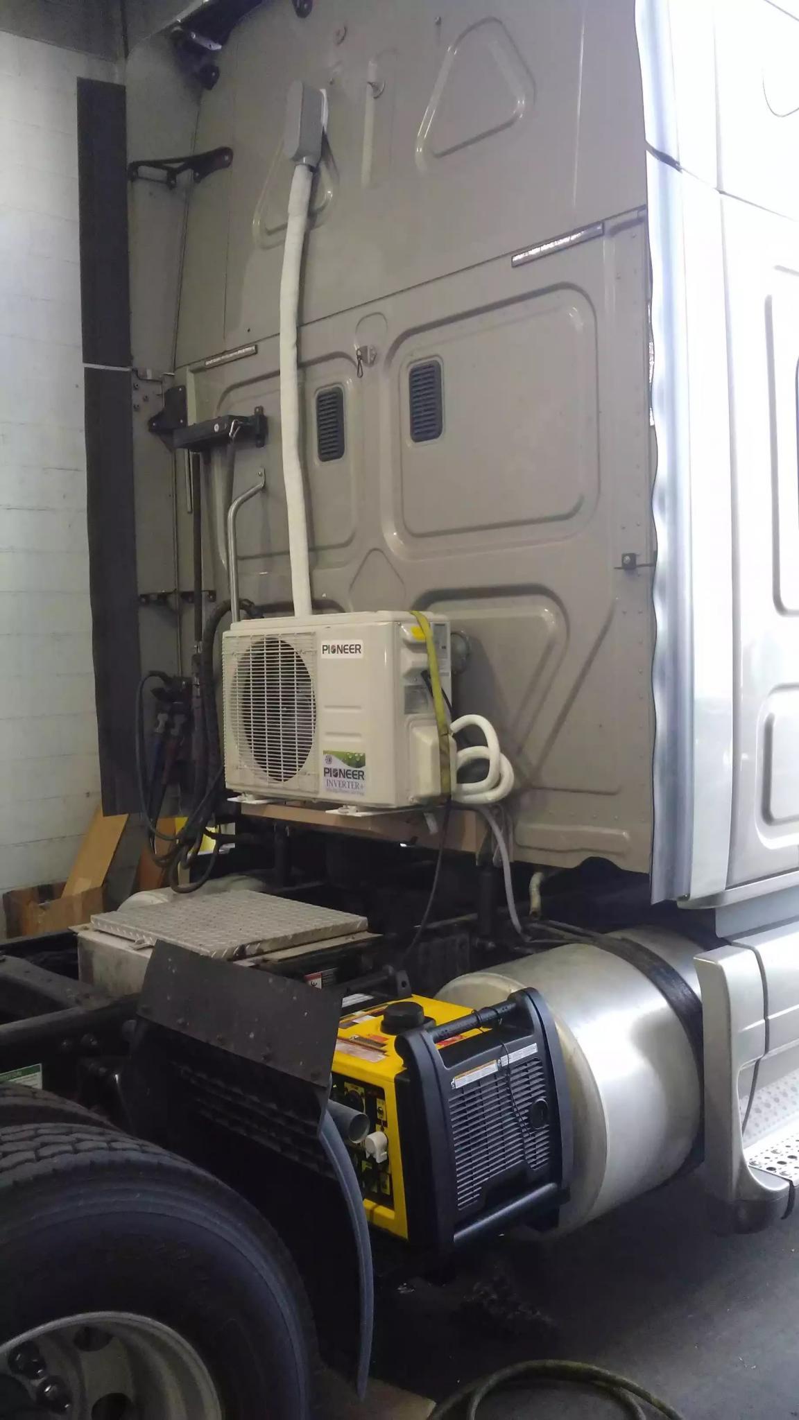

RE: Anybody running electric APU? - Kid Rock - 08-26-2017 (08-26-2017 )snailexpress Wrote:(08-26-2017 )Kid Rock Wrote:(08-26-2017 )snailexpress Wrote: Some words I have to say about safety. Oh, wow.. RE: Anybody running electric APU? - barf - 08-27-2017 (07-15-2016 )snailexpress Wrote: Here is one. Can run on battery, shore power or generator. Hey snailexpress: This was posted July last year. With 2 summers on it now, how's it holding up? Any problems? Still working? My diesel APU packed it in and I can't justify fixing it or buying a new one. Next spring I'd like to install a split AC and am wondering about durability. RE: Anybody running electric APU? - snailexpress - 08-28-2017 (08-27-2017 )barf Wrote:So far I don't have any problem with AC unit. Everything is working as it suppose to. i didn't cover outdoor part of AC or generator for the winter. Generator gave me some problem but now I have fix it. Tomorrow will post picture for more reliable indoor unit support. Existing brackets not designed to survive bumps and bridges G-force.(07-15-2016 )snailexpress Wrote: Here is one. Can run on battery, shore power or generator. RE: Anybody running electric APU? - Rounded_nut - 08-28-2017 (08-27-2017 )barf Wrote:(07-15-2016 )snailexpress Wrote: Here is one. Can run on battery, shore power or generator. What happened to it and what brand? RE: Anybody running electric APU? - Rawze - 08-28-2017 (08-28-2017 )snailexpress Wrote: So far I don't have any problem with AC unit. Everything is working as it suppose to. i didn't cover outdoor part of AC or generator for the winter. Generator gave me some problem but now I have fix it. Tomorrow will post picture for more reliable indoor unit support. Existing brackets not designed to survive bumps and bridges G-force. I used to use portable A/C units with a generator too. 4-5 trips over veil pass though,.. and the portable A/C unit was toast. It just could not take the constant altitude changes. Same thing with small refrigerators that I would get at Walmart. Just throwing that out there for others to think about. RE: Anybody running electric APU? - Jon Mastin - 08-29-2017 Hey Kid Rock did you mount it to the back of the cab or to your headache rack? [attachment=3051] Mine is mounted to the cab like Snailexpress. keeps the movement on the hard copper lines to a minimum. Everything moves as 1 piece. I have only seen one other mini split installed in a truck in person and his was mounted to the frame and his connections were toast from all the movement between the cab and frame. RE: Anybody running electric APU? - Kid Rock - 08-29-2017 (08-29-2017 )Jon Mastin Wrote: Hey Kid Rock did you mount it to the back of the cab or to your headache rack? I went and got a bracket made like the one snailexpress has. I have a volvo too so it worked out perfect not having to drill any new holes for the bracket. |
