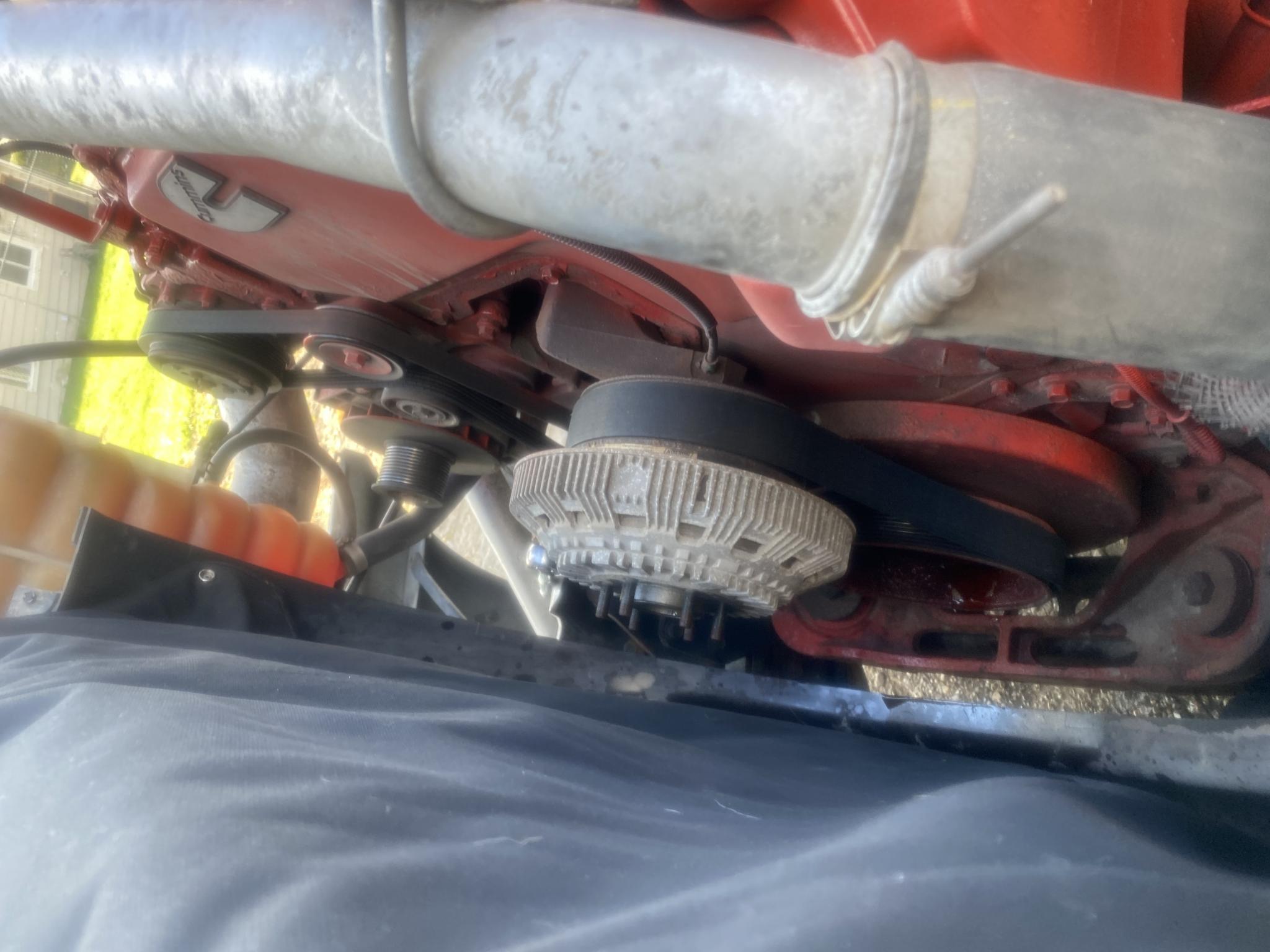

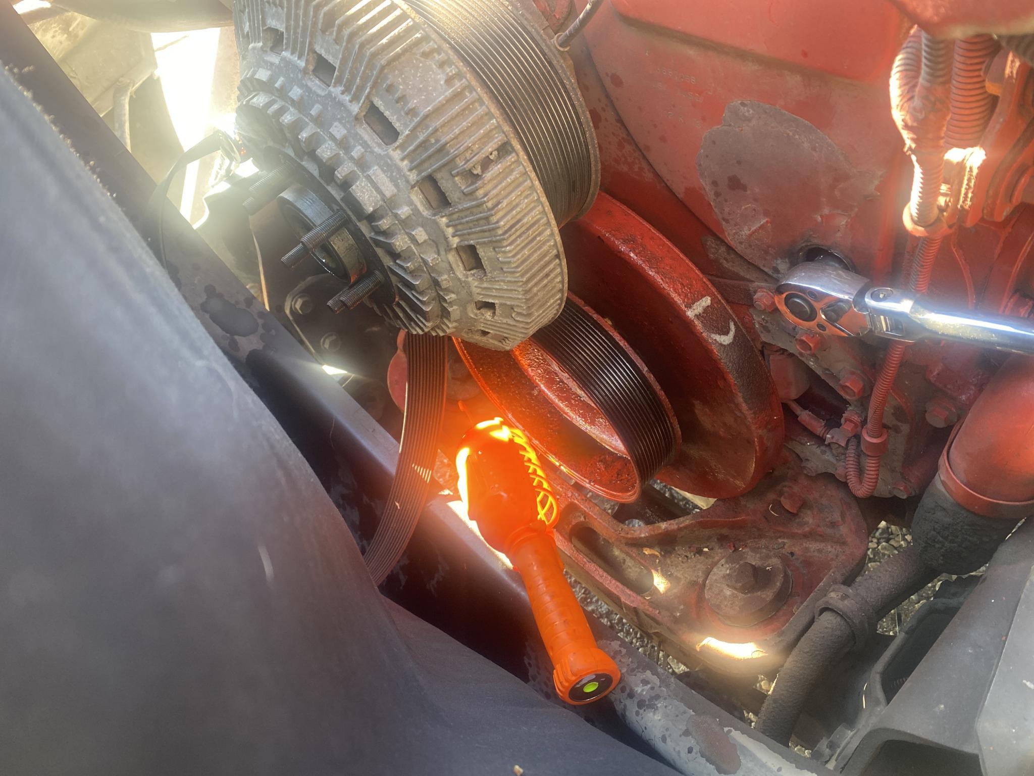

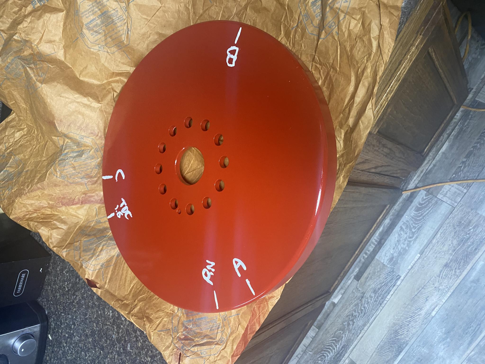

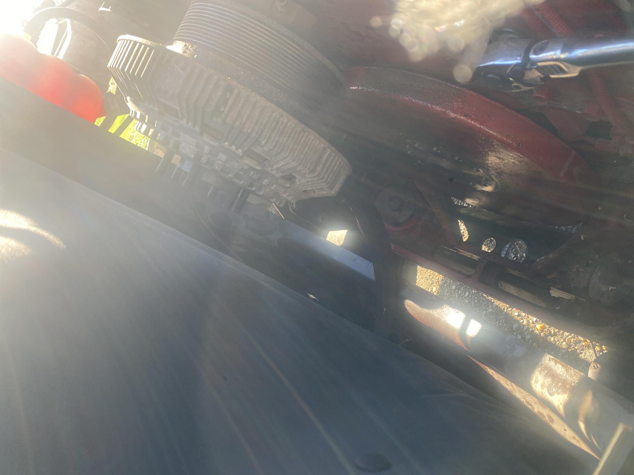

RE: vibration damper thoughts - GhostHauling - 10-31-2021 Well it took forever for this paint to dry properly I should have done this in the summer it’s never fun painting and working in the cold wet months. RE: vibration damper thoughts - GhostHauling - 11-05-2021 This dang plate and pulley doesn’t want to come off any tricks ? RE: vibration damper thoughts - Nilao - 11-05-2021 I'd get the fan, clutch and shroud out of the way. If I remember Rawze had to remove his front end and put a 3 ton hydraulic puller in his before it'd budge. RE: vibration damper thoughts - GhostHauling - 11-05-2021 The fan and the shroud is gone well the top half of the shroud I left the bottom in but I got the plate and the pulley off now the end of that cam shaft is just so rusted and it looks like they just painted it while it was on so the paint was all glued together but now I am onto the vibration Damper I sure hope I don’t have to tear down the truck anymore I have a lot of room here and I covered the inside of the radiator with my privacy curtains that I didn’t use anymore to protect it from me RE: vibration damper thoughts - GhostHauling - 11-05-2021 Almost done 3 hours into this now i’ve learned that I am the slowest mechanic on earth and could never do this for a living on other people stuff RE: vibration damper thoughts - GhostHauling - 11-05-2021 Almost done 3 hours into this now i’ve learned that I am the slowest mechanic on earth and could never do this for a living on other people stuff RE: vibration damper thoughts - Hop along cassidy - 02-20-2025 (04-20-2020 )Rawze Wrote:(04-19-2020 )hookliftpete Wrote: How does time play into these wearing vs miles? Do you think this could be why my Jake's don't vibrate at high rpm above 1500 but when rpm reaches around 1400 and below it feels like my motor is gonna come apart. Cummins rebuilt the jakes and new wiring harness for jakes and injectors. Compression test and vgt inspected ipt test all passed. Can't figure it out. RE: vibration damper thoughts - Hop along cassidy - 02-20-2025 Does anyone think this could be why i'm getting vibration from my jakes? Over 1500 rpm not much if any vibration but 1400 rpm and below feels like the motors going to come apart. Cummins rebuilt the jakes replaced wiring harness compression test ipt test over head adjustment checked turbo and vgt everything looks good checked with computer on test drive check all settings, even settings on the transmission even hooked up to trans on test drive with computer. Its like the jakes get weak and massive vibration. Help RE: vibration damper thoughts - SquareOne - 02-20-2025 Does it change the vibration when switching through the different stages at a given RPM? Also, what kind of mileage are we talking on this setup? Did they mention the detent condition on the Jake rockers or the lobe condition the Jake rides on? Would you happen to have a boost gauge to see what the psi is coming up to when the Jake is used? Should also change as you're moving across the 3 stages. Most important question...is this a stock or dE-leted truck and has the program been reviewed if so? |
