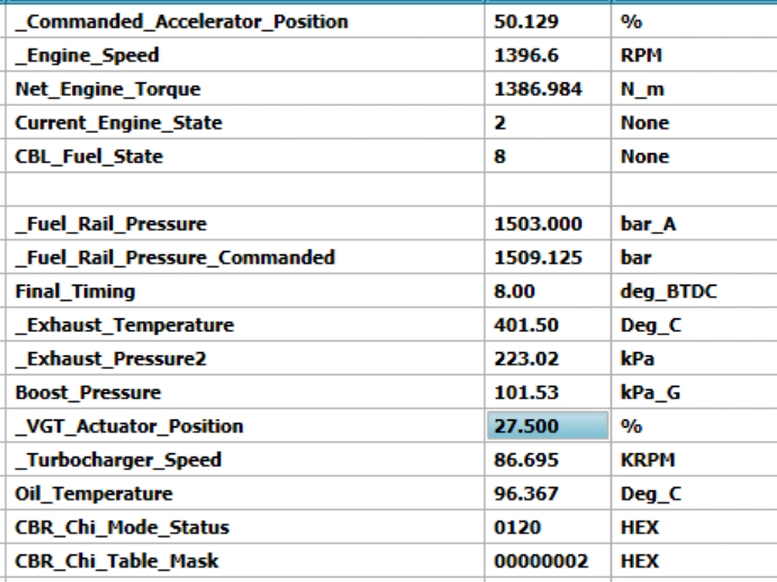

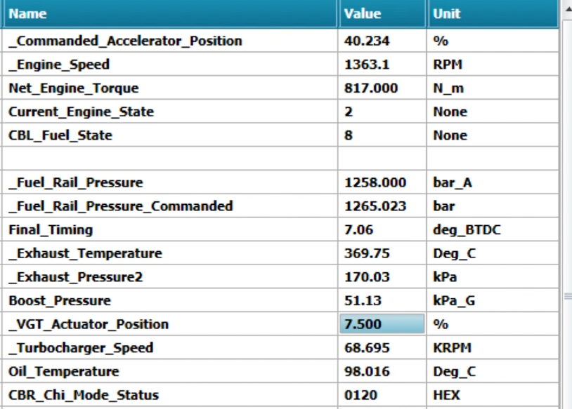

Now, the next morning after fixing the trailer I hooked up to CT but everything had gone back to normal while driving. It wasn't until later in the drive that I recorded full throttle pulls and after the long pull it was unmistakable that the actuator wasn't closing all the way after letting off and getting back down to normal driving speed.
At 40% throttle the actuator was at 7.5% and sometimes dropping as low as 4%.
At 60% load/Half throttle boost was sitting at 14-15psi and going no higher. It pretty much stayed "open" for the rest of the drive. No codes were showing after I shut down later that night. No CEL or anything. Started running the next morning and back to normal everything was.

The turbo does not follow the throttle pedal. It follows the RPM and fuel flow commands. - The fuel flow data is missing from both of those screen shots you took, so its anyone's guess as to what your trying to say.

(Yesterday )Rawze Wrote:  The turbo does not follow the throttle pedal. It follows the RPM and fuel flow commands. - The fuel flow data is missing from both of those screen shots you took, so its anyone's guess as to what your trying to say.
I added the fuel flow rate. Are there any other parameters I should tack on before recording again? Do you want to see what it does at full throttle or just normal driving?
