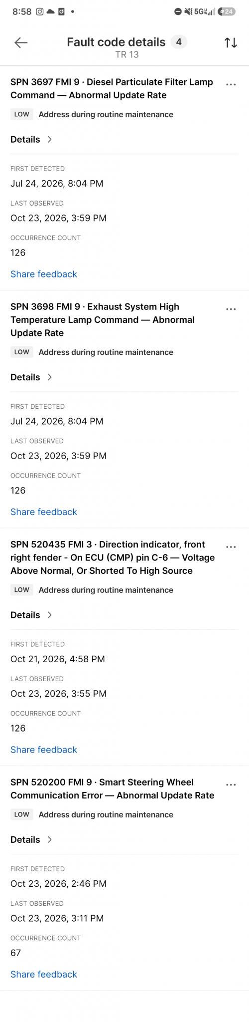

Also, I did the demandate myself. I hollowed out the cans. But I've attached a picture of the fault codes I get thru the Motive app. I dont get these codes in Insite though.
