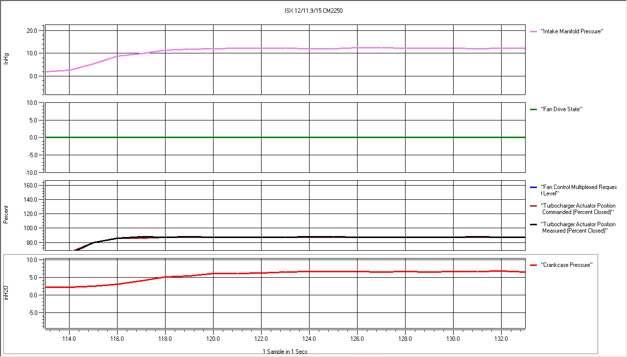

[attachment=2401]Same 2250, right after uploading the default cal the ecm pops up with high cc pressure(1st time ever for this one). It's running 7 in/Hg at idle goes down to 2 at any RPM above 800. The error is valid signal but too high for conditions and rates it moderately severe.
Thanks

RE: High cc pressure at idle - gearhead - 01-29-2017
You can see the effect the turbo has on the crankcase pressure.
