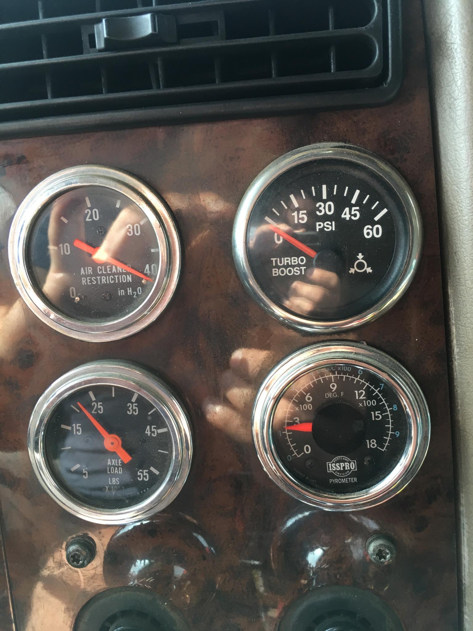

[attachment=2980]
I do have boost and pyro gauges, the pyro gauge isn't wired for a light though. It might be there and just need to be hooked up. Why the air cleaner gauge is pegged to the right, who knows. I was told just change the filters every 6-10 months and not worry about it, but we'll see.

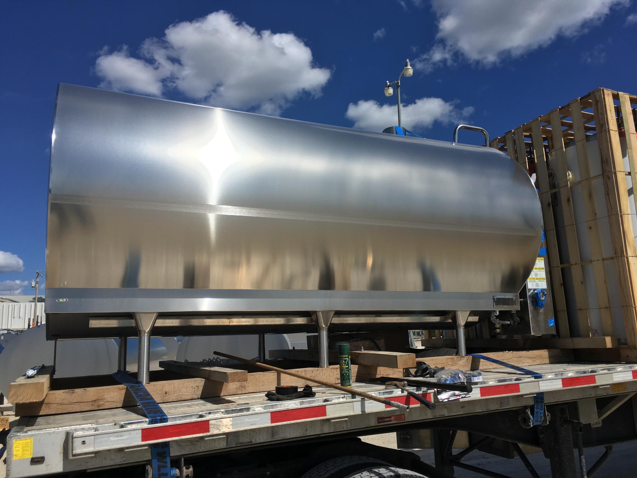

[attachment=2981]
Those were kinda a pain to load, they threw cardboard boxes under all of them. Got out the 1" and 2" straps, total of 19 straps I think. Not bad all in all.

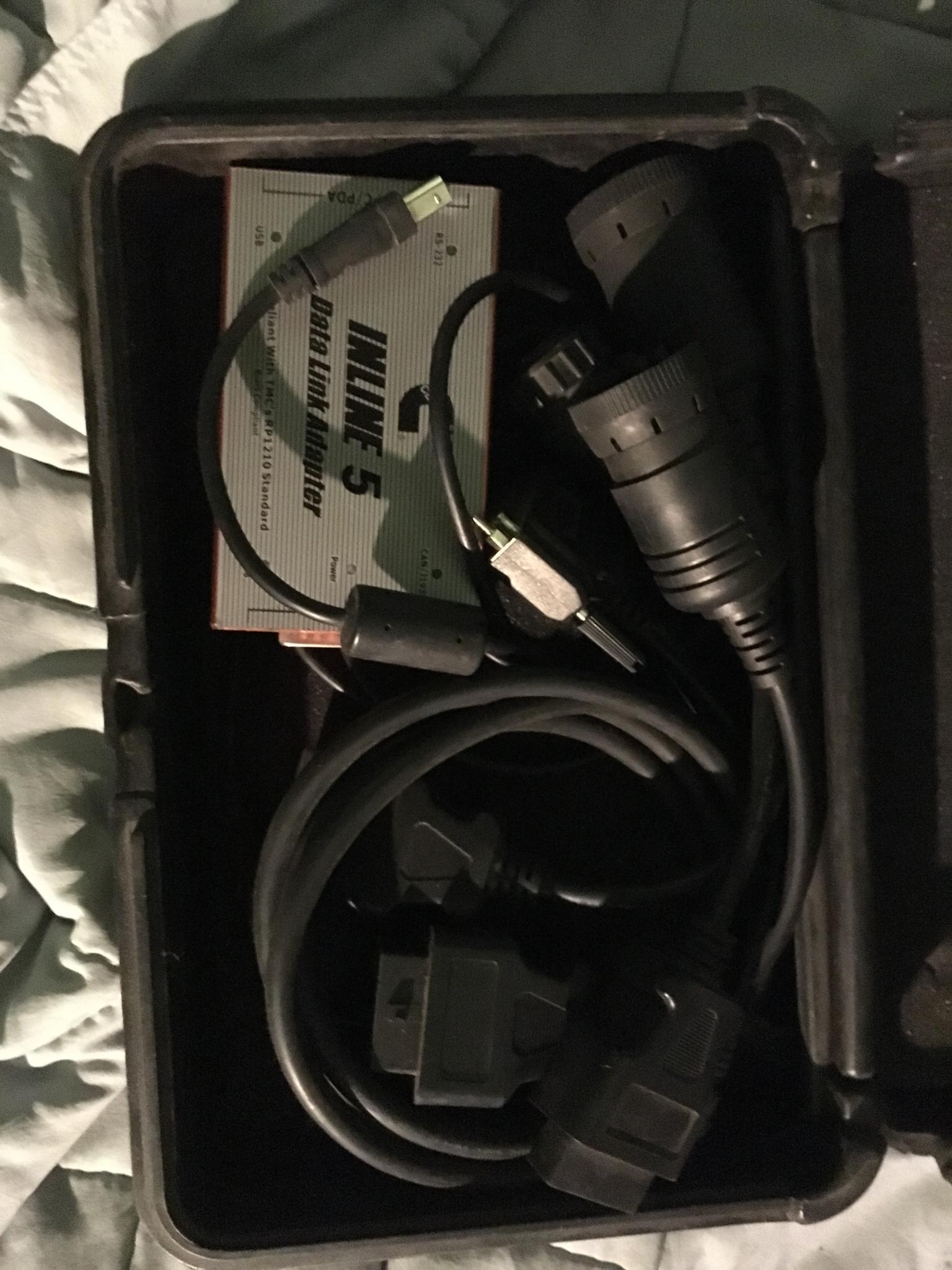

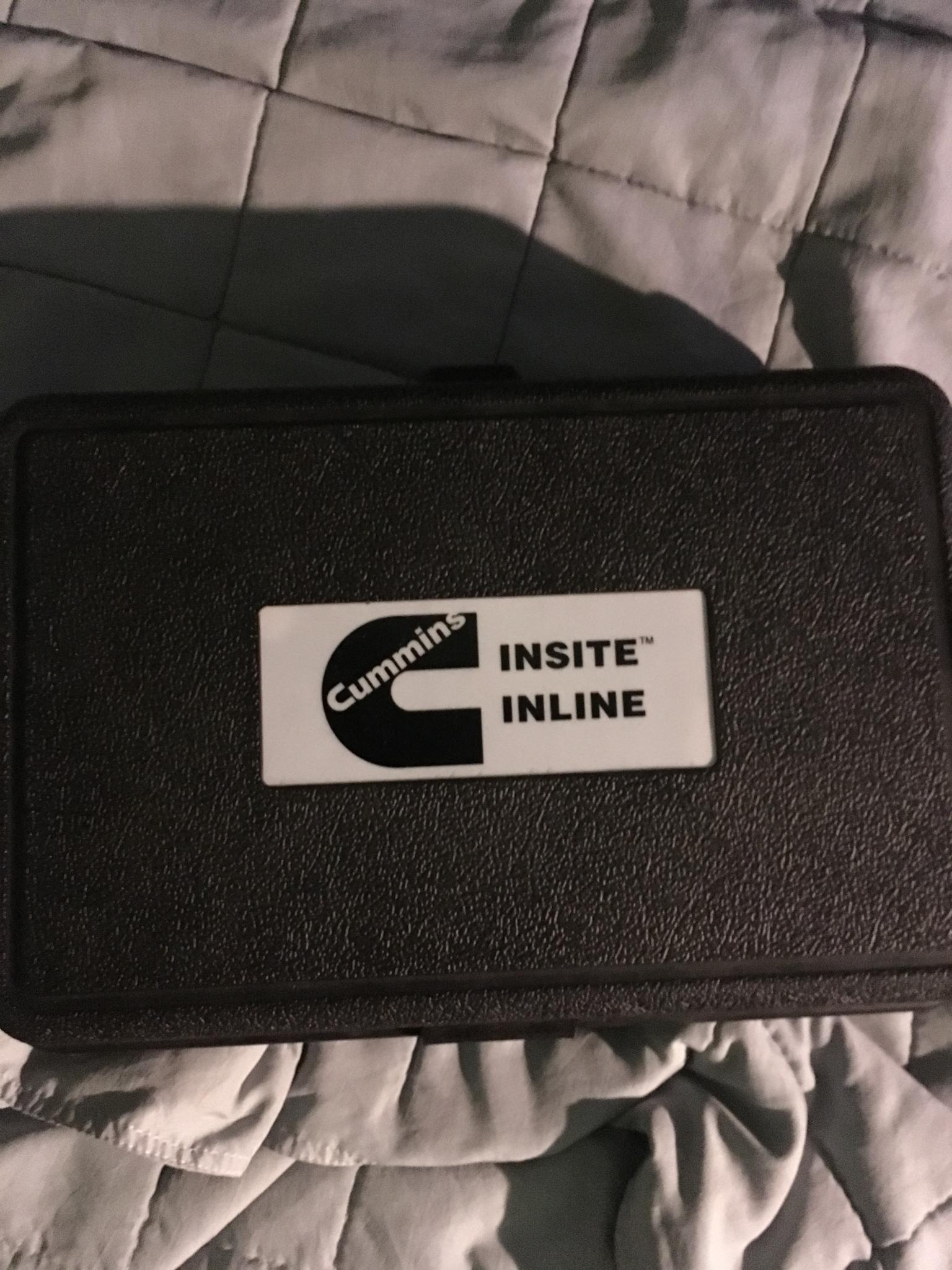

[attachment=3011][attachment=3012]
Picked that up off ebay for $225. Customs and shipping and the exchange rate made it closer to $350 but if it works I'd think that's a deal.
RE: 2003 ISX suggestions needed - Hammerhead - 08-19-2017
(08-19-2017 )DDlighttruck Wrote:  Picked that up off ebay for $225. Customs and shipping and the exchange rate made it closer to $350 but if it works I'd think that's a deal.
Excellent move. The first trip you avoid to the stealership will pay for it, no question!
Just remember, the computer you set Insite up with is A TOOL NOT A TOY! Do not connect it to the internet, you don't want to risk putting a virus into your ECM.
RE: 2003 ISX suggestions needed - DDlighttruck - 08-19-2017
Can I get away with Powerspec? Or is Insite that much better?
Yes thinking of getting a second laptop just for Insite, for the reason you mentioned. Thanks!
RE: 2003 ISX suggestions needed - Waterloo - 08-19-2017
You need Insite... To much going on in these motors.
