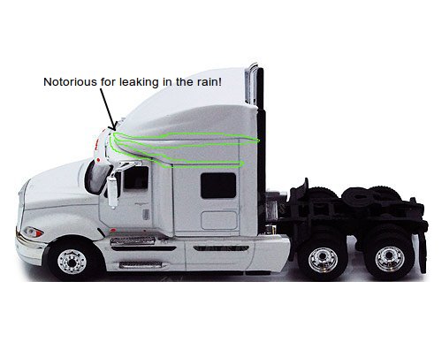

* Next is the fact that prostars are very very notorious for leaks at the joint where the top dome meets the cab. That groove just above the doors that runs all the way around the cab. Everyone swears they do not leak from there but they all do it. FILL THAT JOINT COMPLETELY -- 100% WITH SILICONE AND SEAL IT OFF 100%. It will take a good 3-4 caulking guns worth of silicone. SEAL IT OFF!, and especially well in the front area. This is where they all leak and moisture gets in. It then runs down wiring harnesses and down the left/right side under the plastic trim of the interior of the cab next to the windshield, and even drips and pours water into the gauge clusters, into your CB radio at the top sometimes, it follows wiring harnesses and then you get water into connectors and sometimes the fuse panel too. It can also short out a compass module and even if you don't have the compass module, it will short out the wiring for it that is tucked in behind everything. -- SEAL THAT DOME OFF !!! 100%!!!> ALL THE WAY AROUND!
[attachment=2967]

I have noticed a very random drip that falls out of the bottom speaker grlll for the cb. I'll get busy caulking the cab dome and swapping the fuses.

Sealed up the cab dome.

Good news if after I finished with all that the electrician fault is now gone and everything is functioning as it should.
Annoying news is I never found the root cause and nothing stuck out and bad so I don't know where the problem originated from.
