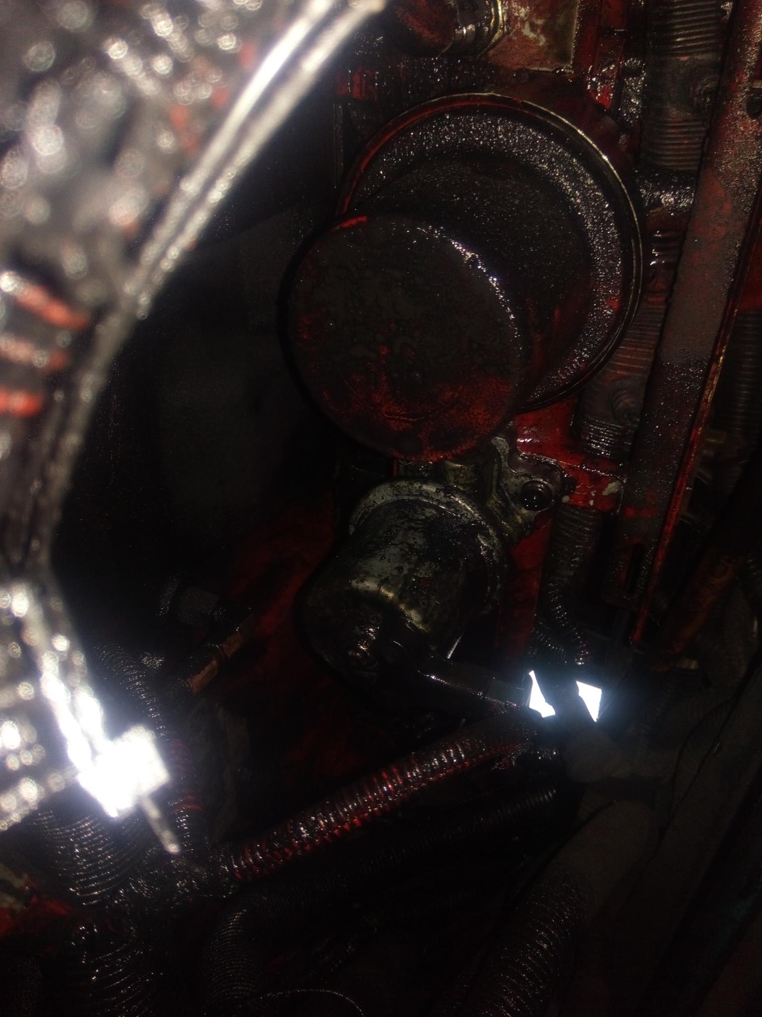

My apologies as I'm having to learn some of this terms used in trucking , at idle the pressure is 268kpa the fuel usage is stop and go what would be the ideal consumption the driver sent me a pic of a diesel leak on the diaphragm on the inlet side of the engine today , by water I meant coolant.

That is...well I’m speechless. It needs to be cleaned and fixed ASAP. You’re never going to find the leak with it that wet.
RE: ISX 475 oil leak - Rawze - 02-06-2018
Leak or not, That is the nastiest looking engine I have seen in a while -- I would suggest a power-wash and some basic TLC too. Those photos point towards a seriously neglected piece of equipment. If you would have showed up over here at my house with it that nasty and neglected, I would have run you off to go get it power-washed and steam cleaned first.

S53S , I’m puzzled. First you wrote oil pressure at 265kpa max and now you said 268kpa at idle . That can’t be possible , unless oil sensor or oil gauge gives a false information.
This nasty thing on picture looks more like an oil than fuel . Either case is in desperate need to be cleaned. Smear some on paper and see what it smells like.

Thank you Wiseman I will confirm the readings again via pics, @ Rawze all comments received with gratitude I wash the engine every week when the truck comes back using a 250bar pressure washer myself , I sent the pic to show you the leak, I came on the forum for help because the leaks are irritating me being a first time owner I don't expect sympathy though lol! The stuff does smells like diesel. I really wish I could send the engine there or get a recon , I'm sure I'll get all the help I can from this platform thank you guys!
