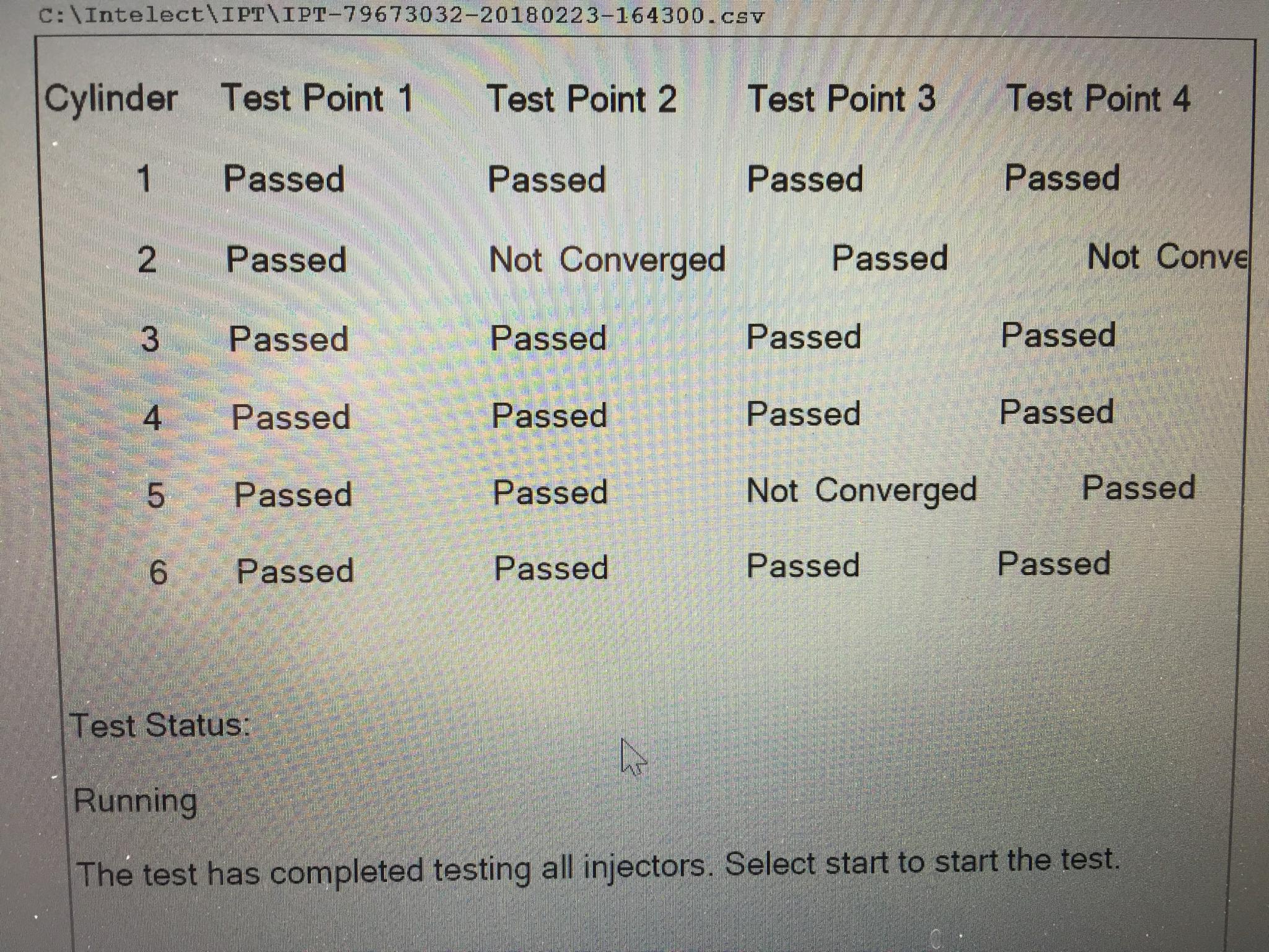

Help with injector performance test results - Rounded_nut - 02-23-2018 I get a little stumble sometimes at idle and figured why not run the test, I've done the leak down and that was well within spec. I got the results though from the performance test and wanted to know what the heck the convergence thing is about. Thanks. RE: Help with injector performance test results - hhow55 - 02-23-2018 It might be a good idea to do a cylinder cutout test. rawze has a video on the details, running engine on one cylinder at a time. RE: Help with injector performance test results - Rounded_nut - 02-23-2018 (02-23-2018 )hhow55 Wrote: It might be a good idea to do a cylinder cutout test. rawze has a video on the details, running engine on one cylinder at a time. Already did that, seemed like they were all ok, as well I did the actuator test too and that seemed to do just fine. |
