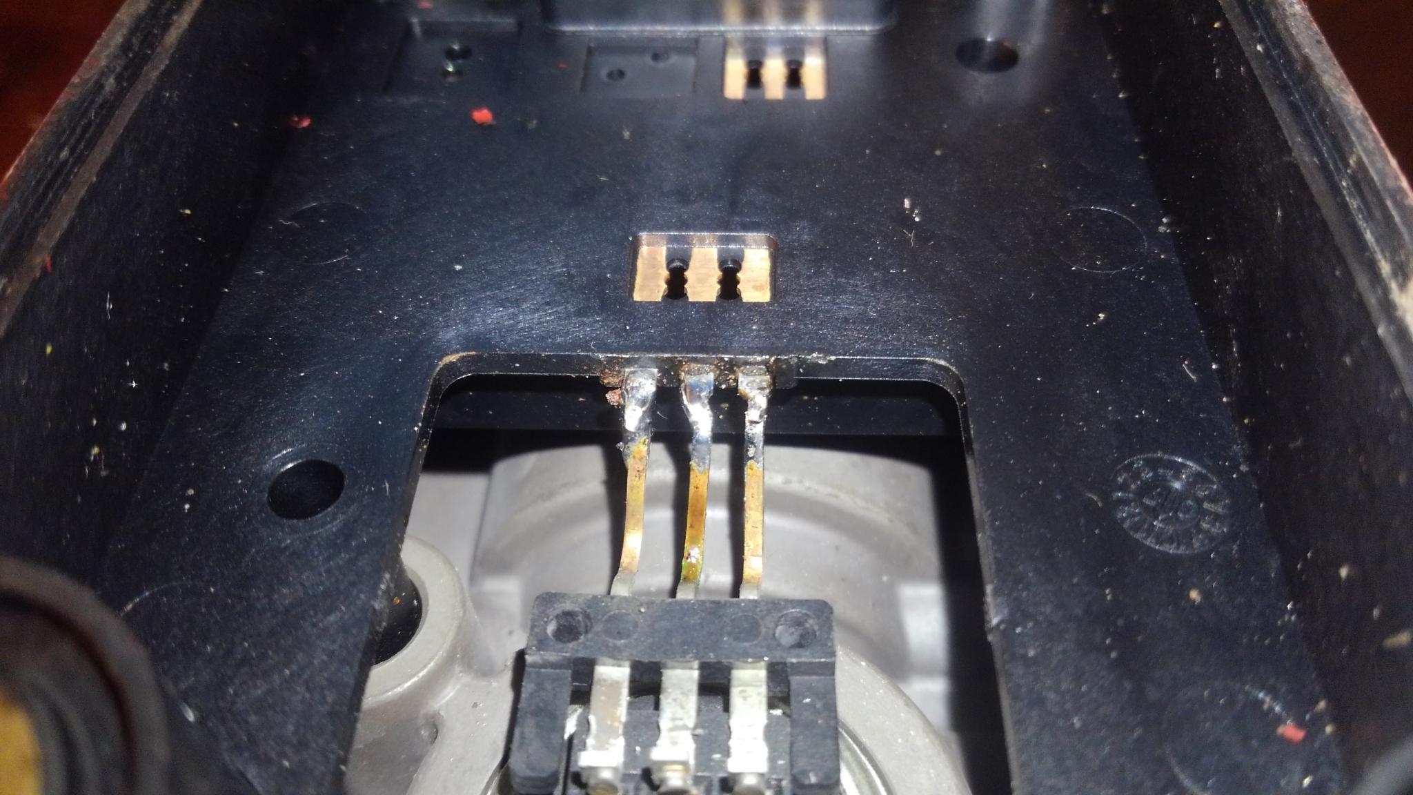

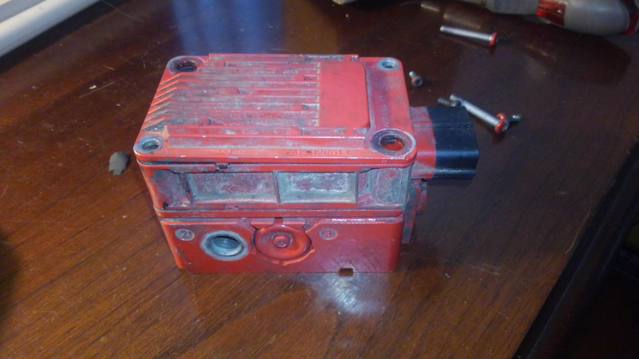

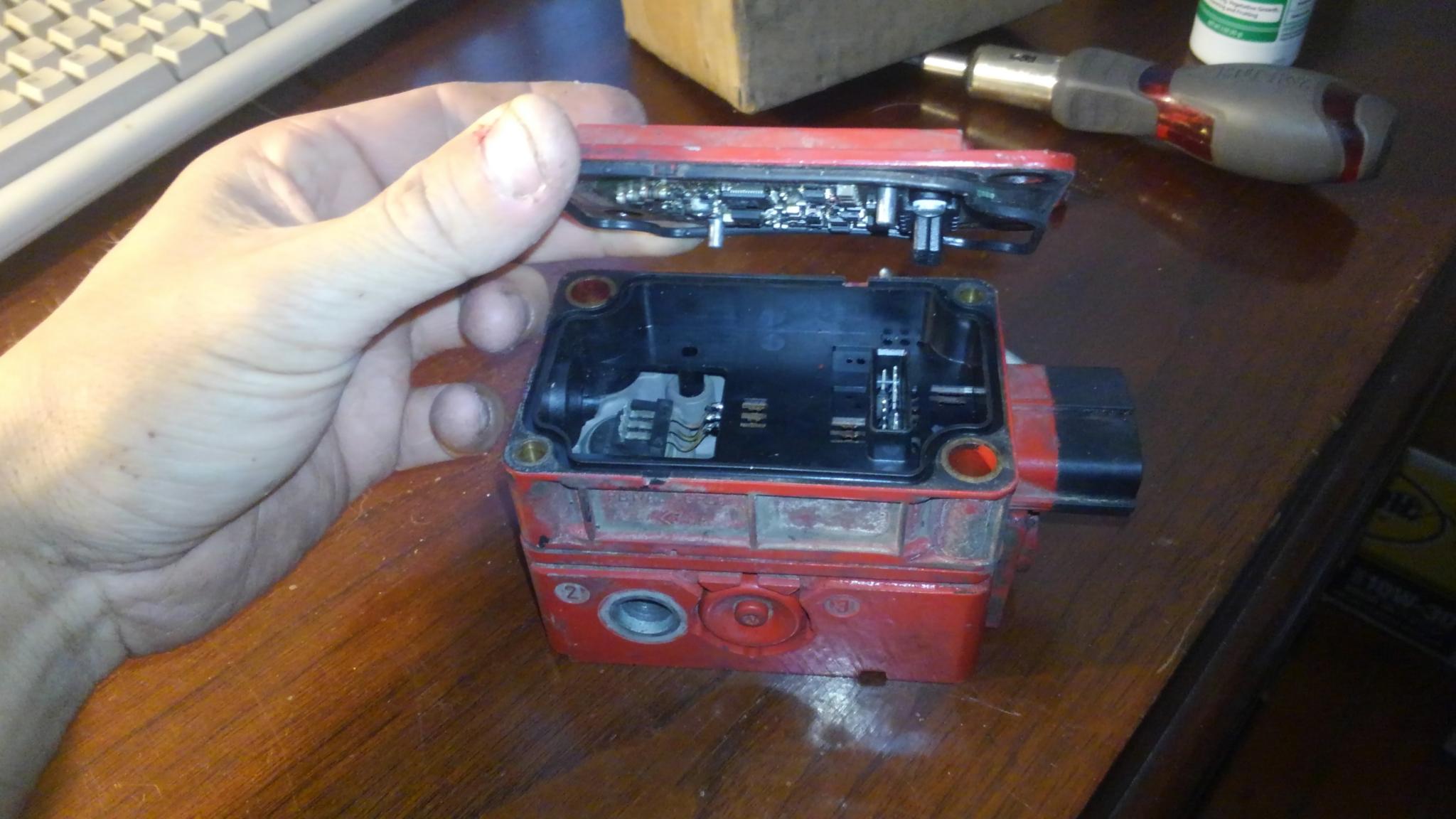

I don't recommend them. I have had 3 of them and all of them went bad. It's really shotty reman and repairs. I have 2 going back in the mail as of today. 1 for warranty and 1 for core. And thats over a 3 year period
[attachment=3656]
[attachment=3657]
[attachment=3658]
Surprise!! Someones crappy solder job. I wonder why it would intermittently work?? Lets see if they hold up to their 1 year warranty.
