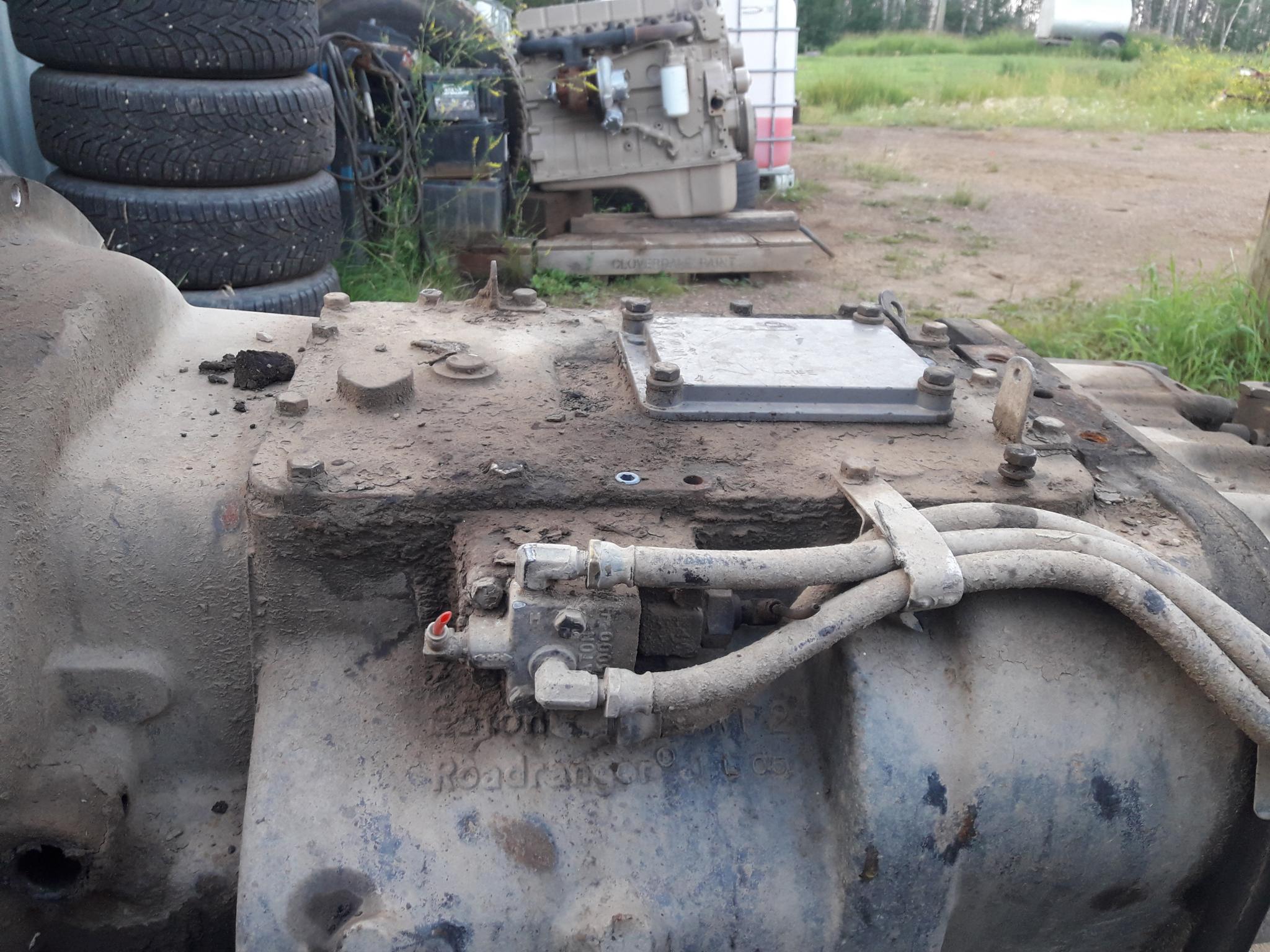

autoshift to manual conversion - Brock - 07-30-2018 any of you ever turn a Eaton autoshift gen 3 into a manual? transmission was rebuilt very recently so I don't want to buy a new one, would rather just convert this one. sick of this piece of cap, been a headache since day 1. any special things I need to keep in mind? RE: autoshift to manual conversion - Starlight - 07-30-2018 It won't work cause the case on the autoshift doesnt have the slave valve on the left side of the tranny. It'll be impossible to convert. The pic shows the valve thats missing on the autoshift[attachment=4099] RE: autoshift to manual conversion - Brock - 07-30-2018 I've been told you just drill holes and mount one. RE: autoshift to manual conversion - Starlight - 07-30-2018 The last gen 3 i worked on didnt even have that flat surface ''block" there. It had a round edge. Would have been very hard to do on the one i was working on but maybe yours will be different. I guess crawling under the truck with a flashlight would tell you if it would be possible with yours or not. Also would have to be machined pretty accurately to install the pin thats located behind it. RE: autoshift to manual conversion - Hammerhead - 07-31-2018 (07-30-2018 )Starlight Wrote: It won't work cause the case on the autoshift doesnt have the slave valve on the left side of the tranny. It'll be impossible to convert. The pic shows the valve thats missing on the autoshift Sorry for the highjack but, Starlight , what exactly is the cream colored object in the background of the tranny pic? Yes I know what it is, I mean is it a II, III, a IV? Does it run? Can it run? Can we play? RE: autoshift to manual conversion - BobsYourUncle - 07-31-2018 (07-31-2018 )Hammerhead Wrote:(07-30-2018 )Starlight Wrote: It won't work cause the case on the autoshift doesnt have the slave valve on the left side of the tranny. It'll be impossible to convert. The pic shows the valve thats missing on the autoshift Looks like a 6CT... RE: autoshift to manual conversion - schISM - 07-31-2018 Hey Brock, sure hope ya figure this one out so the rest of us can follow. I’ve got the 13mhp and was thinking the same thing. Biggest problem I was looking at is clutch pedal and linkage, I was gonna use the tranny for a core on an 18spd. Keep us in the loop and good luck:-) |
