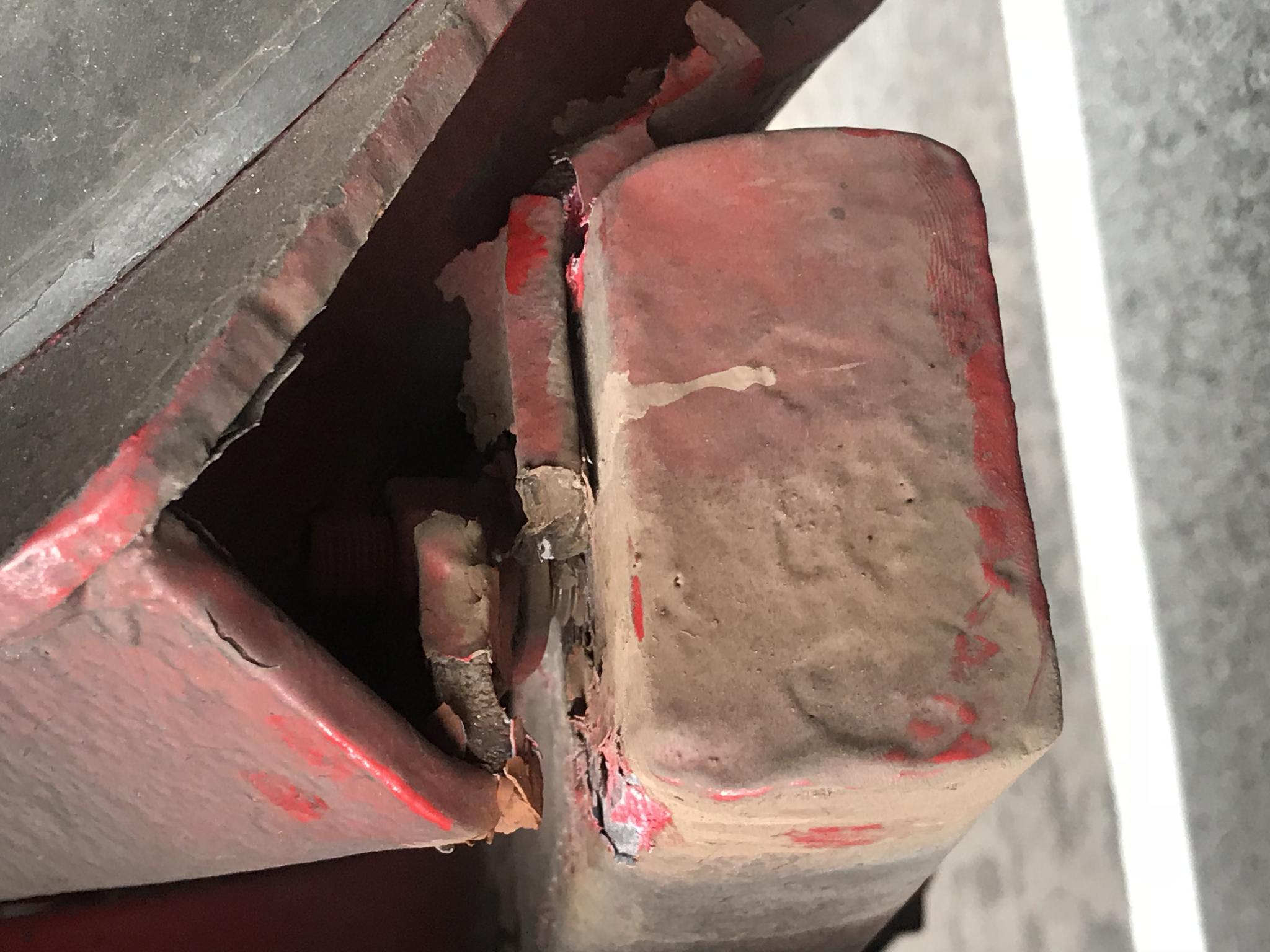

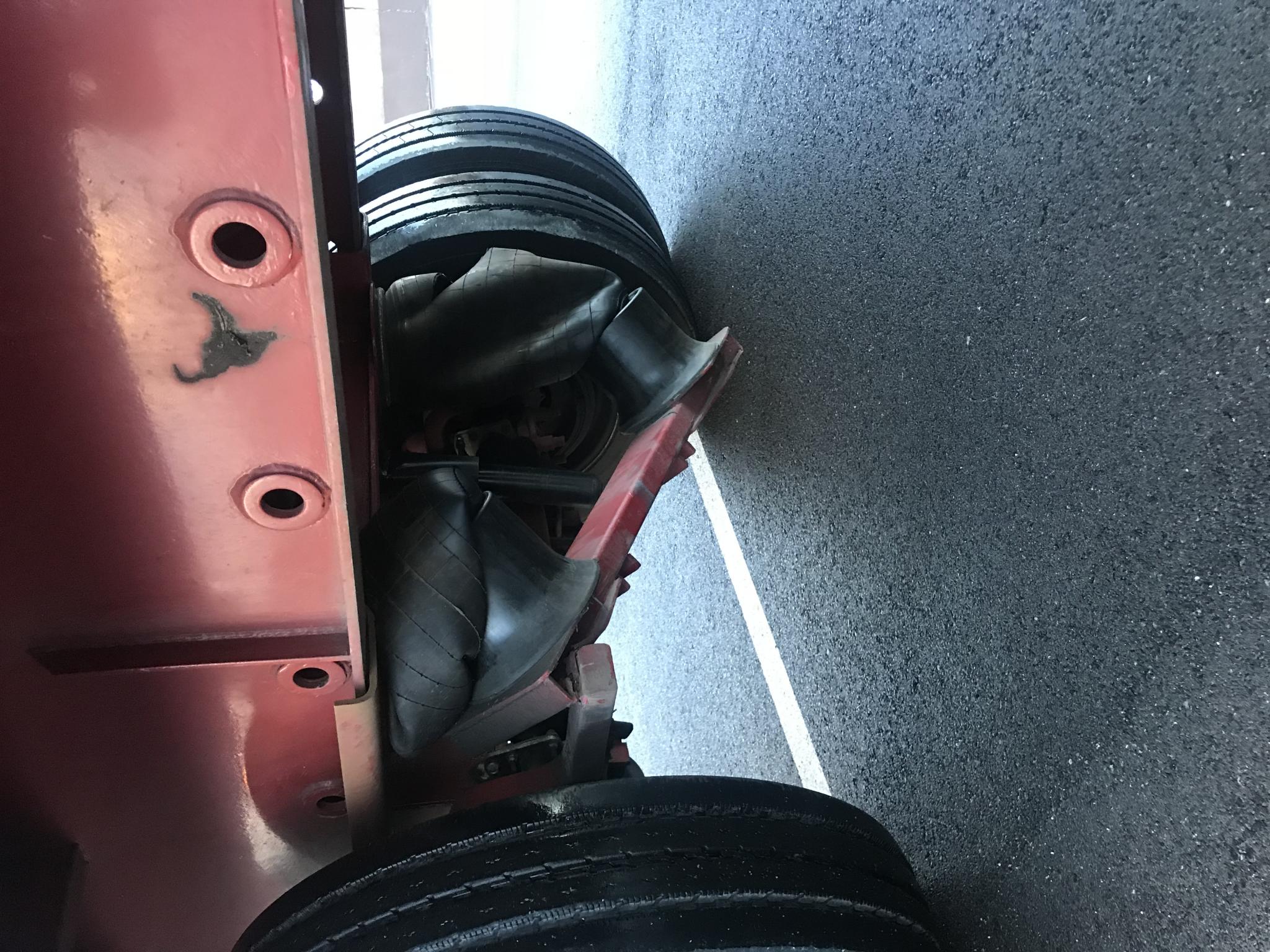

So I bought a trailer from a user on here 4 weeks ago and have already had it in the shop with breakdowns 5 times. First time it was a blown air bag on the front left axle of a spread. The bag bags weren’t getting air. The first shop didn’t figure out that my new trucks middle electrical pin was controlling the dump valve on the bags causing them to continuously dump. But the second shop figured it out and bypassed the solenoid that Controls The dumping so that they would not dump anymore. Then the third problem I had was a rear airbag blowing and when I got to the shop they noticed that all four bolts that connect the spring arms to the beam that holds the airbags were completely missing. So we replace the bolts and an airbag and thought we were OK. Then I brought my trailer to the shop over the weekend just for them to look it all over and they said everything was OK at least they thought, and then this morning in St. Louis another airbag blew on the front axle again and when I stopped I noticed that the bolts on that beam we’re now missing. My question is what could be causing these bolots to break? I think we figured out the air problem with the solenoid but now these bolts are breaking with no known cause. The only thing I can think of is that the bolts that were used previously were not strong enough bolts. At this point I feel like we’re never going to end up solving anything it’s just gonna be one problem after another

I do not know the answer to that question. I do know that the bolts completely sheared off. First the rear 4 and then the front except one. The guy I bought it from rebuilt everything under the trailer himself 2 years ago, used it for 5k miles with no trouble and then it sat for 2 years before I got it and now I’ve lost 3 airbags and all the suspension

Sitting for 2 year dry rotting did nothing good for anything on that trailer. Then running the trailer down the road with thair bags dumped probably pinched and chaffed the bags causing them to rupture. Also running with airbags dumped puts extreme pressure in bad places. You may have sheared the bolts off by doing this or stretched them.
I would start with replacing that final air bag and if there are any mount bolts left that aren't replaced just replace them too. Also take a real close look at the shocks and mounts. Also if it has springs or other suspension parts make sure you give them a real good look over for being cracked or stretched. If you ran very far with a heavy load on with no air in the bags it can do some serious damage.

(08-20-2018 )Chamberpains Wrote:  Sitting for 2 year dry rotting did nothing good for anything on that trailer. Then running the trailer down the road with thair bags dumped probably pinched and chaffed the bags causing them to rupture. Also running with airbags dumped puts extreme pressure in bad places. You may have sheared the bolts off by doing this or stretched them.
All the bolts have now been replaced, and all but one air bag. The place I bought them from, didn’t have another bag. So I will get one when I can soon.
