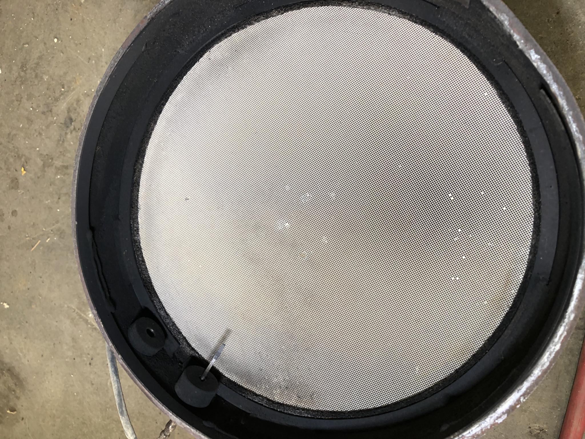

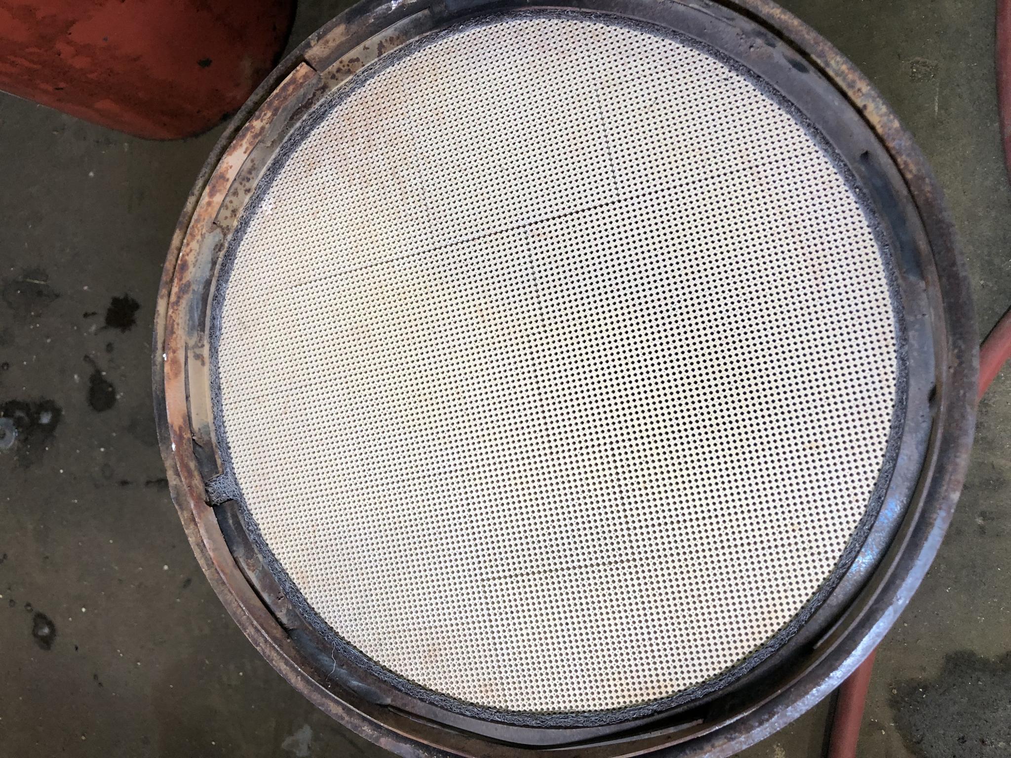

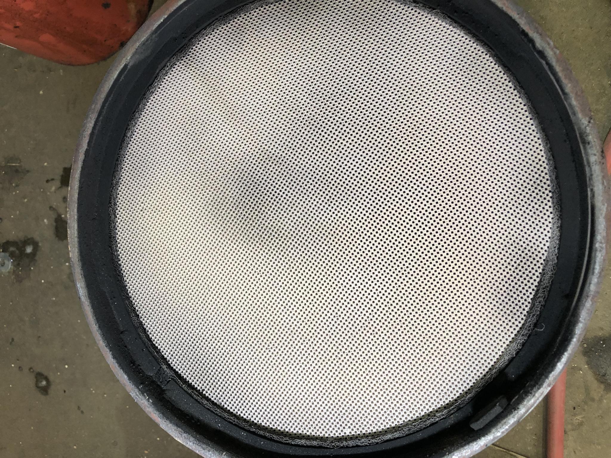

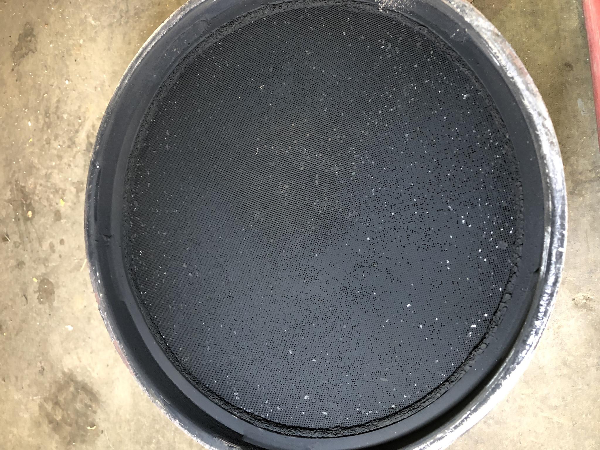

[attachment=4977][attachment=4978][attachment=4979][attachment=4980]They are off and here are the pictures. I’m concerned about the crack in the ceramic on the outlet of the DPF. Also it appears there is metal (I didn’t put a magnet on it) on the face of the well plugged DOC!
RE: CM 871 won’t regen - theironoracle - 05-06-2019
Ok the stuff on the face is exhaust joint gasket material. It didn’t have soot on them and they are not steel.
TIO
RE: CM 871 won’t regen - Rawze - 05-06-2019
DOC looks like it is face plugged by oil intrusion and excess heavy soot.
Other cans look washed out pretty badly.
Rear of DPF is cracked in several places because heavy amount of moisture got in it at some point.
