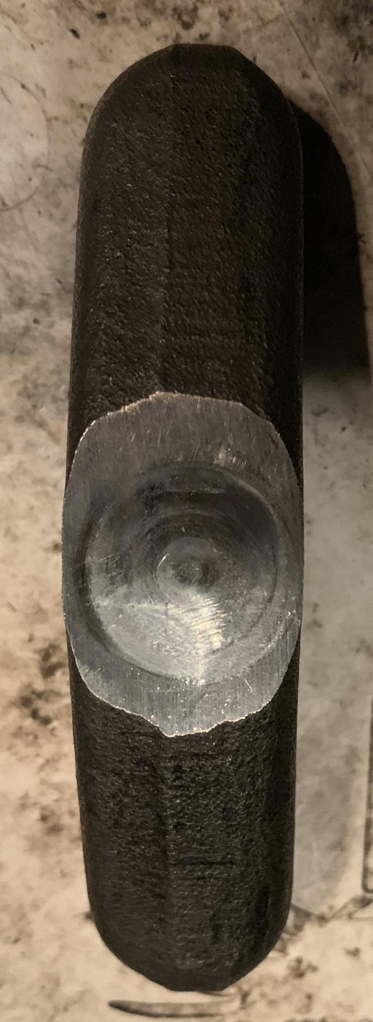

Rawze check out Cylinder 1 valve bridge:
[attachment=5033]
[attachment=5034]
We end up putting a thinner valve bridge in Cat Part# 363-3731 gave us our 0.015 adjustment. Started her up, rev’d up to 2100rpm held it few seconds no popping or smoke. Runs like a dream again, gave her a new lease of life so let’s see how she goes.
RE: C15 6nz Valve Recession? Valve Adjustment - Rawze - 05-23-2019
(05-23-2019 )multitask Wrote:  ...
did you boroscope it and check for excess valve recess? http://rawze.com/forums/showthread.php?tid=1632&pid=18718#pid18718
