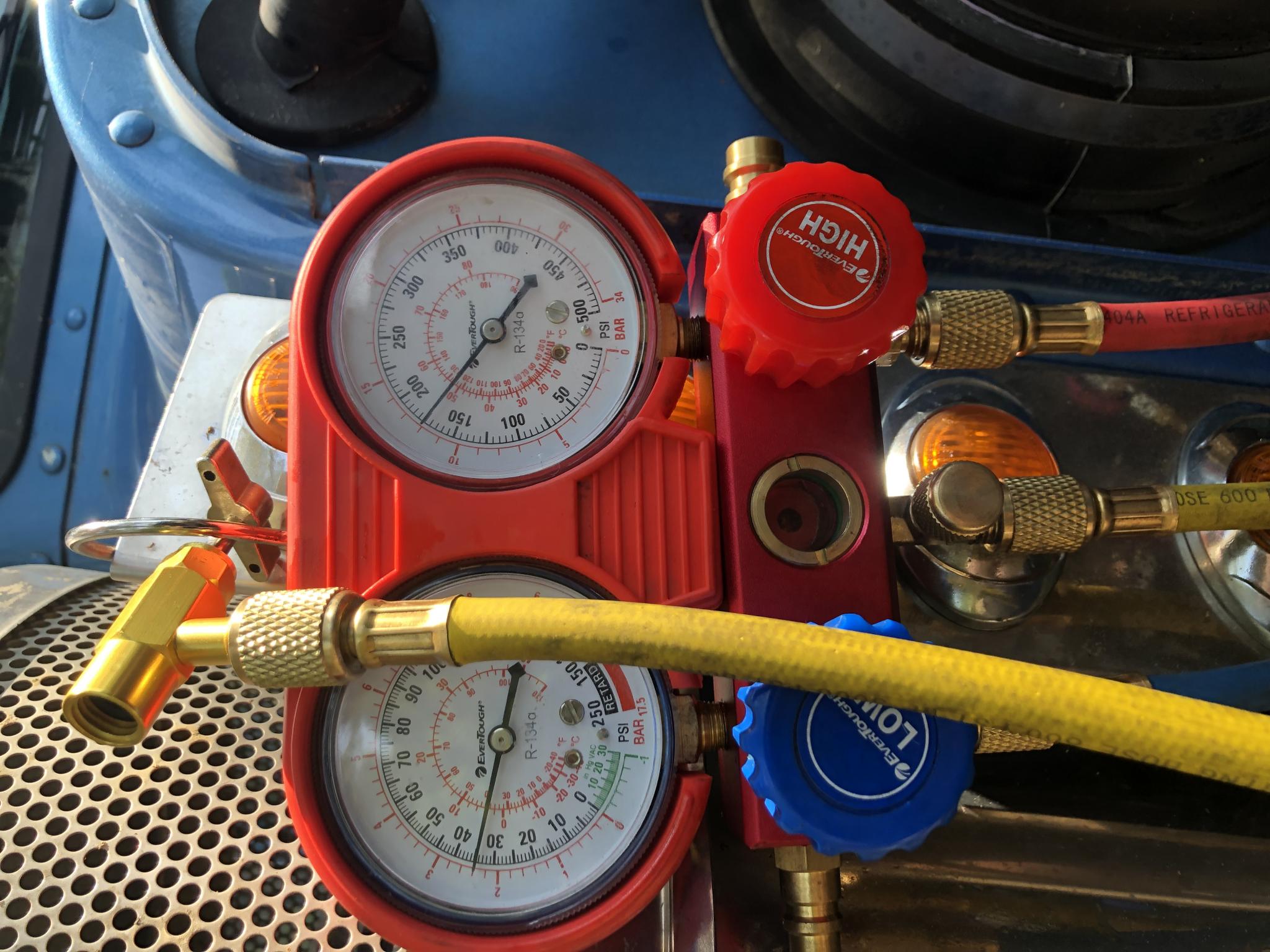

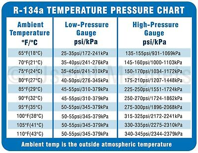

Does anybody have different chart or other experience with these Sanden/Bergstrom systems?
[attachment=5123]
If these pressures are where I'm supposed to be then it's time to whip out the parts cannon.
[attachment=5124]

Ideally you want 15-20 psi low side and 150 ish high side while running at 1000RPM max cool. If you let it sit and equalize it will be very close if you take whatever temp it is outside in Fahrenheit and thats what you pressures should equalize too.
Excessive low side means overcharge, low low side means undercharge or a plugged orifice tube or Expansion valve. High high side means overcharge, or the fan/cutout isnt working, or the condenser is blocked. Low high side means undercharge, too much cooling, or a stuck expansion valve.

Moose , there’s one chart for R134 and doesn’t matter who’s name or brand is on the label.
The one on the picture is for stabilized sistem with adequate air flow thru condenser and evaporator/s at given ambient temperature.
What's wrong with your sistem ? Simptom/s ? Talking parts?
Be more specific and detailed when lending a question.

The only testing literature a have is from a KW diagnostic on how to test and what center temp should be given ambient temp/humidity. Those numbers in the picture were at 1400RPM, max blower, fresh air, fan on, 90deg ambient with 50% relative humidity. The center vent temp was 72deg. The coldest I can get it in similar conditions while operating the truck at lower speeds/normal is 62-65.
This is a '14 389 with a 36" sleeper without rear air. It has a two-speed Horton fan clutch. Condenser & evap cores were cleaned prior to testing. Numbers at idle were 50 low & 150ish high.
I just feel it can do way better than it is. center vent temp will rise to 70-75 deg at idle and after a few rises like that it just becomes woefully inadequate. As far as I know it is all original. What bothers me is even if I replace the TXV, compressor & switches it seems that this 389 won't do much better than this but my KW could get down to 40-45 degrees.
