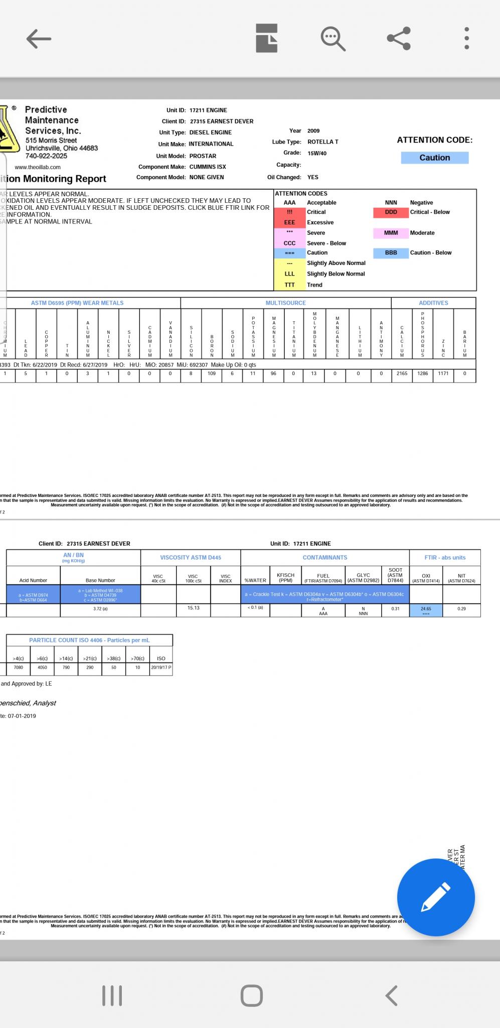

Oil sample results? - earnies2 - 07-03-2019 Can someone help me read this report....? RE: Oil sample results? - uncleal13 - 07-03-2019 Take another snapshot, can’t read what iron is at. Lead is beginning to show, maybe caused by silicon being somewhat a bit above what I would like. Could be a sign of a leak in the air intake system after the air filter. |
