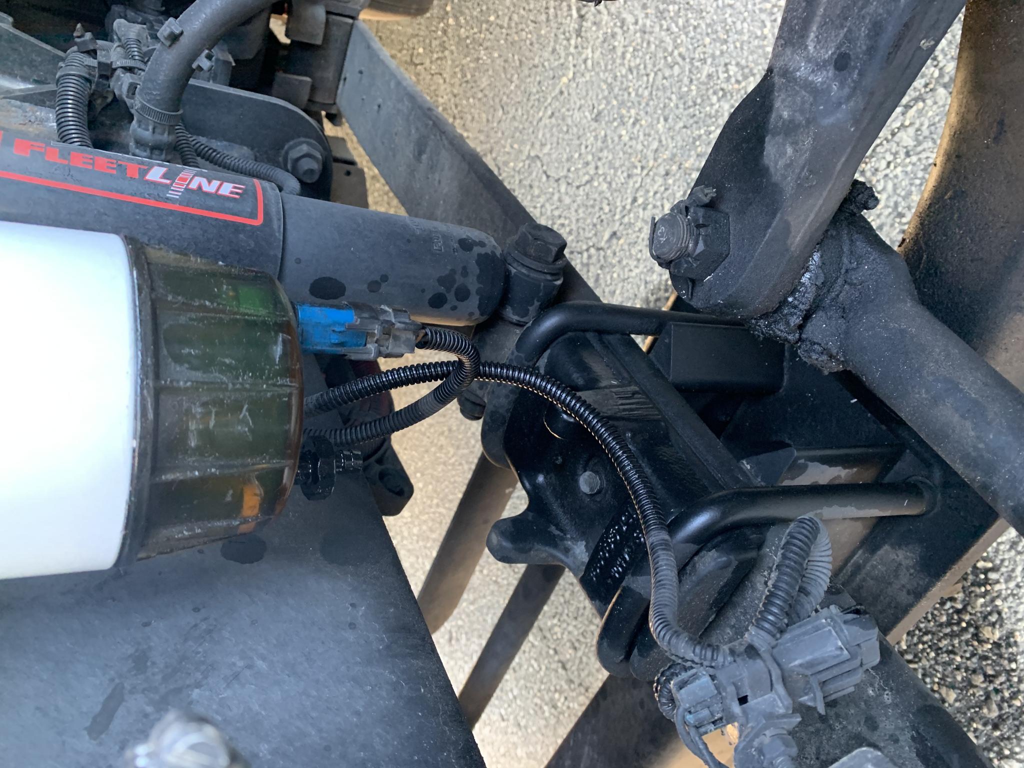

I have a wonky filter, it has a small plastic cup on the bottom that screws into the filter. I should’ve cleaned the sensor, but that never occurred to me. The fuel is green in the cup right now, but I’m concerned about the yellow color of the fuel I took out.
RE: Water in fuel - Explosia - 10-26-2019
[attachment=5630]
