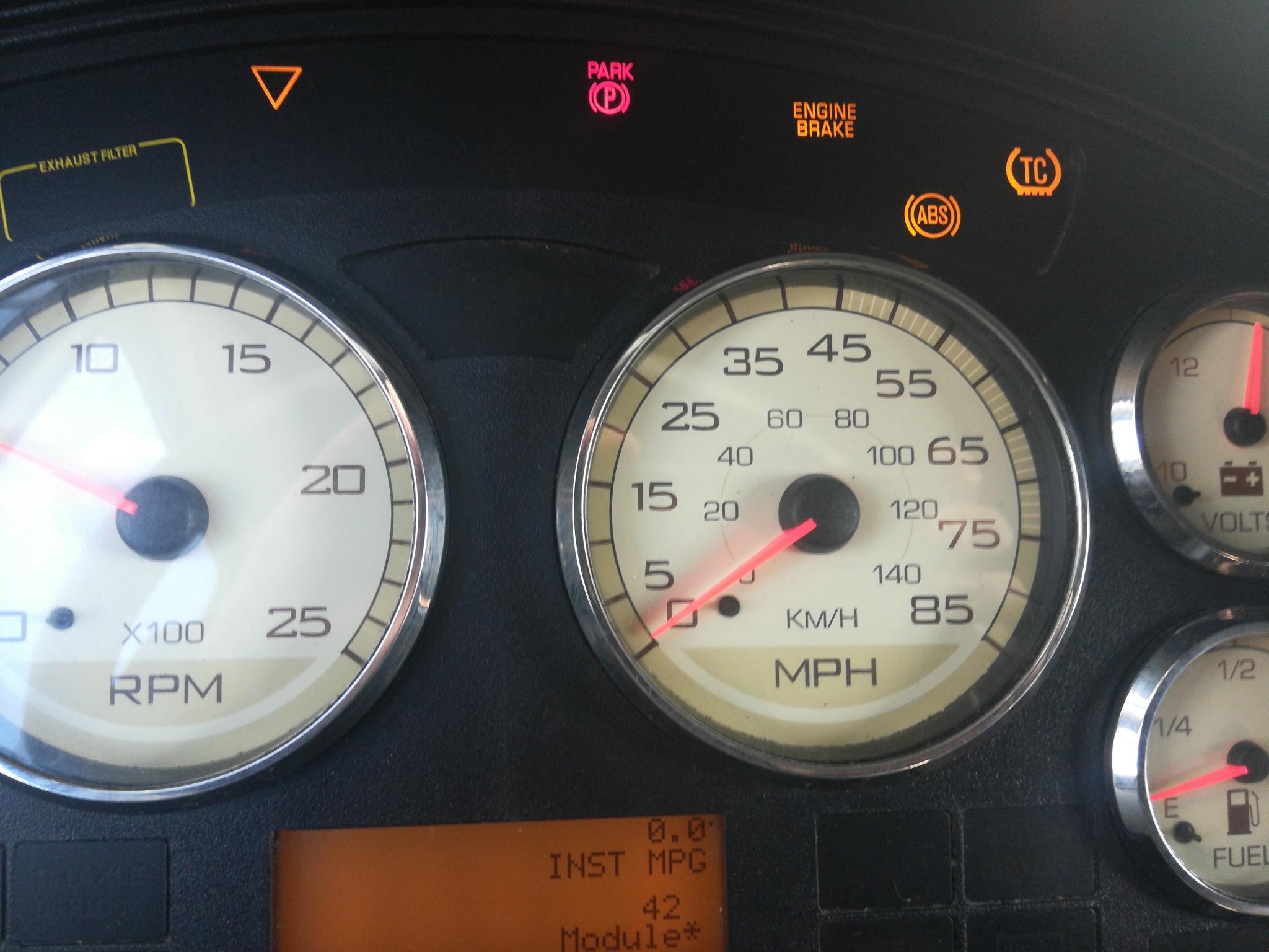

42 module ABS TC and orange Triangle on dash. This was triggered when someone changed lanes in front of me. I can't get it to go off, I tried cutting power off by door, nothing
Also when I press the brake I hear a click noise located near middle of dash.

I would get under the truck, start inspecting the brakes and the ABS lines and even the tone rings. Could just be dirt and a good power washing is in order, or a blown wheel seal gumming up the works. Best bet, get under there and visually inspect and go from there. You may need a hand, someone in the cab applying the brakes while you get under there. Take a small pry bar or decent sized screw driver and poke around. Check the pads and linings, etc...
Also, look at your pin bushings for the rear suspension and the torque rods up between the frame rails on the rear drives. Any odd or uneven wear on the drive tires? You will be back there, good time to look.

btw. your out of fuel too. Running around with fuel tanks that low is only asking for algae and moisture in fuel problems all the time, especially this time of year.

Those were the same lights that went off when my compass module failed too... Do you have a functioning compass on the small LCD screen in the photo, where your odometer is read? The N, S, E, W will be in the lower left corner of that LCD screen. If it is not showing up, It could even be your compass. The ABS, Exhaust Brake and TC are all routed through it. It was a $400 part when I replaced mine. It is located in your fuse panel in the passenger side dash. Open the fuse panel, skim over the top of the fuses to the actual dashboard plastic, you will see a black cover with two screws holding it in, say 3/8" x 3", that is your compass. Remove the two screws and pull it out, it is just a $1 circuit board with a plug. Welcome to ownership.

Well, at the very least you need the brakes visually inspected. To reset the codes if everything looks ok under the truck, pull the battery cables and let sit for 30 minutes, that will give you a hard reset and possibly clear out the codes if everything checks out underneath.
When a truck sits, you are going to have all sorts of issues like this until you can go through all of the systems and get them back in working order. If this is a fleet truck, and it sounds like it, the bare minimum was done to it, now it is your problem. Run it after inspecting the brakes if nothing is found. Could just be an electrical glitch or even the compass.
