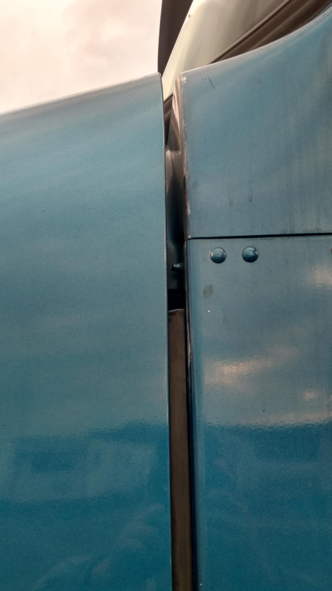

My hood is striking the cab when you hit a dip in the road or say jumping up on a bridge or falling of the other side of a bridge.
Have adjusted the hood seats up about as far as they will go I think. Will still hit each other sometimes. Replaced cab shocks, cab sits level so I don't think it is because of the cab air bags making the cab ride high. Side note T660 cab shocks are a pain to change. Most trucks have shocks on back of cab. But no Kenworth thought it a good idea to put them up under the sleeper, and to make it even better the bolts holding the shocks on are in backwards. The bolt hits the air bag before you can get the bolt out of the shock. You can bet I put the bolt in from the other direction when I changed the shocks.
Just from looking at other trucks like mine some show signs of the hood smacking the cab and some don't so??
Anyone know what I need to do to stop this from happening?
I have about an inch gap between the hood and cab when sitting.

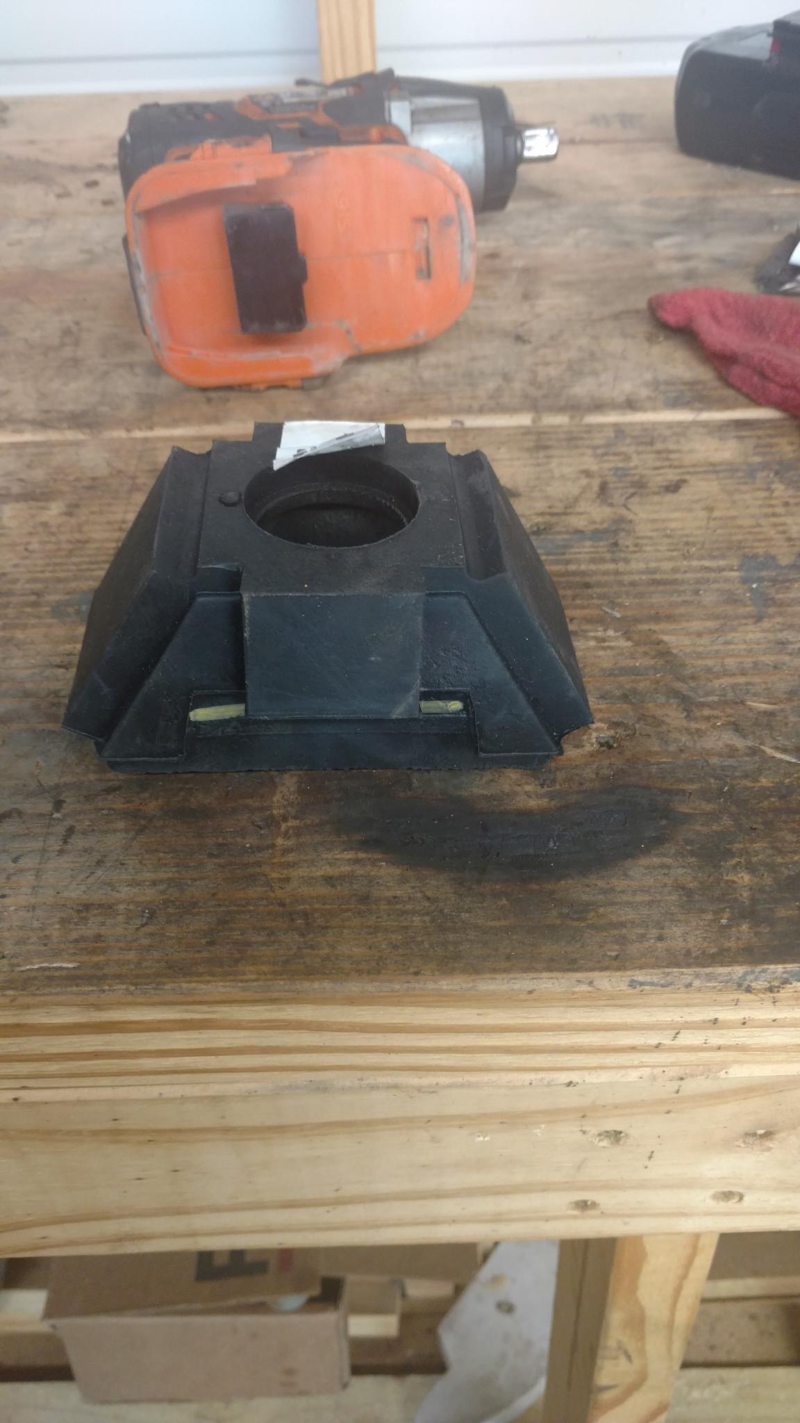

Replaced drivers side cab mount. Not fun at all. The one I took out didn't look too be worn much. Tried to do passenger side but gave up when I saw that the coolant hoses for heater cores was not going to stretch. Cab has to be raised at least 2.5" to get mounts out.
Replaced my hood pin bumpers and adjusted them. Hopefully this will stop the hood from smacking the cab.
Picture of what cab mount looks like. Kenworth isn't easy to work on.

Those are the same as a w9's and they do look way better than mine did. mine were just flat on the sides. as i do alot of dirt road's it just beat them to death so i don't think they are your issue hope the pins work for you.
