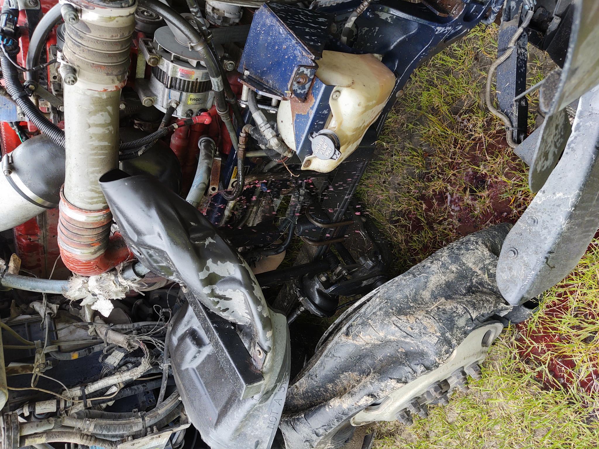

RE: Run them or replace them? - dhirocz - 06-25-2020
I blew a steer yesterday with no warning. Luckily, I don't drive against the speed limiter, and it was still a bear at 55 to keep her upright. Ended up in some soft soil on the side of the road in danger of rolling over.
I managed to get it into some pavement, replace with my spare and drive it home to preform repairs.
It cut the main hose running to my overflow tank, destroyed the fender liner, cut the brake chamber air hose, punctured to washer jug, pulled the alignment out, tore up the wiring to the right headlight and cracked the cold side of the turbo housing. I'm not sure if I have to replace the wheel or not yet but I'm leaning towards that too.
All of that and they looked fine and we're properly inflated. 283a's at maybe 100k. If you aren't sure just replace them.

RE: Run them or replace them? - Rawze - 06-25-2020
One blew on me last year. R283a Bridgestone... it was less than 3 weeks old and yes, it was inflated properly. it did a huge bunch of damage to the front end of the truck including taking out the entire A/C box, fender, bent side step, cracked hood, and all.
- Seems to be a trend with that brand and model tire here lately, as I have run that same make.model tire since my truck was new, replacing them about every 180k or so at a time without any issues otherwise.
