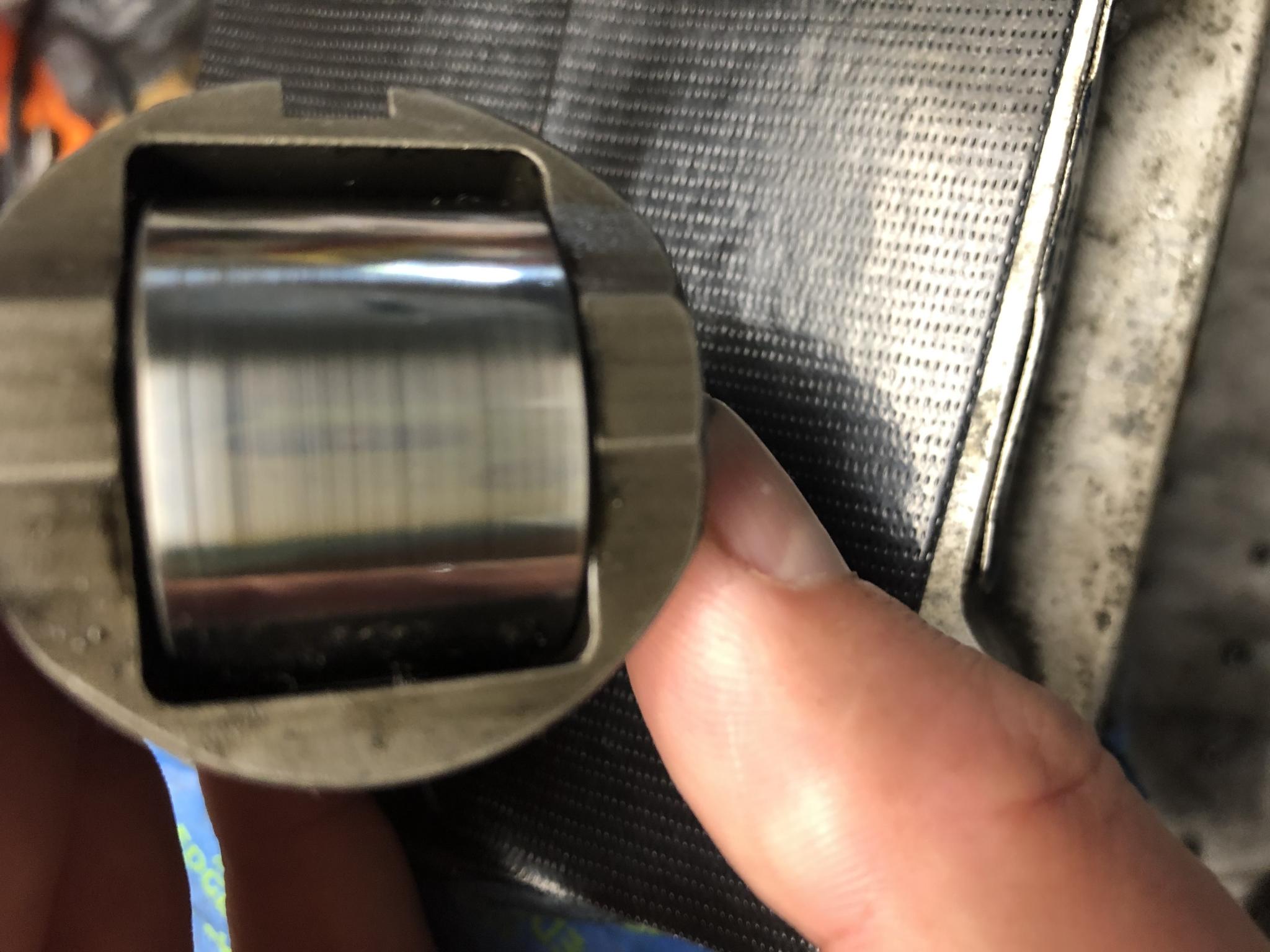

Meanwhile, what do the roller surfaces look like? How about the lobes they roll on?
RE: Pulled fuel pump head and broke a bolt - Meanwhile - 07-30-2020
The lobes look ok to me, I don't have anything to get in there with to look closely. I don't see any grooves on them. The roller on both tappets look about the same, some wear. I wrote the numbers down that are on the pump and called the Cummins. The guy I talked to said that with that number he can tell that that pump HAS been changed at some point.
Heres a picture of a roller
