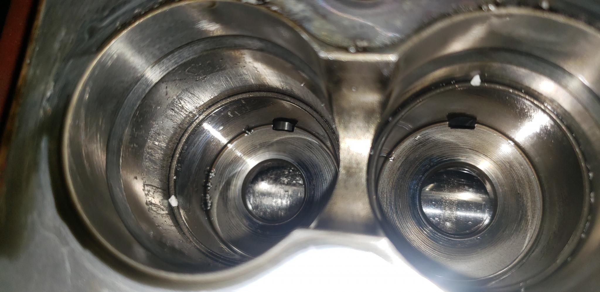

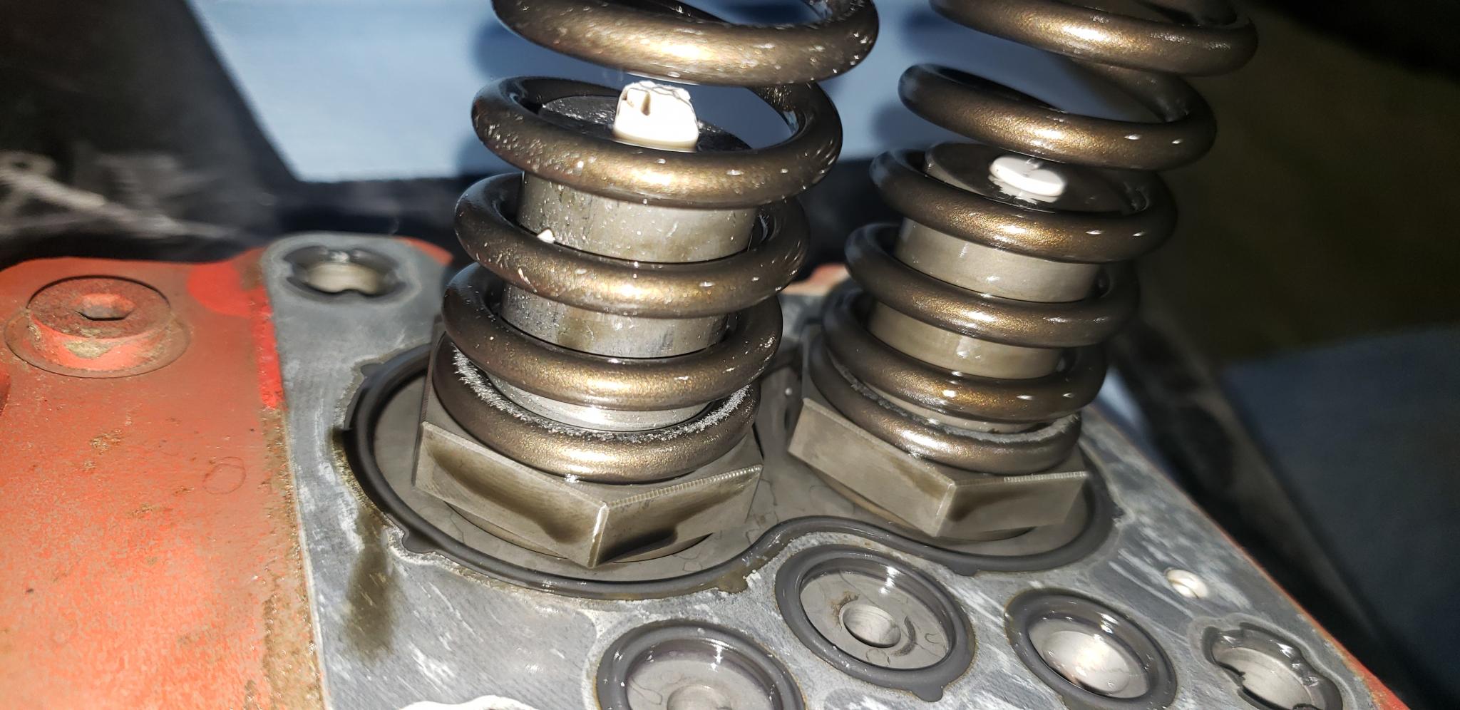

Finally got back to working on this truck. Pulled pump off pulled head from pump. I cant believe how fast I was to put them blinders on on this one
RE: isx12 cm2250 fuel pressure only builds if injector harness is disconnected - tree98 - 01-07-2021
Oh no
RE: isx12 cm2250 fuel pressure only builds if injector harness is disconnected - JimT - 01-08-2021
unfortunately an all too familiar sight :(
RE: isx12 cm2250 fuel pressure only builds if injector harness is disconnected - Rawze - 01-08-2021
Odds are in favour of the engine failing again (chewed up cam, gears, or crank, spun bearing, excess blo-by, etc) if it even survives this.
When mr. hag's shop gets one like that, even if the engine can be saved, it takes flushing the engine block at least 5 or 6 times with a mix of diesel fuel and oil +++ replacing all the crank,main bearings, replacing the oil cooler with a new one (you just cannot get the shavings out of it properly), and giving everything else a thorough inspection. -Even if it can be saved, that engine is going to have a short life before cam goes out, rockers start going bad, and all sorts of other issues.
Maybe he (mr. hag) can chime in and give some more detail if he gets a chance. He has had to try and save several of them when that pump fails.
BTW: That pump definitely was original .... still has the old ceramic style plungers in it and those type of plungers, the material that flakes off is severely destructive and almost impossible to get out of the engine, where it will continue to do damage even after all repairs and flush, etc.
