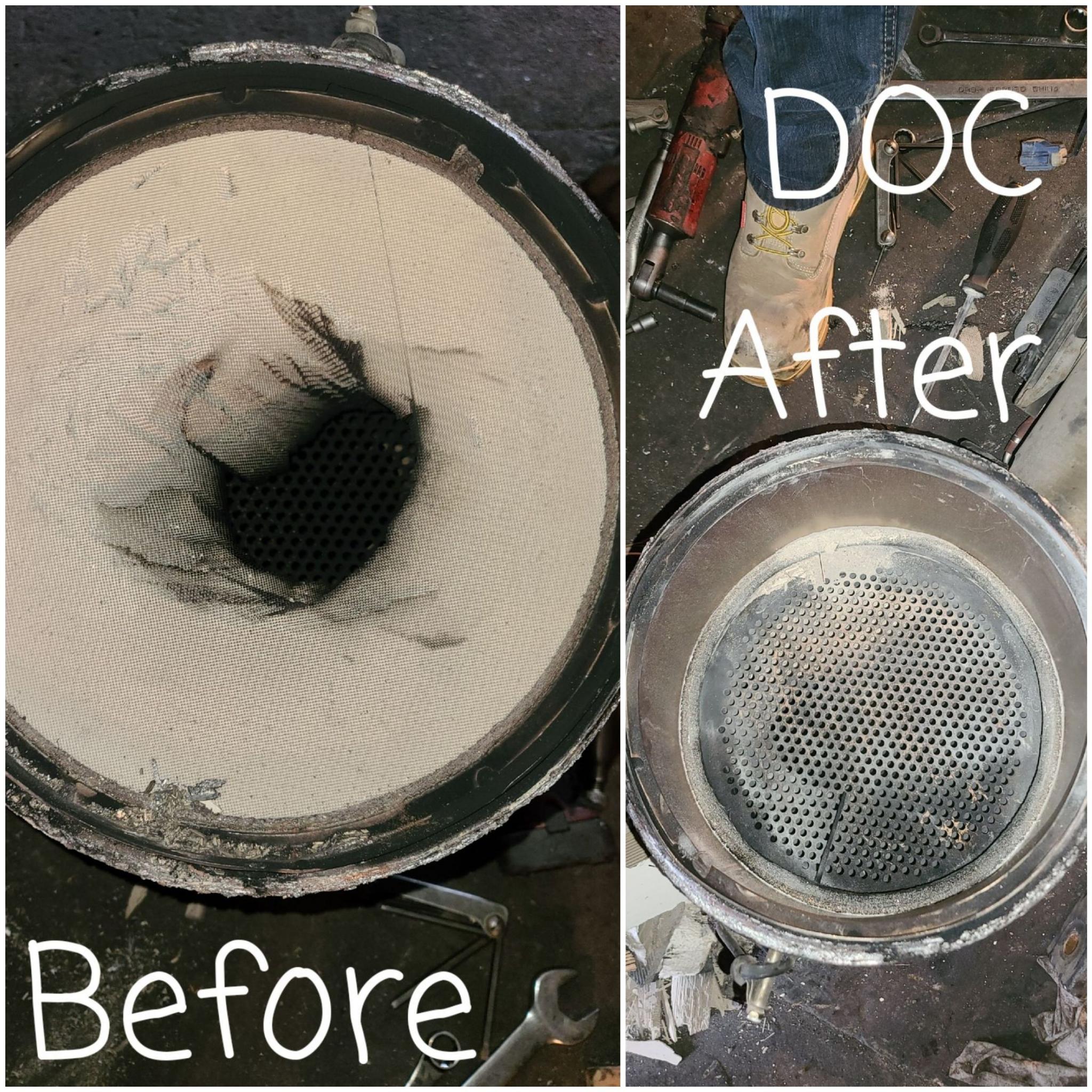

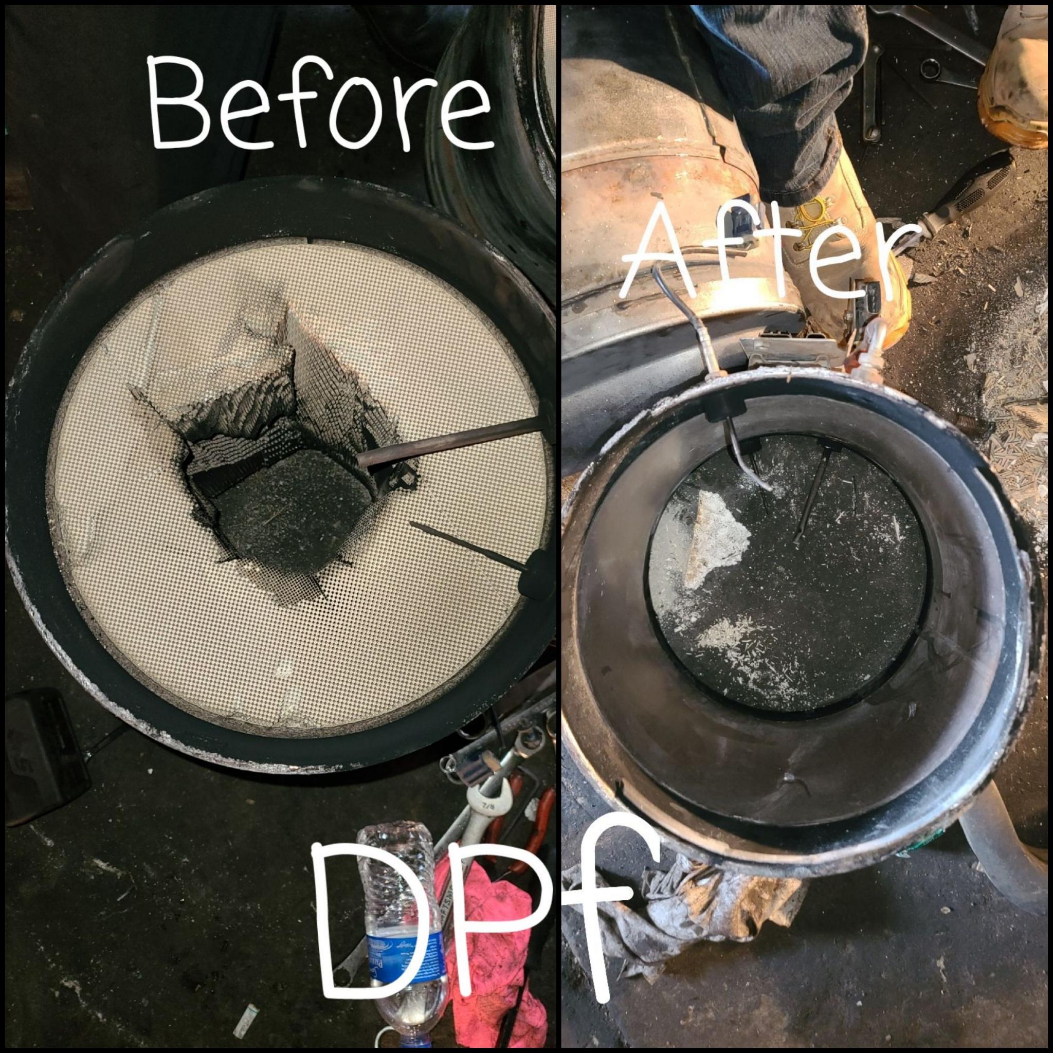

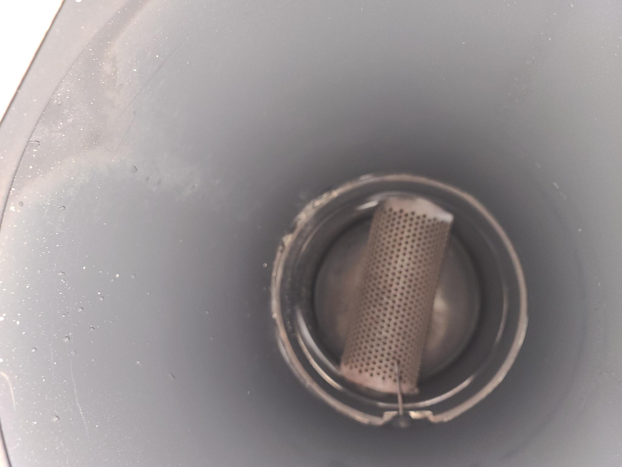

We took off the Cans to get them hollowed out. To my surprise the only one that was hollowed out was the SCR Can, the others had a hole on them maybe 4-5 inch in diameter. I'm attaching before and after photos for your entertainment. That's what a $2500 "delete" around regular shops buys you.

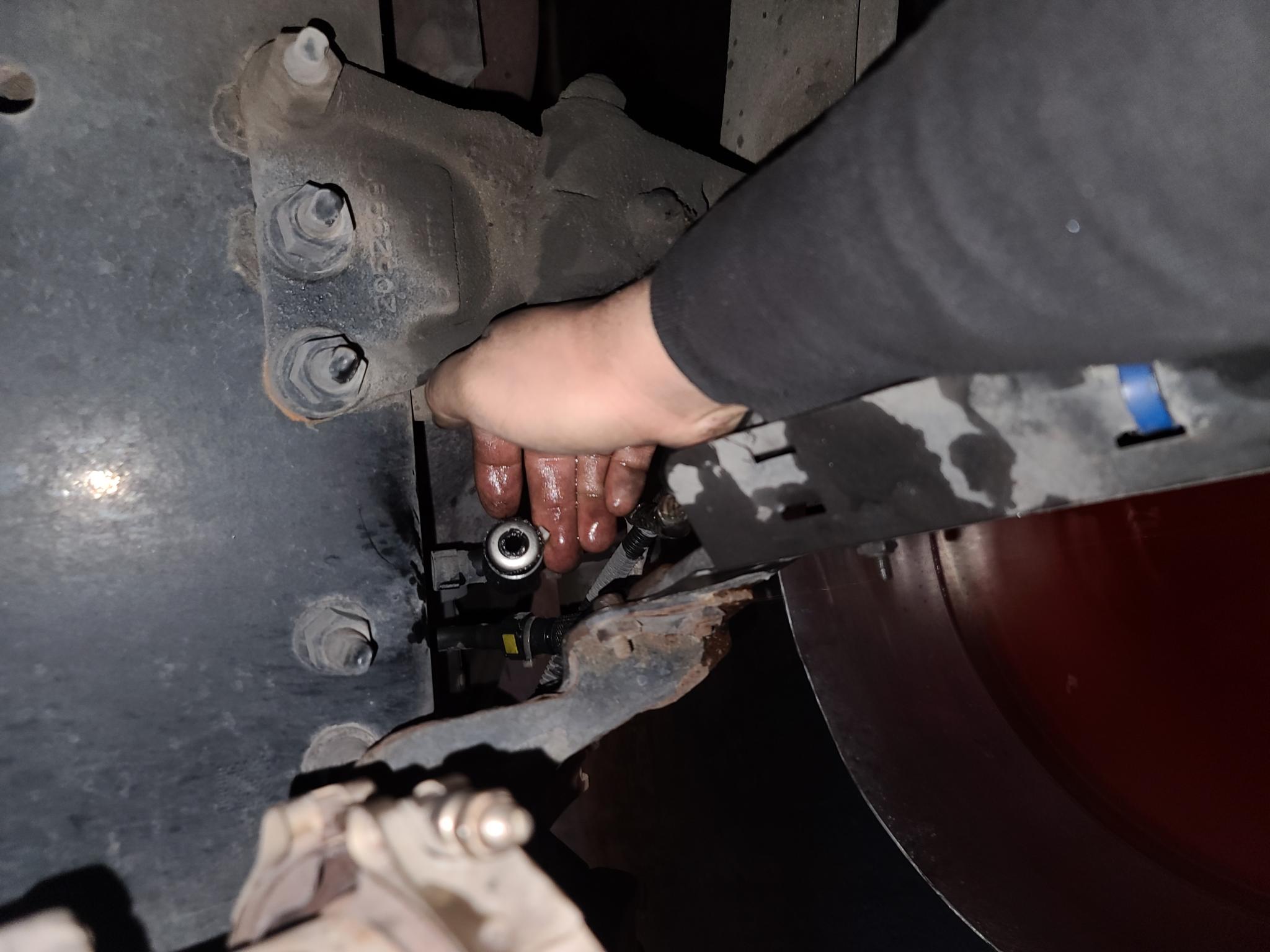

On the last picture, I broke a coolant hose when I was taking of the SCR. I think it goes in to the Decomp Tube? Should I replace the hose to get it back to how it was or can it be clamped off(cancelled)??

If is all hollowed out , the 2 coolant tubes is not needed. can be capped or bypassed.
