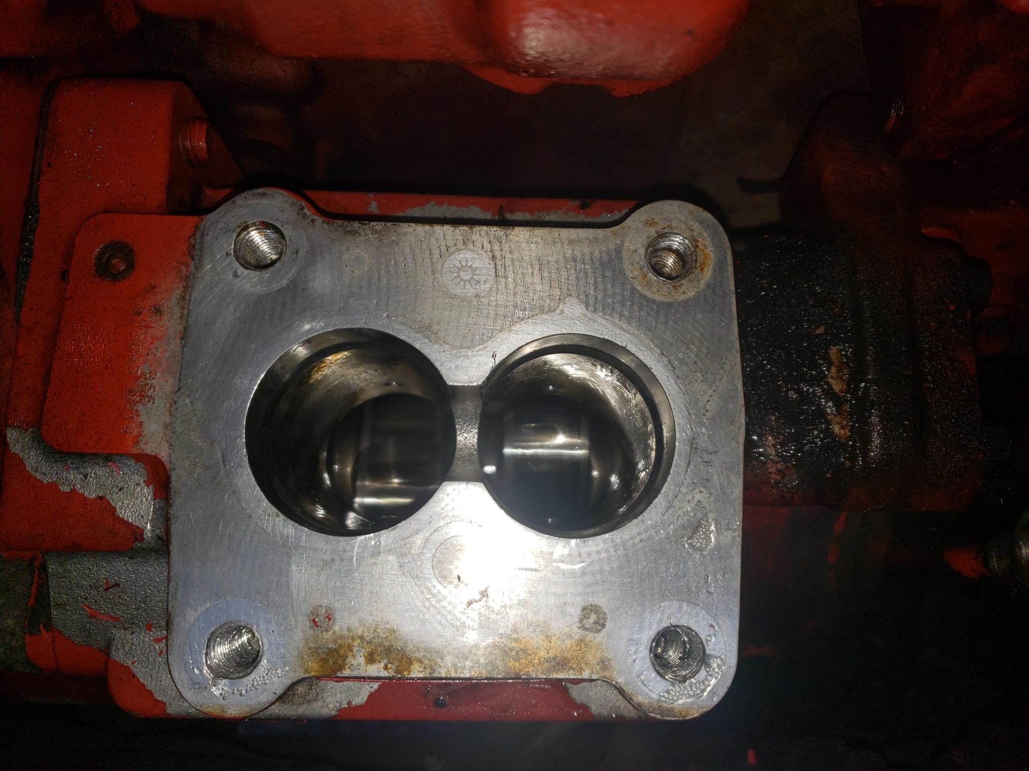

(01-12-2021 )Rawze Wrote:
(01-12-2021 )medseg2003 Wrote:  I just took the fuel pump head out and guess what it has that ceramic plangers they r not broken or damaged also i can see nothing on tappets they r smooth and free of any damage, i am concerned about fuel pump head i put some air pressure using air pump one of them move up and down and the other is not moving at all do you thing it s fuel pump head need to be replaced? Or just barrels and plungers ? Thx
You need to go play the lottery.... you have gotten VERY VERY lucky .. that pump head was built before may of 2013... it is that old.
REPLACE the tappets, plungers, and barrels/rollers ... a set of all 3 ... I.E.> all the guts above the pump crankshaft.
By taking it apart, you just saved your engine's life... and if one of the plungers is not moving freely ... then it was right on that very edge of cracking, flaking, etc.. and destroying the entire engine.
I am replacing part now, it looks like 1 tappet goes deeper than the other .both of them are locked on the pin so when i try to put back head pump with barrels and spring back to the pump it doesn't go all the way throughout because barrel and spring in the right side touch the tappet first before the left side barrels witch make a gap between the head pump assembly and the pump do i can just keep tightin bolts i am afraid to break the bolts t have attachedpictures showing what i have done
thx rawze [attachment=7389][attachment=7389][attachment=7389]
RE: Cascadia shut off randomly and turns back on while driving on the road - Rawze - 01-15-2021
(01-15-2021 )medseg2003 Wrote:  I am replacing part now, it looks like 1 tappet goes deeper than the other .both of them are locked on the pin so when i try to put back head pump with barrels and spring back to the pump it doesn't go all the way throughout because barrel and spring in the right side touch the tappet first before the left side barrels witch make a gap between the head pump assembly and the pump do i can just keep tightin bolts i am afraid to break the bolts t have attachedpictures showing what i have done
thx rawze
Follow the procedures on quickserve.cummins.com on how to do this job. Quickserv is free so if you don't have an account there go sign up and you will have everything you need to know about your engine including all procedures, part#'s and drawings like this.
There are also quite a few forum members on here who have done this job for themselves.. maybe they will chime in as well.
here is a related video that may be helpful as well.
https://youtu.be/-Gu5Eyx2SWw
