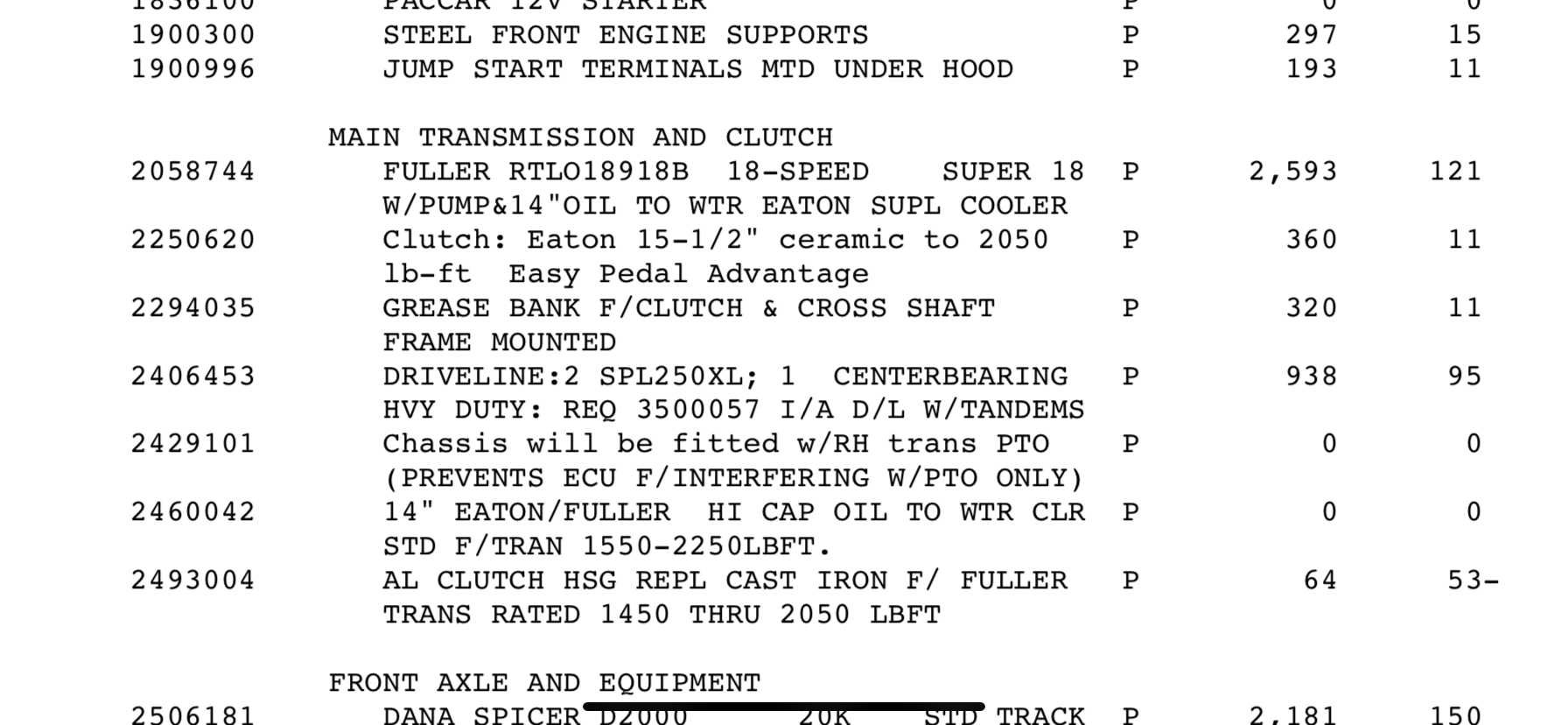

I attached the build sheet for the transmission
