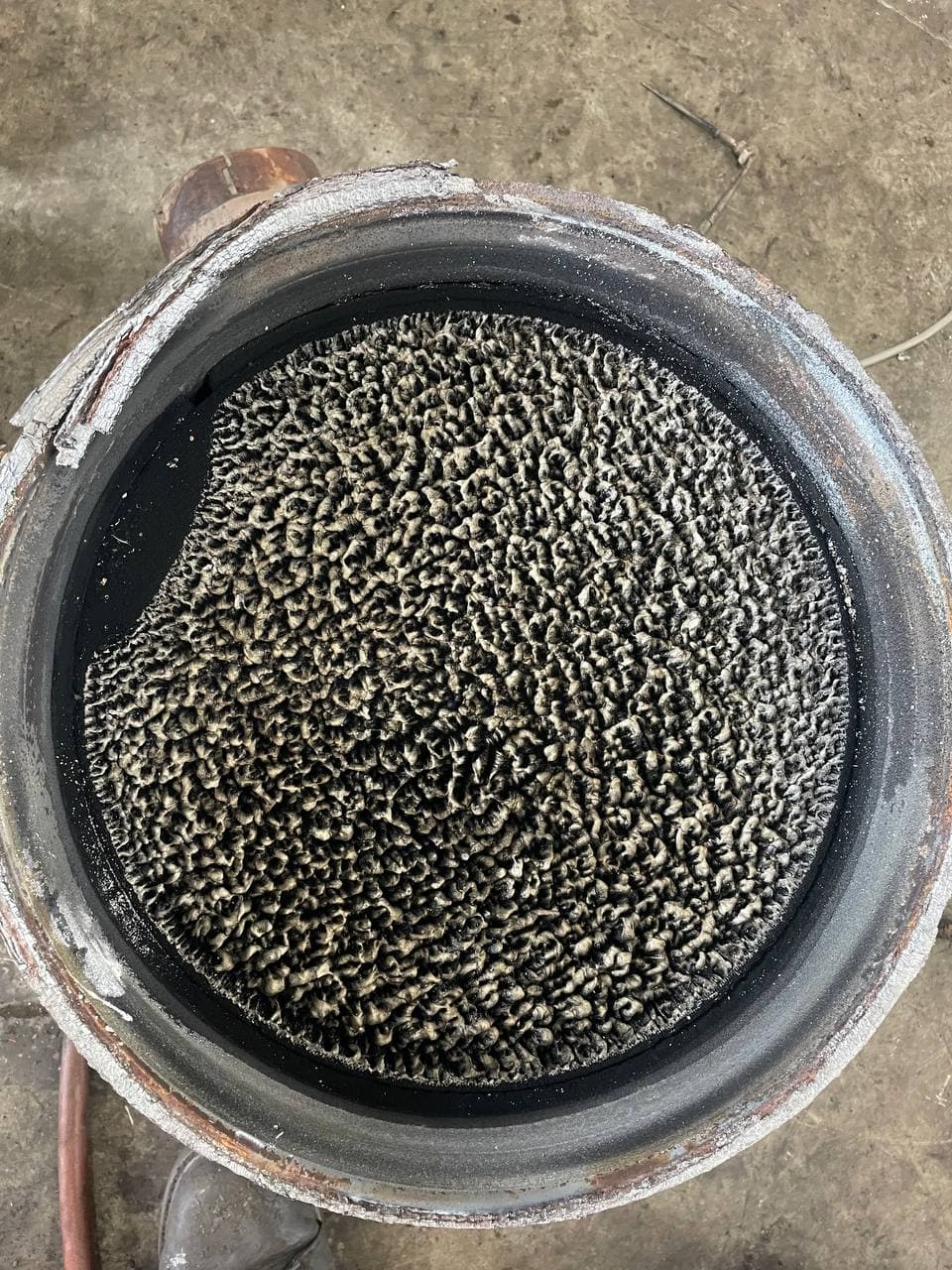

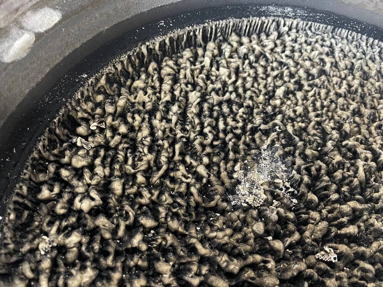

This is from a 2018 X 15 With 176,000 miles
What caused that? Turbo failure?
We are not even sure at this point. We towed the truck here Were told it was overheating. It had a misfire code for a injector. And it had a hole in the flex pipe after the turbo. It ran fine once we unhooked the exhaust. So I can’t believe the engine doesn’t shut down before this happened but it may have been a combination of things. I wish we could get a better story on the truck. Supposedly it had a problem And was at the dealer for three weeks and they said they can’t find anything wrong

looks like leaking Doser injector to me.
Fuel accumulating in the unit and then igniting when the truck hits a hard pull.
that or oil from turbo slobber, or leaking valve guide seals accumulating then igniting.

(09-24-2021 )eggtrucks Wrote:  This is from a 2018 X 15 With 176,000 miles
Does this engine idle a lot? higher RPM idle?
There's a TSB out from Cummins in spring 2022 about trucks melting the aftertreatment modules, Cummins recommends an 800-900RPM idle now. This is in direct contradiction to the everything else they have stating a high idle of 1400. We saw a few exactly like that last fall. I will look up the TSB number.
