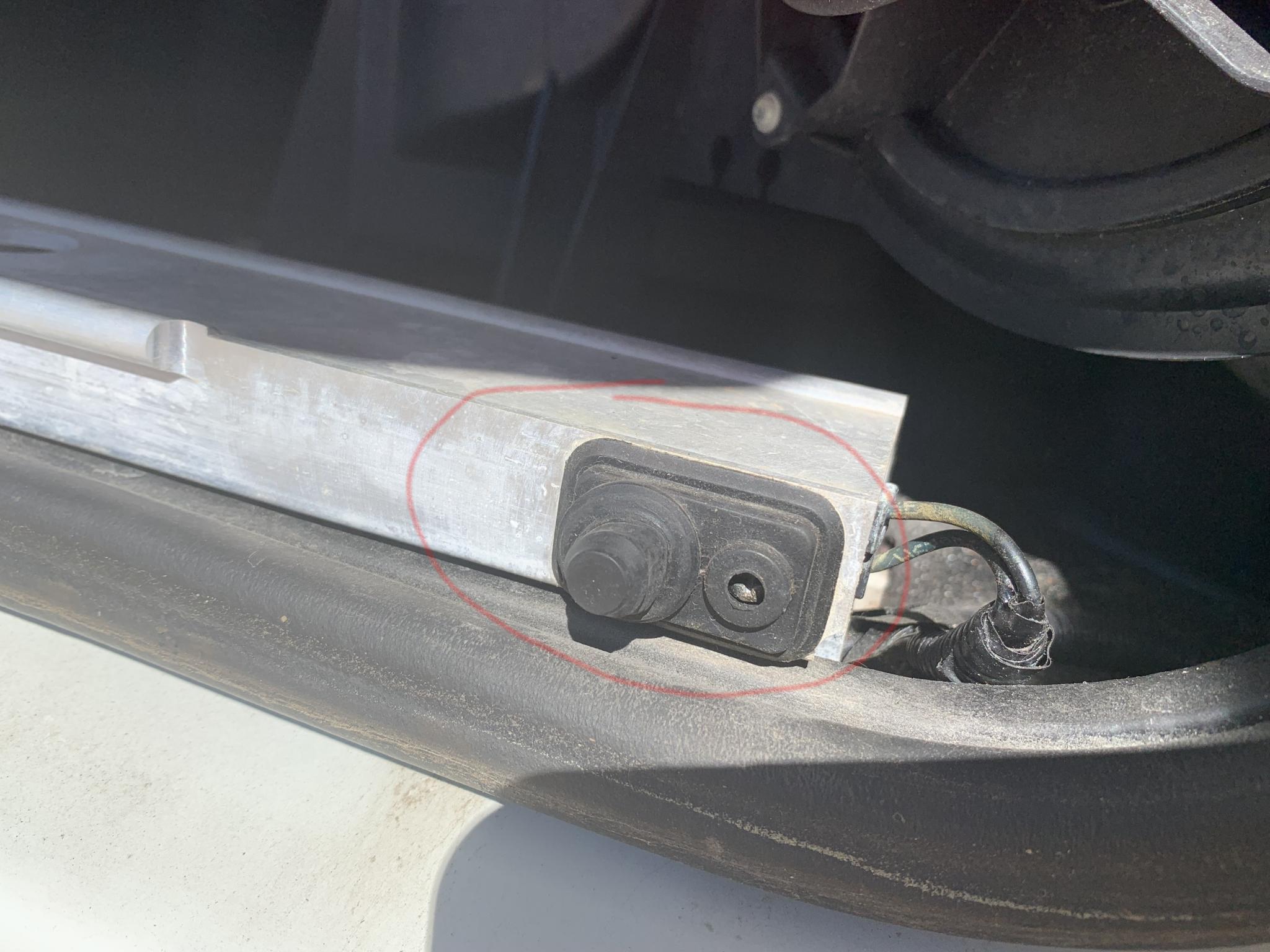

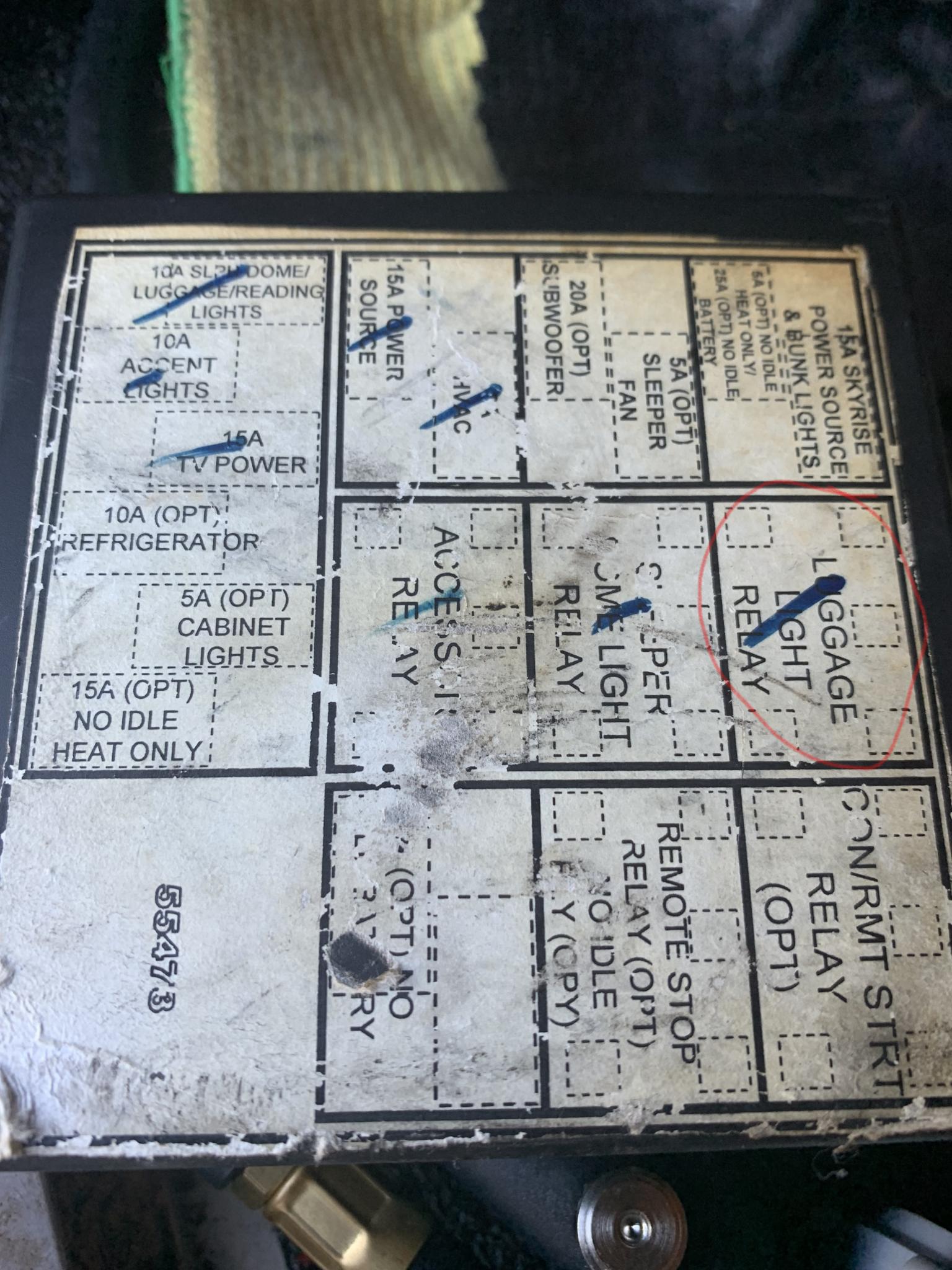

2010 ProStar Luggage Light Issue - vewdew1 - 10-18-2021 Hi guys, Been having some issues recently with the drivers side luggage compartment dome light. It started out that it would work intermittently when I opened the luggage compartment door, and you could hear the relay chattering just to the left inside of the compartment. Then it stopped working completely one day. So, I figured the relay was bad and replaced it. But now it still chatters and dome light still doesn't come on. What else could it be? Maybe replace the door switch? Anybody know the part number of the switch and where I can find one online? [attachment=8127] [attachment=8128] [attachment=8129] Thanks, Danny RE: 2010 ProStar Luggage Light Issue - Rawze - 10-18-2021 start by replacing all the fuses in that sub-pannel with new ones. Could be that one of them is still good but the blades are tarnished and causing gremlins. I see some pretty old fuses in that panel on the pic you posted. same thing at the fuse panel in the cab too. here is a reference for this... http://rawze.com/forums/showthread.php?tid=1514&pid=12861#pid12861 also those side windows are usually to blame.. they like to leak as the truck gets some age on it... ref: http://rawze.com/forums/showthread.php?tid=83&pid=451#pid451 |
