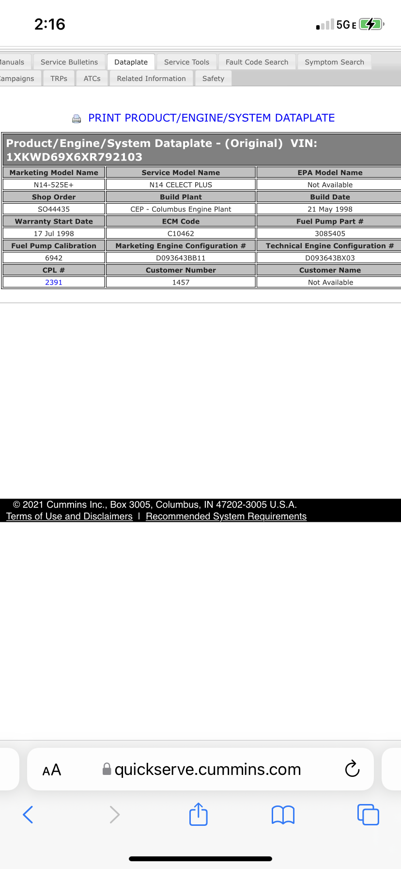

Below is the engine I am rebuilding and trying to find the correct program for it. The ecm came off another motor and I’d like to get it back programmed myself without having Cummins do it since they will like put a “cleaner epa” file on it. Any advice?
RE: N14 celect plus program question - Rawze - 12-04-2021
yeah.. just like the info says.. it takes program 'C10462.xx'.
RE: N14 celect plus program question - Luckyjayb - 12-04-2021
That’s what I figured, just didn’t know the 3 letter code for Calterm for that engine and want to make sure I get the older file.
