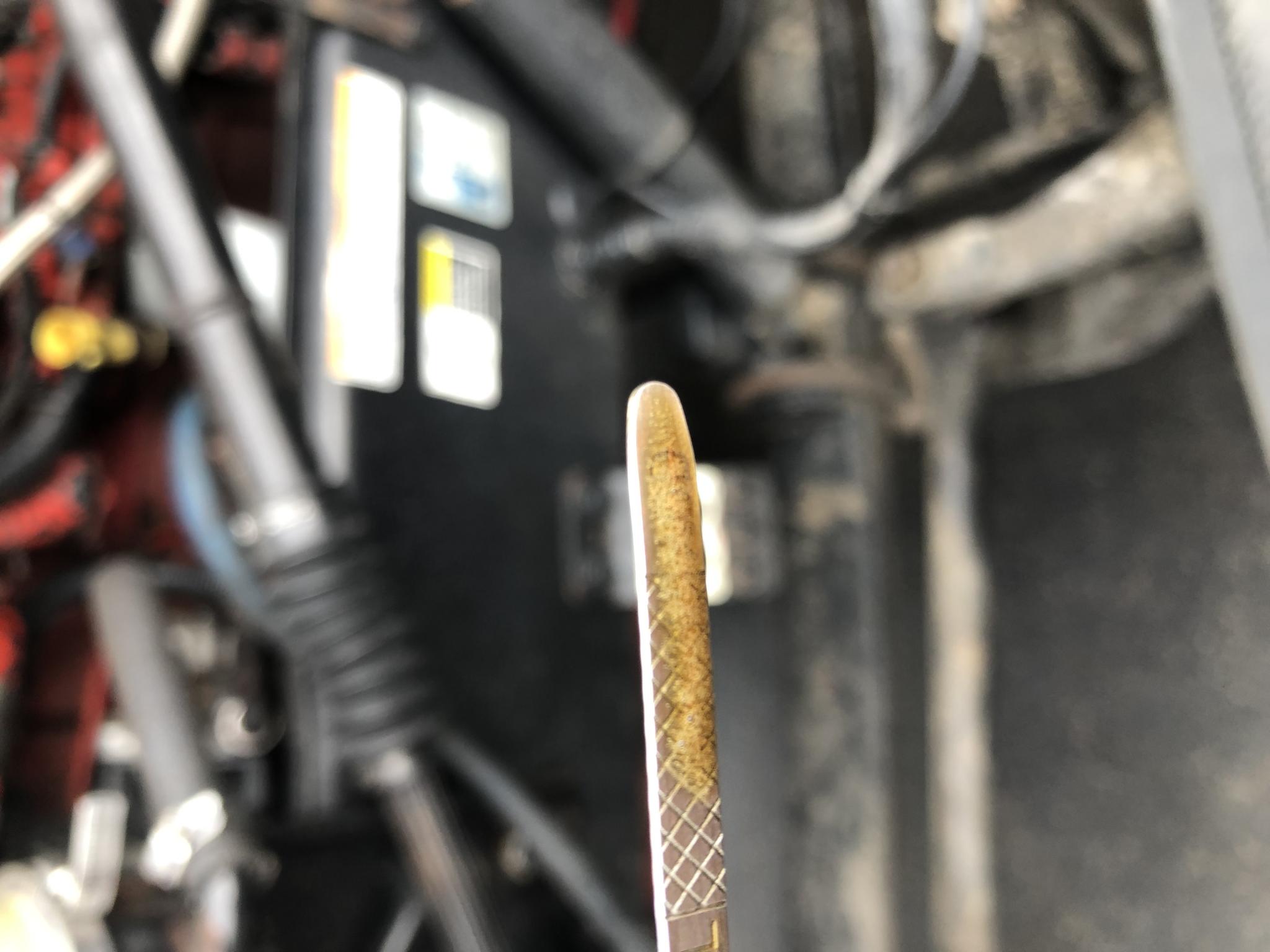

Bubbles on dipstick - Mrkentee - 03-26-2022 [attachment=8339]Can not find any gl-4 gear oil so I used gl-5. After running for a few minutes, shut it down. Waited a little bit and pulled the stick. Found bubbles on it. Anything to be concerned about? Could it have to do with the gl-5 gear oil? Thanks RE: Bubbles on dipstick - Rawze - 03-26-2022 Super-teh gl-5 from walmart has never caused one to have air bubbles in the oil. bubbles in the oil system is a serious concern though. Maybe a leaking o-ring on the pick-up tube for the oil pump?. Maybe air trapped in the system after an oil change>? RE: Bubbles on dipstick - Mrkentee - 03-26-2022 (03-26-2022 )Rawze Wrote: Super-teh gl-5 from walmart has never caused one to have air bubbles in the oil. The oil came from Tractor Supply. The o-ring was replaced about a year ago along with the oil pan. I’ll keep a close eye on it. I should’ve mentioned that I changed the oil the day before, and didn’t start it until the next day, because the battery cables were out. RE: Bubbles on dipstick - Mrkentee - 03-28-2022 After driving it’s fine. |
