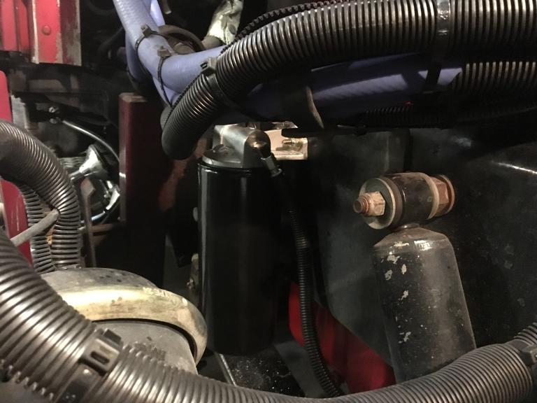

RE: New motor time! - jorden486 - 10-09-2016
By pass filter installed.
By pass

-- I have seen lots and lots of trucks that have had oil pump or oil system failures not even make it the 30 seconds that the ECM allows before seizing up and destroying themselves. Stock tuning or otherwise. I think they screwed up when they did away with the old style of low old oil-pressure kill switches. The old type that you had to hold in while you cranked the truck, I forget what they called them. Makes me want to install one one mine. -- Those old type of switches would kill the engine instantaneously as the oil pressure dropped below a certain point. They were very effective in preventing serious damage.
I have to eat a little crow here-I reread my original post and raze was right, it did not portray the right story. I thought I had put the oil pump failed but I didn't, I DID put it in the text message to unileavers.
Never the less as RAWZE put we are on to constructive conversation! Mainly bypass oil filters. I am worried about the heat deterioting the line more off the oil cooler. I have a commercial crimping machine and can make hydraulic hoses but I'm worried about the heat. I have found a site to order stainless steel line with a teflon liner for 9$ a foot. Also I feel 1/2" or #8 hose is to big and will eventually leak at the fittings due to vibration and to much weight hanging on them. But is #6 or 3/8" enough flow? keep in mind this a stinger car carrier so heat near the turbo is a bigger concern because everything is tighter and in closer quarters.
I'm going to try a cheaper method too. Curious on everyones thoughts on Baldwin B164 bypass filter. I have read its 2 micron at 50%. I have no idea what that means. the base is 45$ and the filter is 9$.
Thoughts?
The above was written some time ago, If I recall the Baldwin B164 is about a one quart size filter. The restriction plate hole is inside the filter at the outlet part of the filter. The Amsoil 120 is about a 1 gallon filter. Amsoil say's the 120 is good for up to 1 year or 120,000 miles? Amsoil also has a universal double filter head that will take 2 bypass filters, the 90's, 100's and 110's. I would think you will only get about 5000 miles from the Baldwin B164? Maybe more I would go with the Amsoil 120 filter. How much is that new engine?
